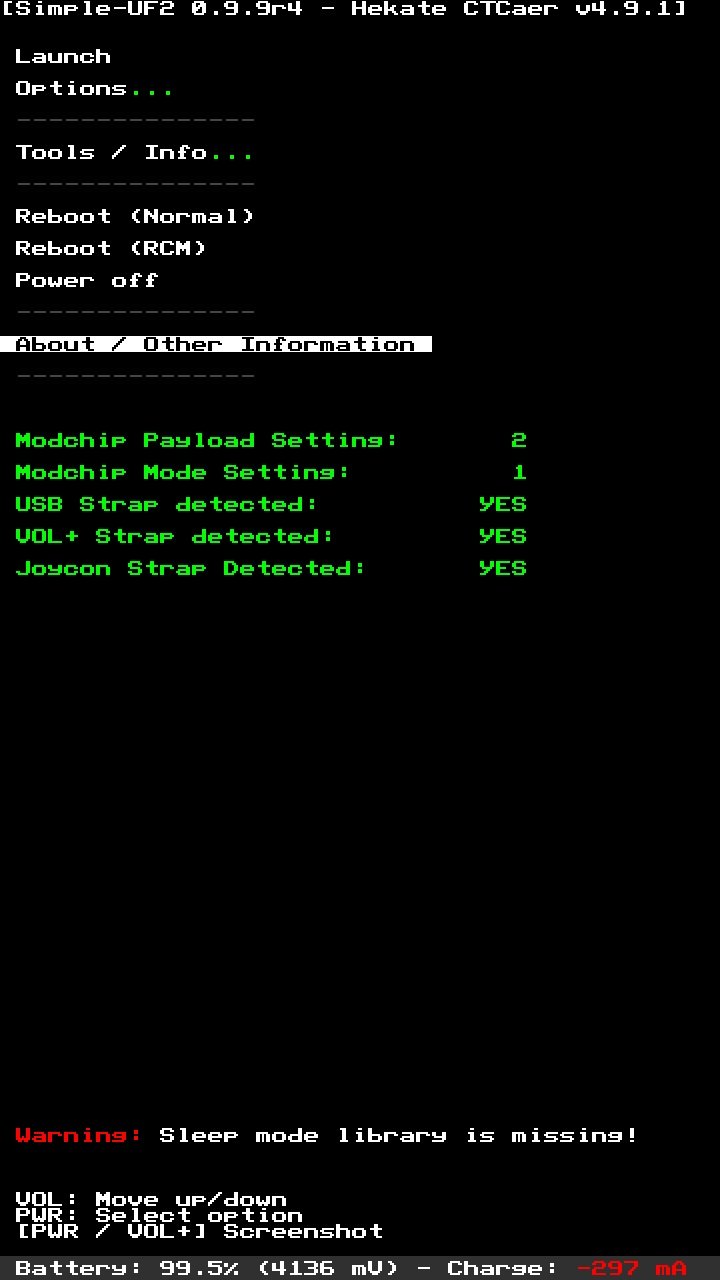

There is a non gui version of hekate on the modchip from whomever installed the modchip for you if you didn't mess up that, you can use that to chainload another version of Hekate or load Fusee-primary to load atmosphere. You press volume down button while powering on the unit to get into the UF2 version of Hekate.

The first thing to try is to put the latest Hekate on the SD card and see if you can load up to that screen of the screenshot I show you, from there you can chainload into another payload like another version of hekate. Perhaps check if your autoRCM is off if the person didn''t do dual boot for you.
