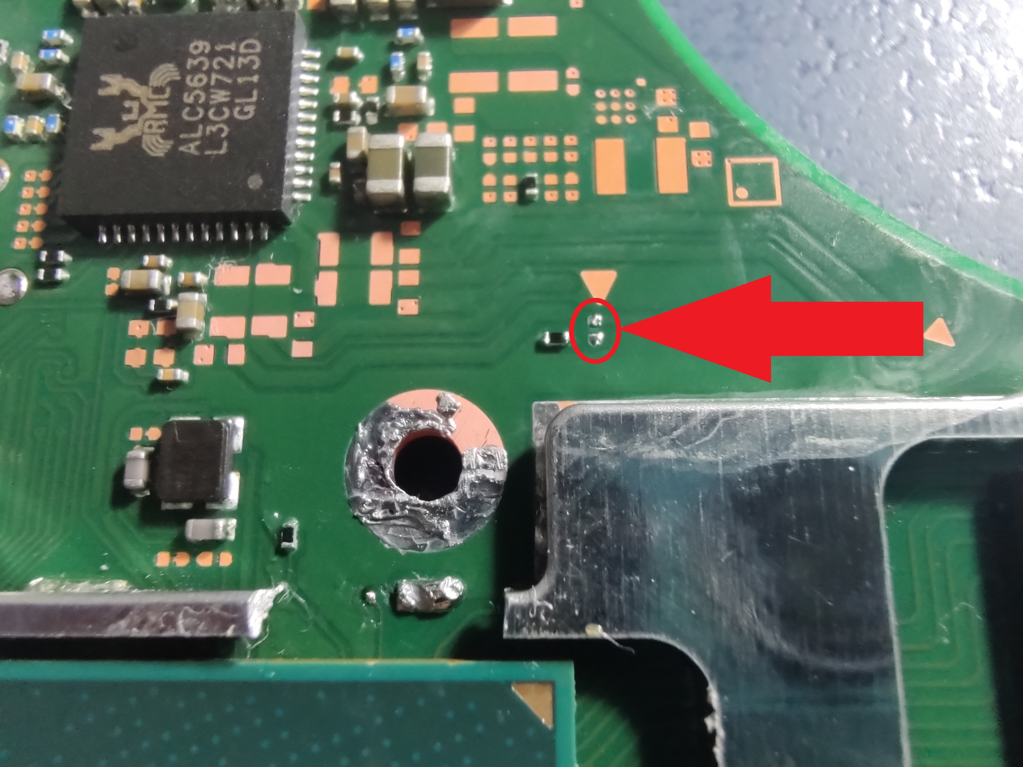

Don't mean to Necro, but thought i'd share this, if you do not have a booklet but have a bunch of donor boards around, these resistors are the same as the resistor on the CMD point,
MB is a HAC-CPU-21

Meanwhile I received another OLED and while I was doing the mod I measured the resistor.
Found a similar value on an old 3DS board and harvested it :P
Thx for the information, though!
Cheers!
your resistor is 3.5k or 4.7k ? i lost one but i dont know which one :(
Cheers!
i saw you said it is 3.5kohm but in the post they said it is 4.7Kohm :( which one is correct :(
The CMD is 4.7k for sure! :)
Cheers!

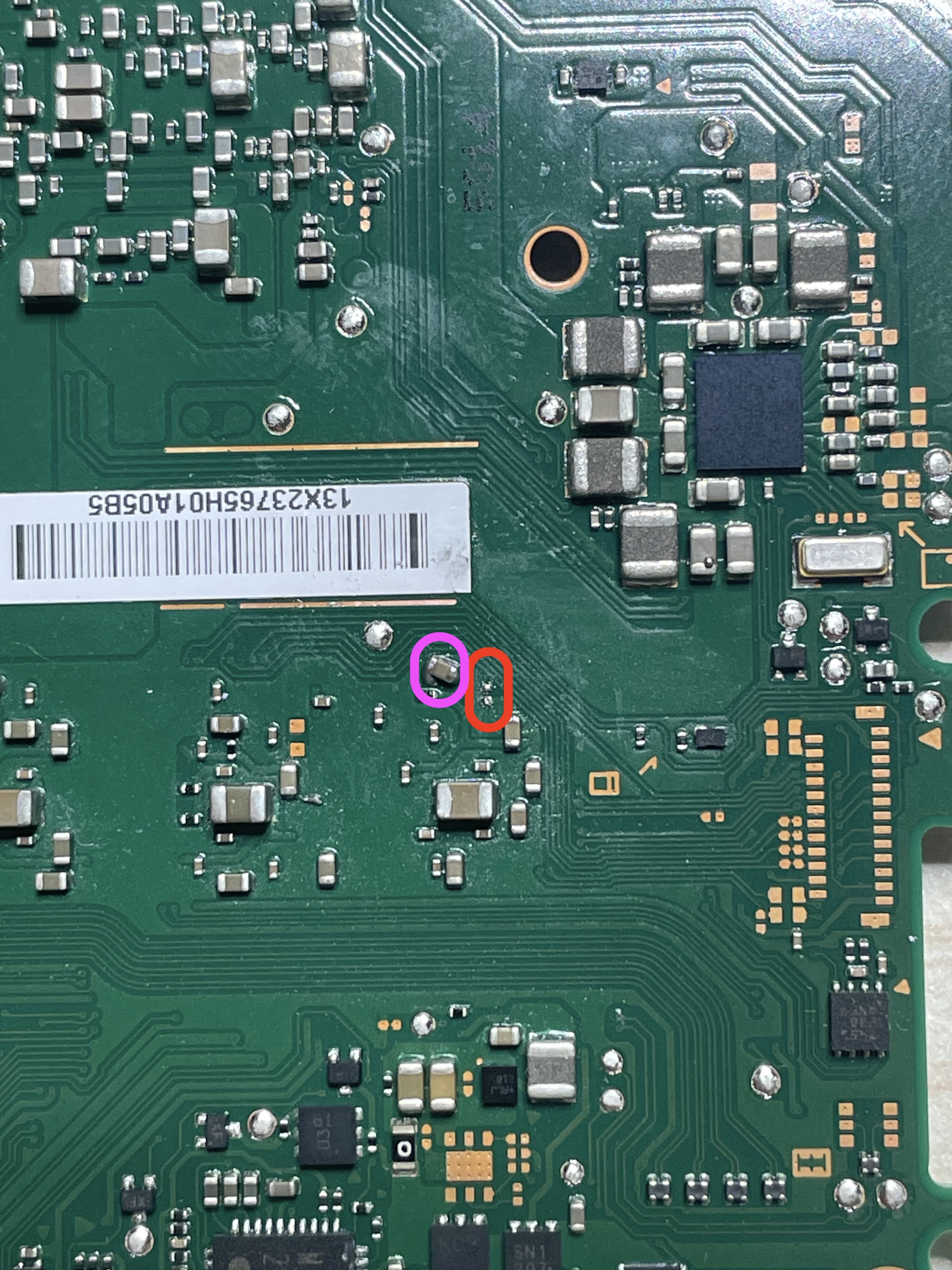

hey guys, i was doing the mod but i got some troubles with the capacitors ..
flipping the motherboard 2 capacitors fell off, one was found but the other one is lost
can you tell me the value of this ? (the red one)
also if you have some suggestions on how i should solder it to the motherboard it would be perfect
THX for the support
THX for the support
i think i found out the capacity of this one should be 0.1nF or 100pF

You sure it is 3.5k? People here are saying 4.5k and I just soldered a 3.5k resistor because of your comment.
I can't remember this...you quoted my post from 2 years ago, lol. But yes, whatever resistor I soldered on worked just fine. Hope you didn't break something else...
Might as well buy the 4.5k and try that too...
I updated my post from 2 years ago adding this:
These people seem certain it's 4.7Kohm.
