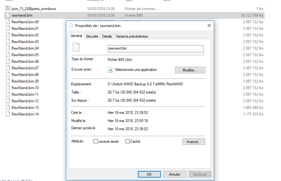

Hi, I did a dump of my 4.0.1 switch nand and the rawNand.bin file (after joining back all 15 spare parts together) appears to be only 30,845,304,832 bytes instead of the 31,268,536,320 bytes that it should normally be... Does that mean there is something wrong with the dump file ?
(When dumping i got 3 errors but only with 1 try each and the dump was done completely)
Thank's
Thank's
Part 13 is wrong. But maybe others also.
You remember what the errors said?
Thank's, nope sorry I just remember that there was 3 of them at the end (95%) with only 1 try, but anyway I did it with your 1st release, will do it again with the new one
