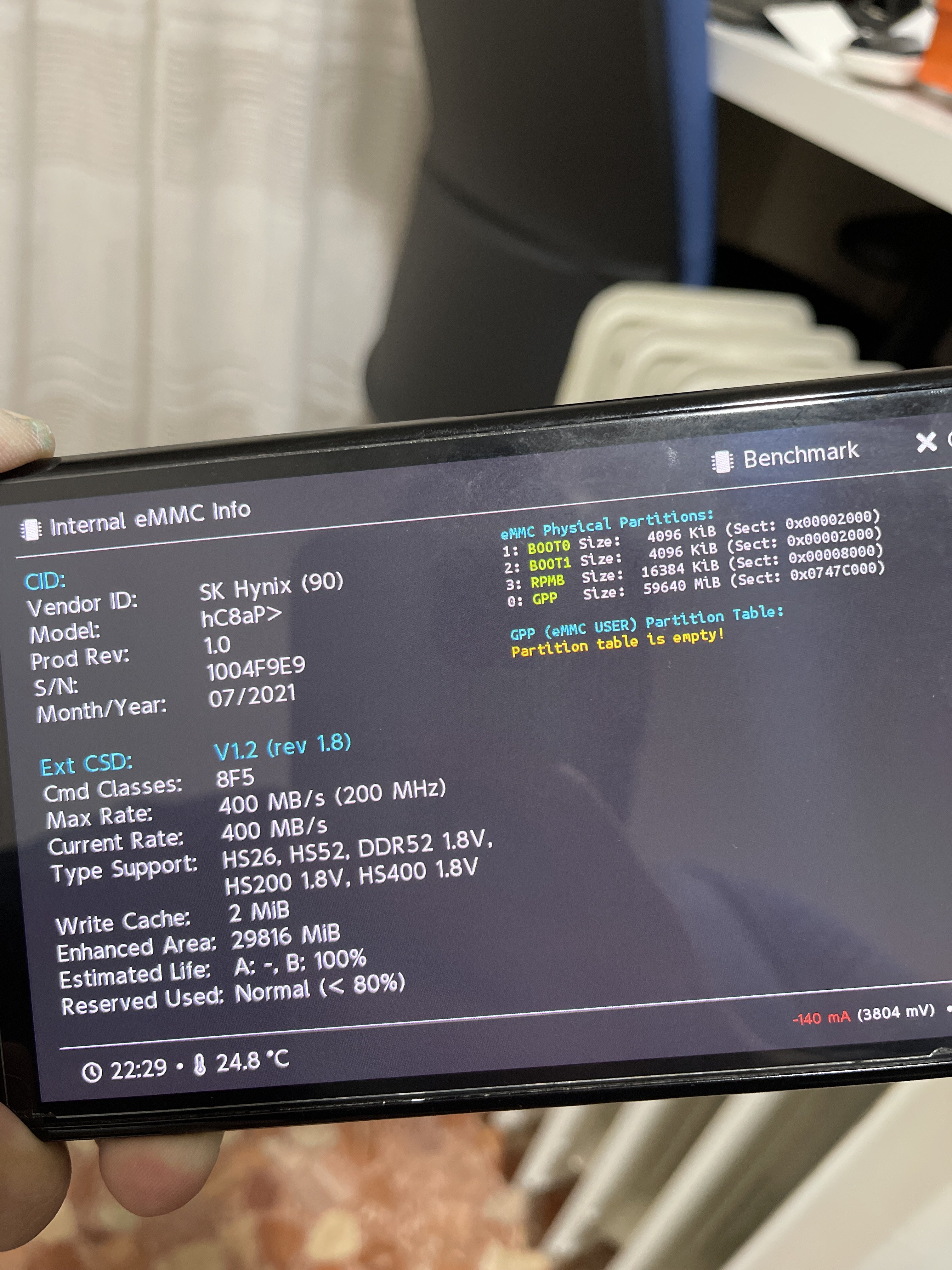

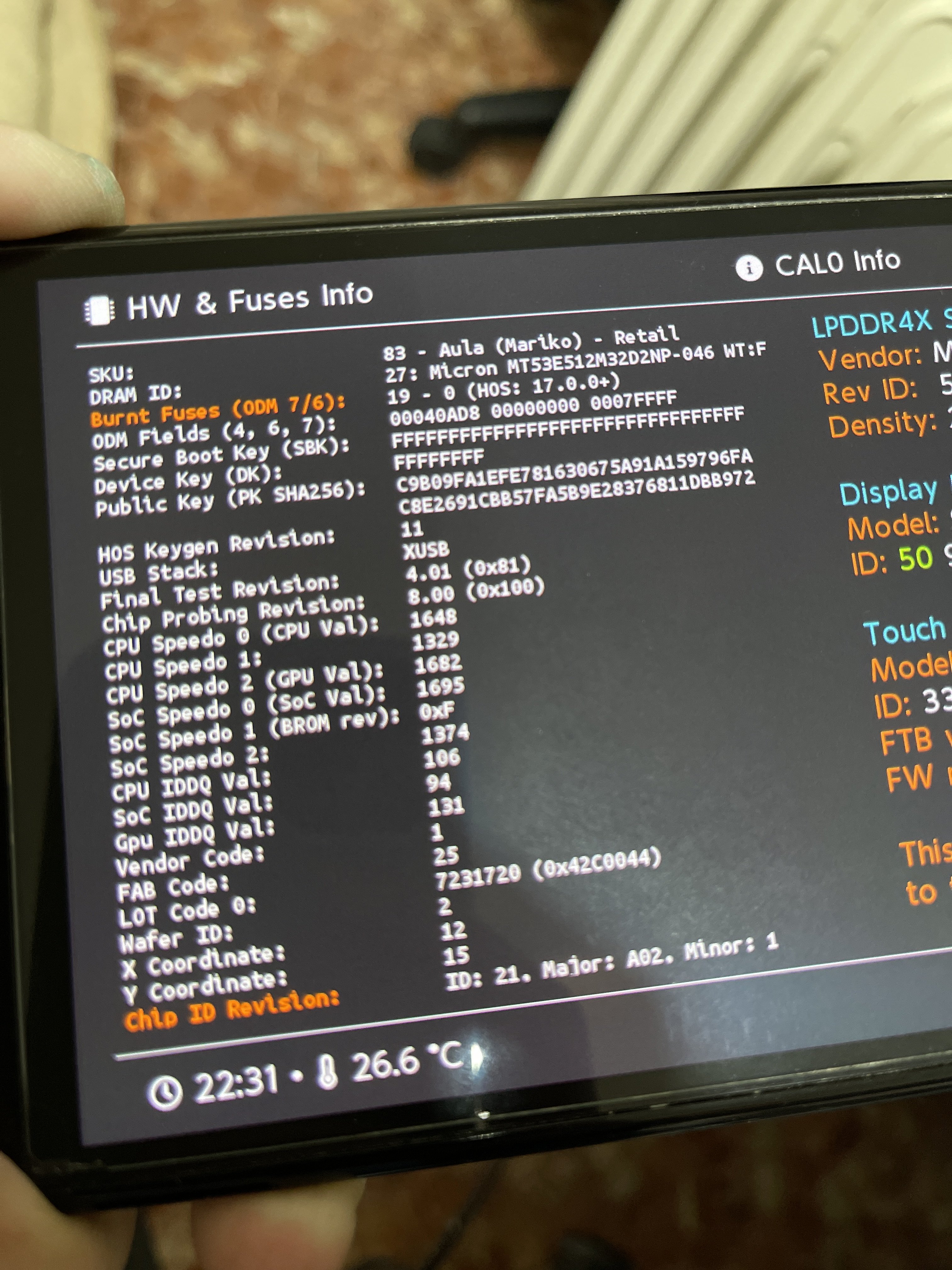

I have done the resistor change, my chip is the called “new oled” in the message that you said to me, but I got purple screen when boot OFC. CFW works fine. I have been reading about it but I can’t solve it. If I go to console info -> eMMC i get the image message.
In HW &Fuses I get the fuses of image.
Any idea?
Thanks!!!
Any idea?
Thanks!!!
Your emmc is corrupt, if you have the complete backup and all the keys you could restore the emmc
Any idea?
Thanks!!!
You can mount your emuMMC to dump your prodinfo or just use tegra explorer, from there you can start rebuilding your sysNAND

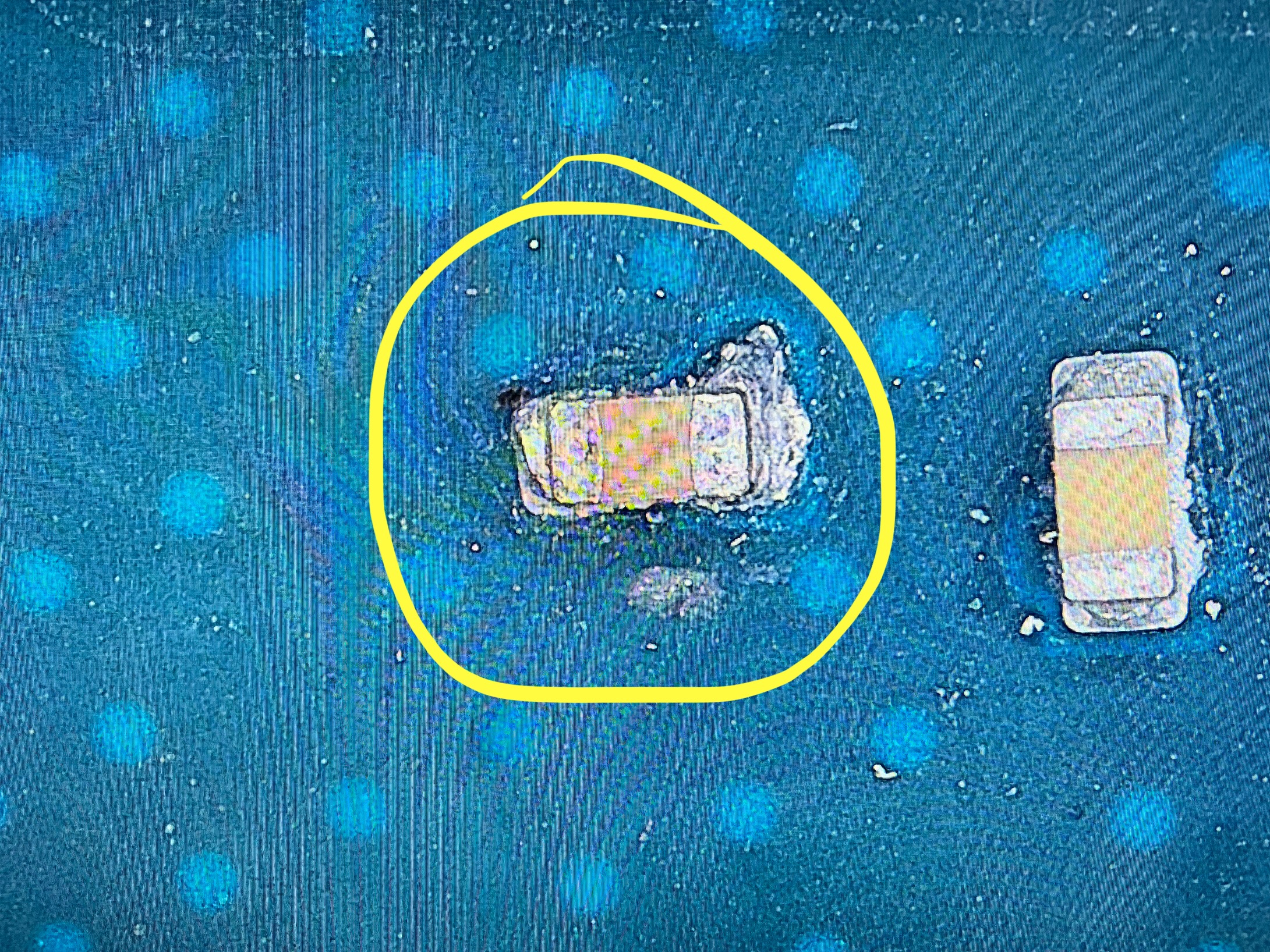

You can test the resistor while still on the board with a multimeter. Only change if it reads out of spec.

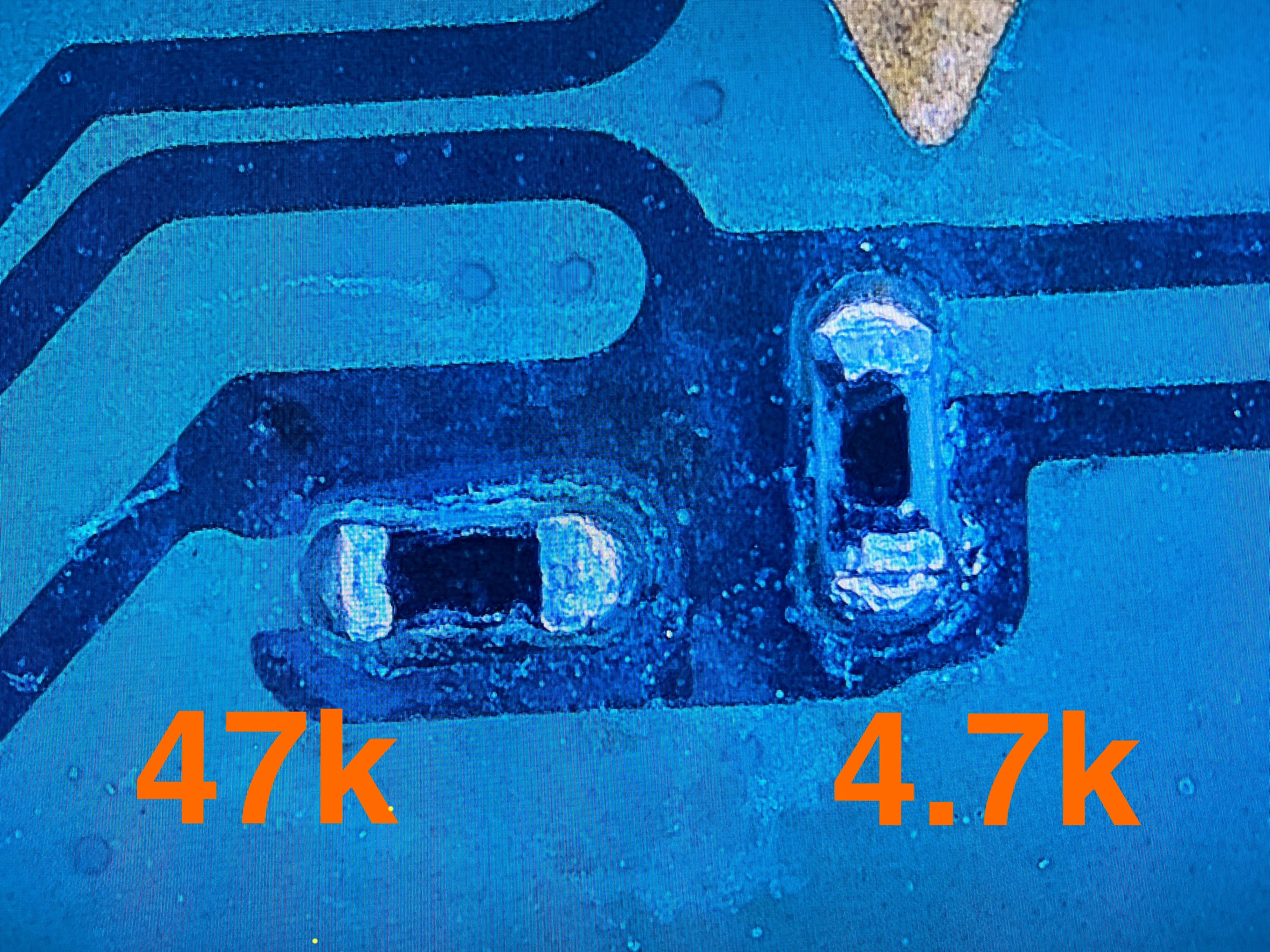

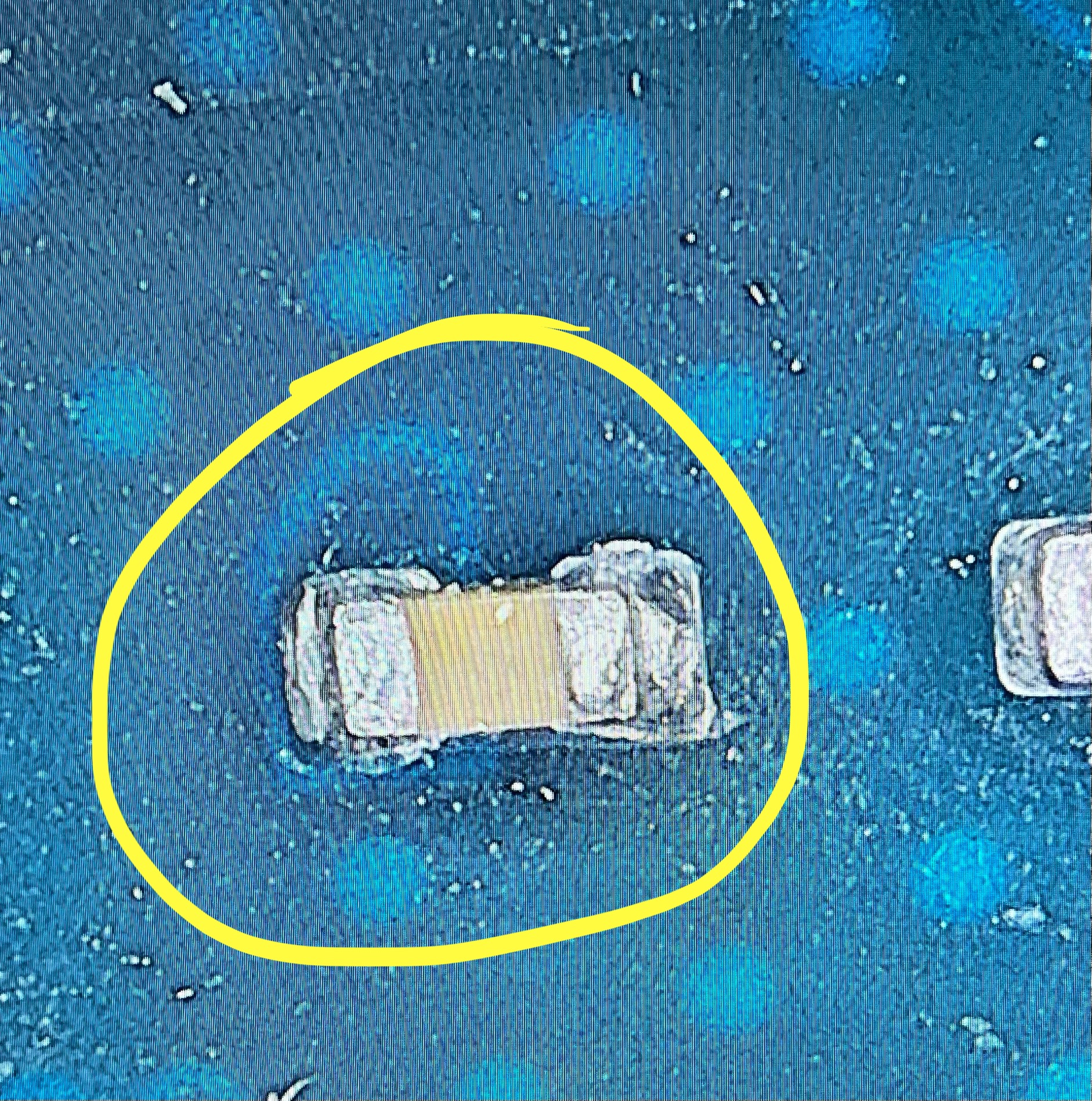

So if it can help guys I can confirm that purple screen after a modchip install is (for my case) the cmd line, I can confirm too because I fuckedb up one side of the resistor, but thanks god not the trace, at first I not seen it but the weird lecture of the multimeter made me to change it , I had some weird measure, so it made me change the resistor and everything is ok now ...so i not saying it the absolute true, but yeah my purple screen was due to bad cmd resistor command....
I changed the resistor of 4,7khom , and everything is alllright now
ps: you have to be very relaxed lol, it's 201 size resistors, have tiny pencil tooo
so , not everybody can do this, be carefull, I have experience in modding etc but really, nintendo switch is The thing ^^ , if you not have a microscope you are fucked up ^^

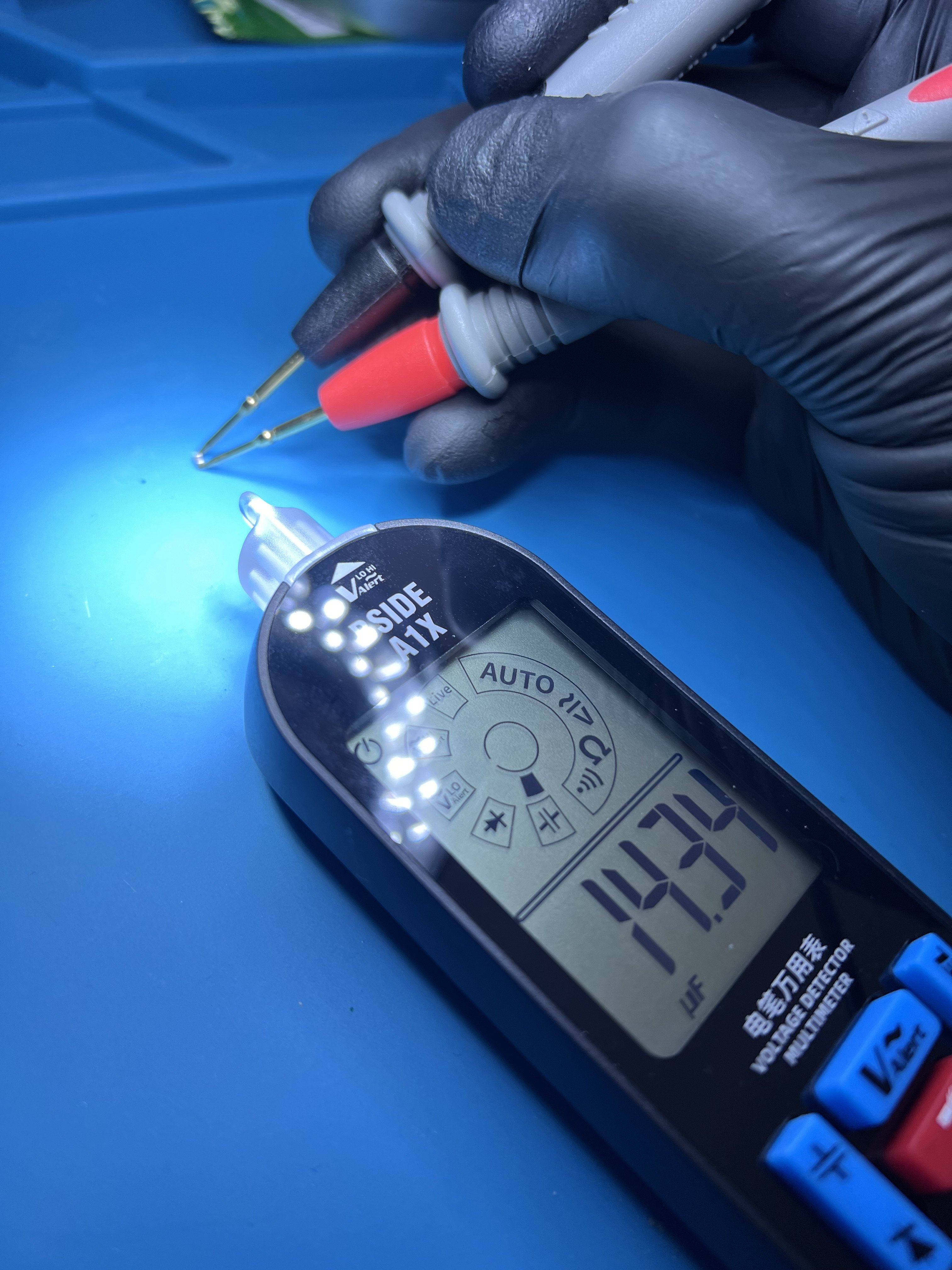

I'm having a pink screen issue as well. I can boot to hekate, but I get the EMMC init failures, and when trying to boot OFW I get the pink screen.
I am thinking it is the 4.7k resistor that somehow got burned while soldering. I tried testing the A point with the diode mode on the multimeter and I get around 0.45 (not 0.55-0.8 like others said). Is it likely to be a broken resistor? Is there anything else I can check? I tried testing the resistance on it with a multimeter and I'm not getting the right readings (that said my multimeter is quite large and it's hard to get accurate readings on such a small component).
