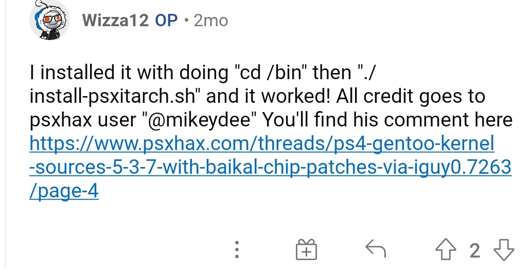

Found this Reddit thread and it worked! Apparently it was mounted all that time in /bin already. I did try some mounting first so it might, or might not work directly.
try "fdisk -l" to see disks and partitions, find partition where you have psxitarch file then "mount /dev/sdXX /newroot" where XX is disk number and partition number, and then "resume-boot" or "exec switch_root /newroot /newroot/sbin/init"
if you dont know where is psxitarch you can try
mkdir letsee
mount /dev/sda1 letsee
ls letsee/
if file is not shown there
umount /dev/sda1
mount/dev/sda2 letsee
ls letsee/
and so on, if not sda try sdb, sdc, etc..

Make sure to follow these steps carefully to make it work
1. Start payload and get to rescue shell.
Now you can get off usb (which has got bzImage and Initramfs)
2. Plug in usb with linux installed
3. Plug in keyboard and find your usb by typing fdisk -l (it can be /dev/sdb1 (depending on yous)
After finding usb type:
mount /dev/sdb1 /newroot (make sure to give some space from sdb1 with /newroot)
then : install-psxitarch.sh
and boom !, it fixed mine
I SOLVED THE PROBLEM !!
