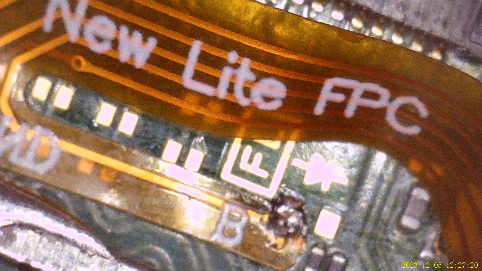

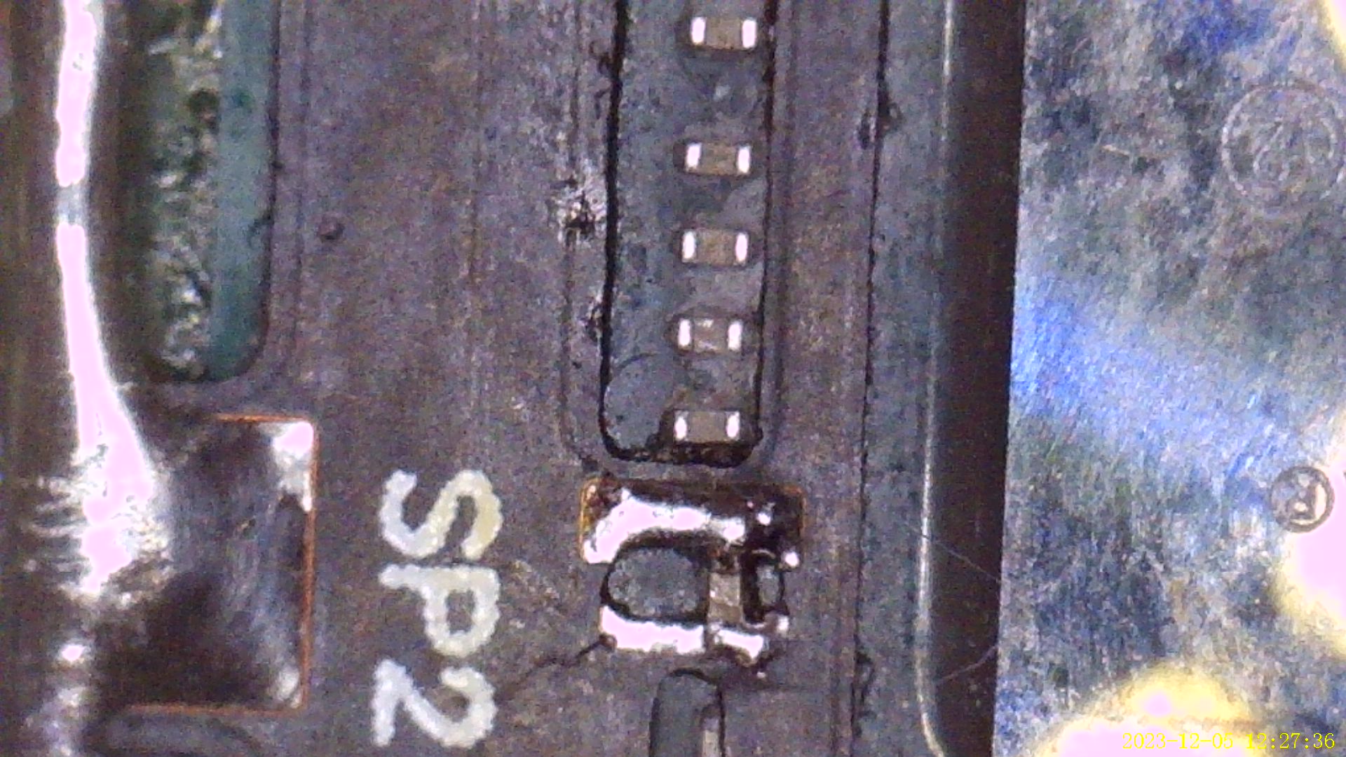

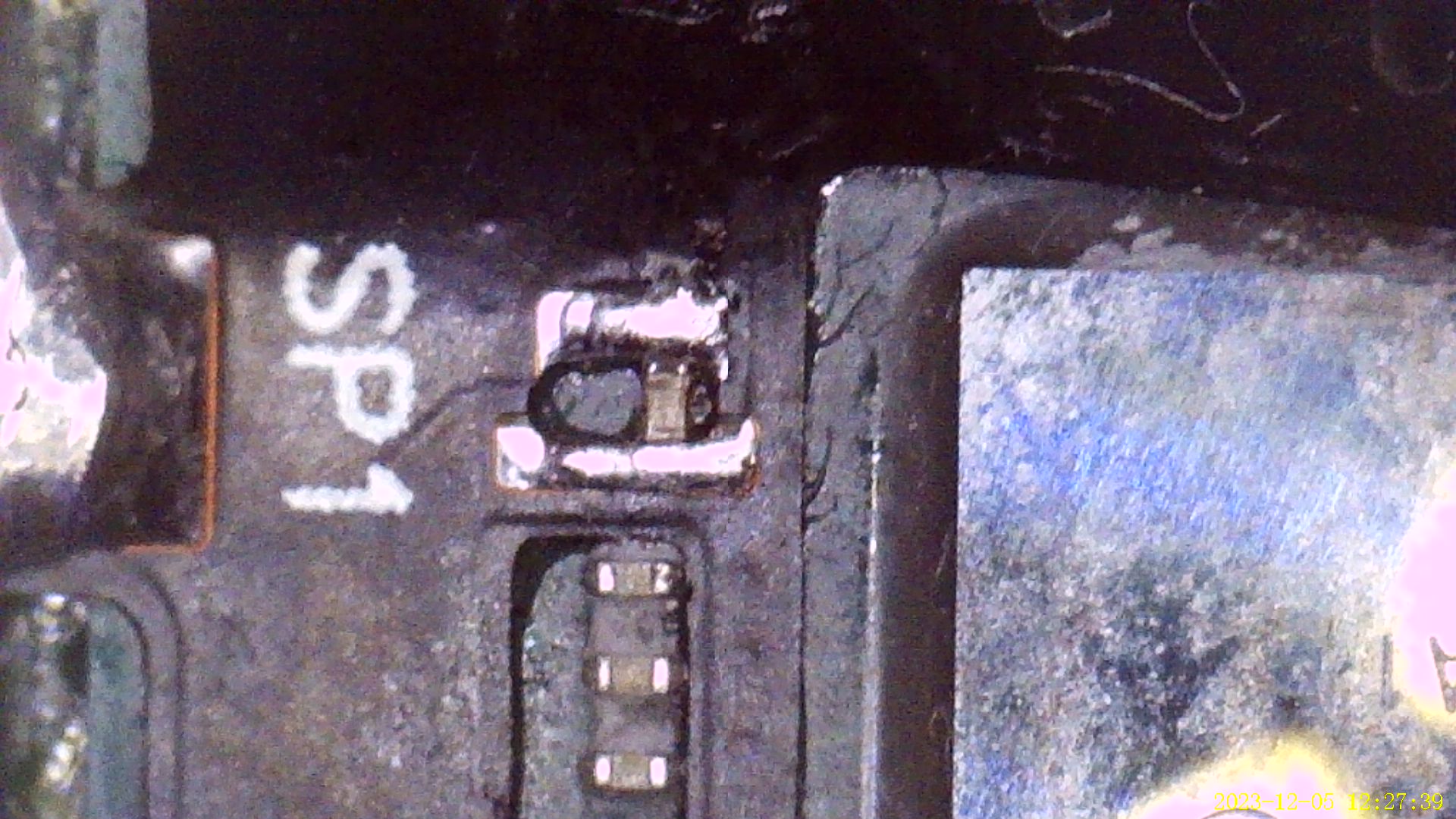

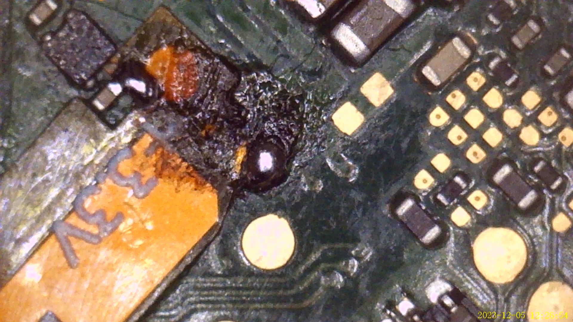

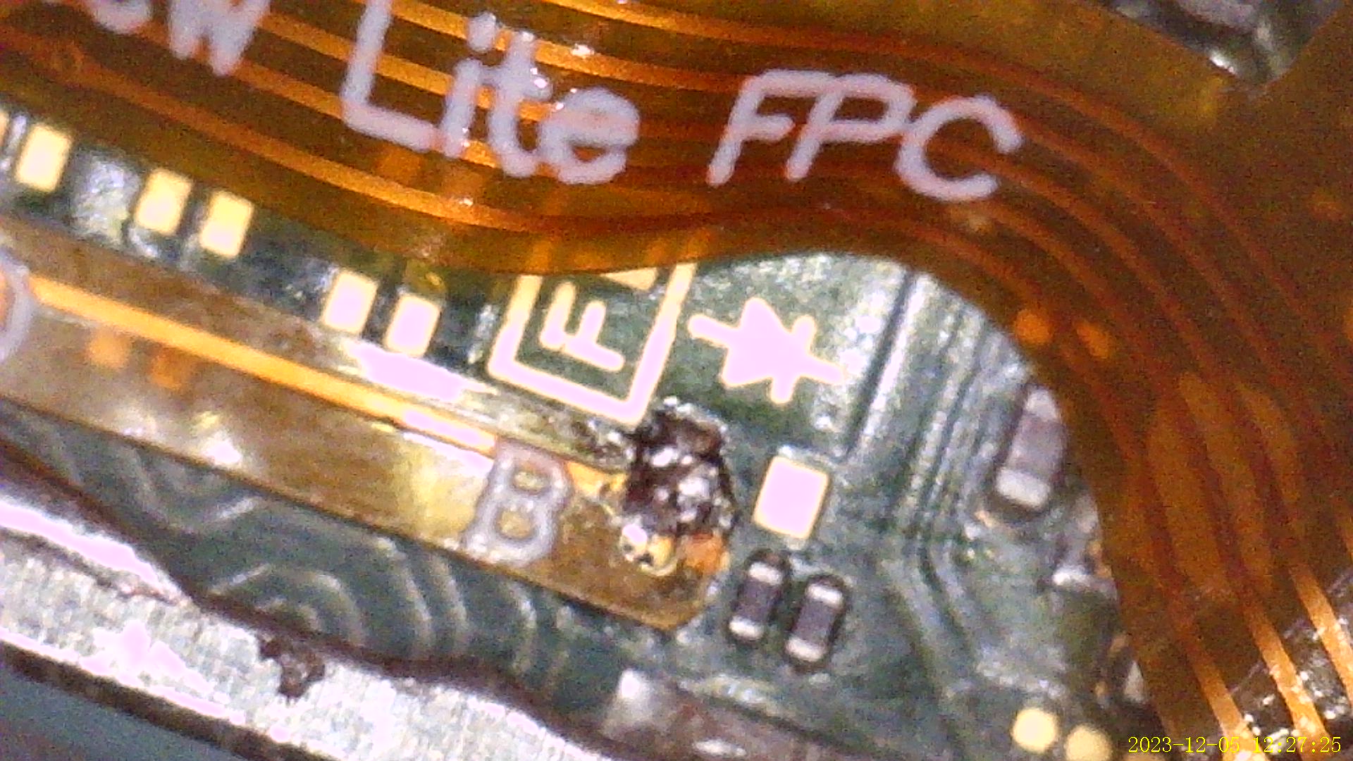

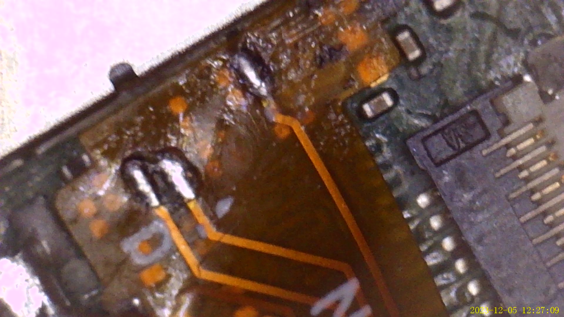

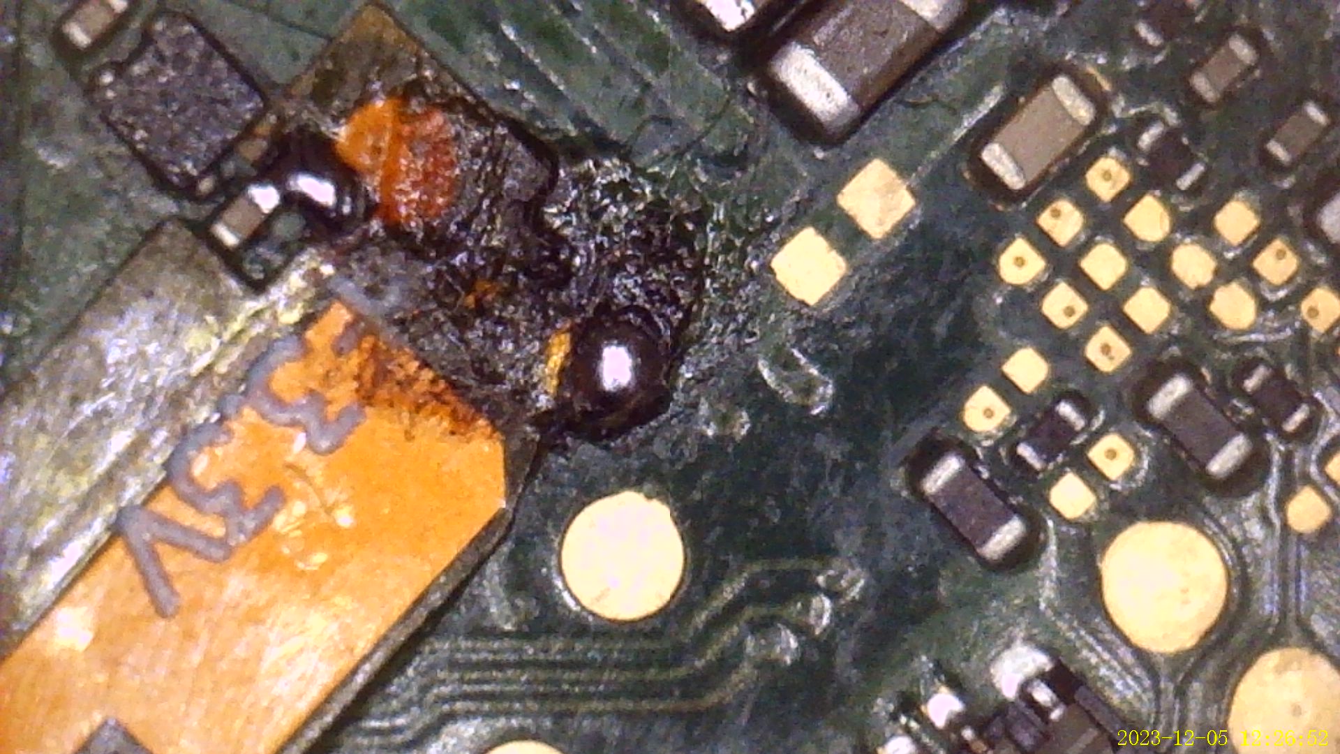

I have the impression that they are good. see photo sorry for the quality. is it possible to leave the flex cable to try to start without a chip or I have to desolder?
Hassal
Apr 22, 2023
561
24
510
United Arab Emirates
It's likely your eMMC isn't properly seated. Return the daughterboard to the original socket and see if your system boots. If it does boot normally then you should know where the problem lies, either from the modchip itself or your SD card.

I was thinking of doing that. But the flex cable does not pose a problem, no need to unsolder it?
I found the problem the console is dead. when I put the chip in the flex cable it pulled on one of the processor resistors and it was broken.... Thank you for your help
Hassal
Apr 22, 2023
561
24
510
Missing caps on SoC will not prevent your system from booting. It seems you just used too much heat while ripping the flex. The presence of the flex will not cause any harm to your system.
