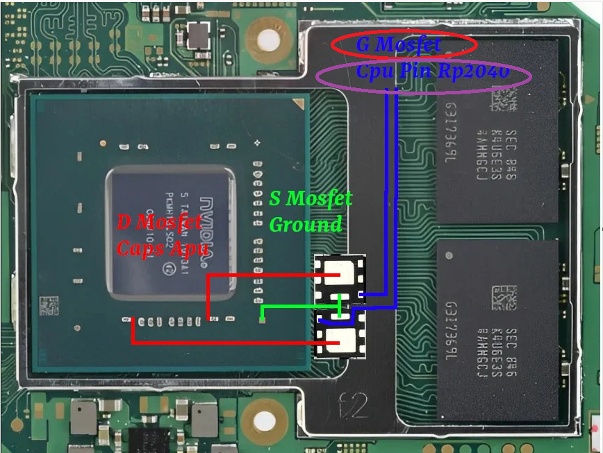

Looking for some guidance. Switch Lite - have marked the 2 things I am unsure on in red/purple 'circles'
Where does the 'G Mosfet' connection go to? and the same for the 'CPU pin on rp2040?
Has anyone got a better diagram like sthetix diagrams on github??????????

g is gate. They goto the rp2040

It goes to the pin 15 on rp2040 zero
