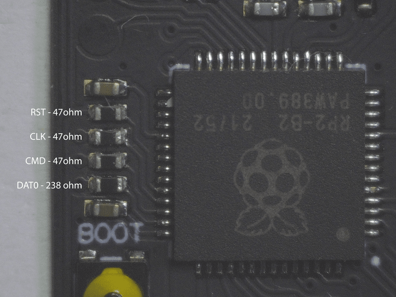

Does anybody know, if my Picofly Board has the right resistors on it? Espacially CMD and DAT0? Would be also nice to know, which these are😅
You will have a multimeter, right? Why is everyone asking for simple crap here?
Such chips usually always have 47 ohms. You can try it out first to see if everything works. I haven't had any problems with this with a V1. From V2 to OLED I generally do 100/100/47 ohms.
Yes I have a multimeter and I will check the values.
However I was asking, which one of these are the CMD and DAT0 resistor. It's not written/marked on the board.
Anyway I guess I know now, which resistors I have to change. I already ordered the required 0402 SMD resistors (100Ohm)
EDIT:
I just checked the resistor values and they are indeed as follows:
b = 50 Ohm
d = 50 Ohm
a = 50 Ohm
c = 240 Ohm
So should I just start with replacing c with 100 Ohm or should I directly exchange a and
EDIT:
b = 50 Ohm
d = 50 Ohm
a = 50 Ohm
c = 240 Ohm
Replace a and c with 100ohm. Remove b and bridge the points. Done👍

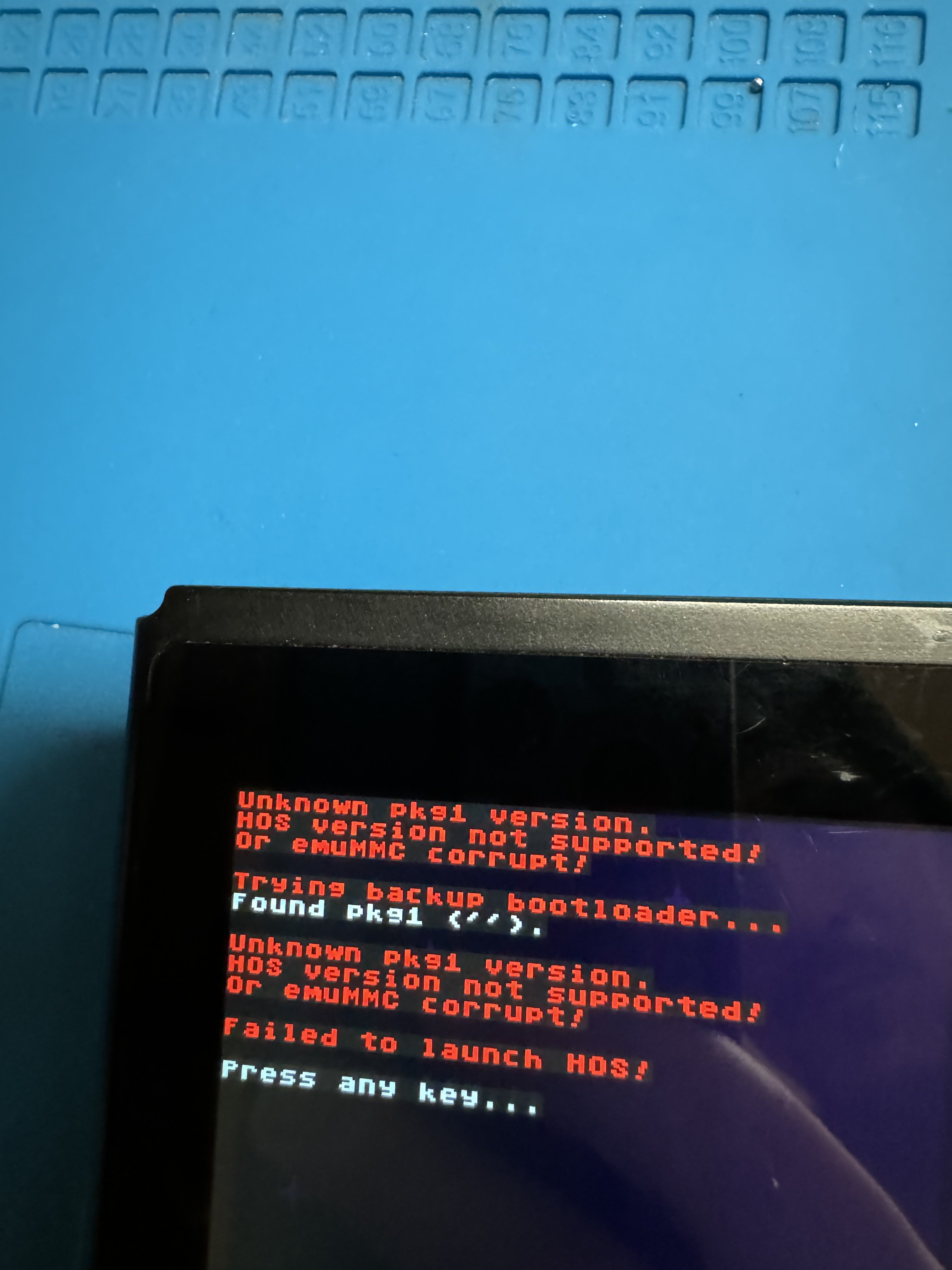

Hi guys, been doing picofly mod since a year but i got a weird issue with one and im looking for a fix or something to try. The console its a patched v1 that got parental control code forgotten. The console at the begininng booted fine, the fw was 16.0 so I decided to’ update to the latest 17.0.1 before installing the mod, and everything went fine. Installed the mod and atmo as always and Emmc running in slow mode appear, so I tought I have to recheck the soldering, maybe add resistors or checking the sd card fpc connector or the reader. Before doing those checks , i started atmosphere and i was not able to, it popout an error (picture attached). Then i try the ofw and after the Nintendo logo just black screen. I removed all the mod and cleaned the board, but the issue still persist, Nintendo logo then black screen. Started looking for any short on the board (m92, max chips, p13) but none found. Reflowed but not reballed the nand and the Wi-Fi chip but no changes, swapped battery no changes at all. And now im kinda stuck here, got spares boards and everything but im not sure what to do next. I hope to find a solutions by writing here, thanks!
have you check the cmd resistor on the switch mainboard?
its usually broke mysteriously and lead to those blackscreen or bluescreen.
psycho-neon
Nov 12, 2023
135
328
Philippines
Install back the mod chip, make resistance of dat0 and cmd to 100ohm, then boot to sysnand cfw once.
