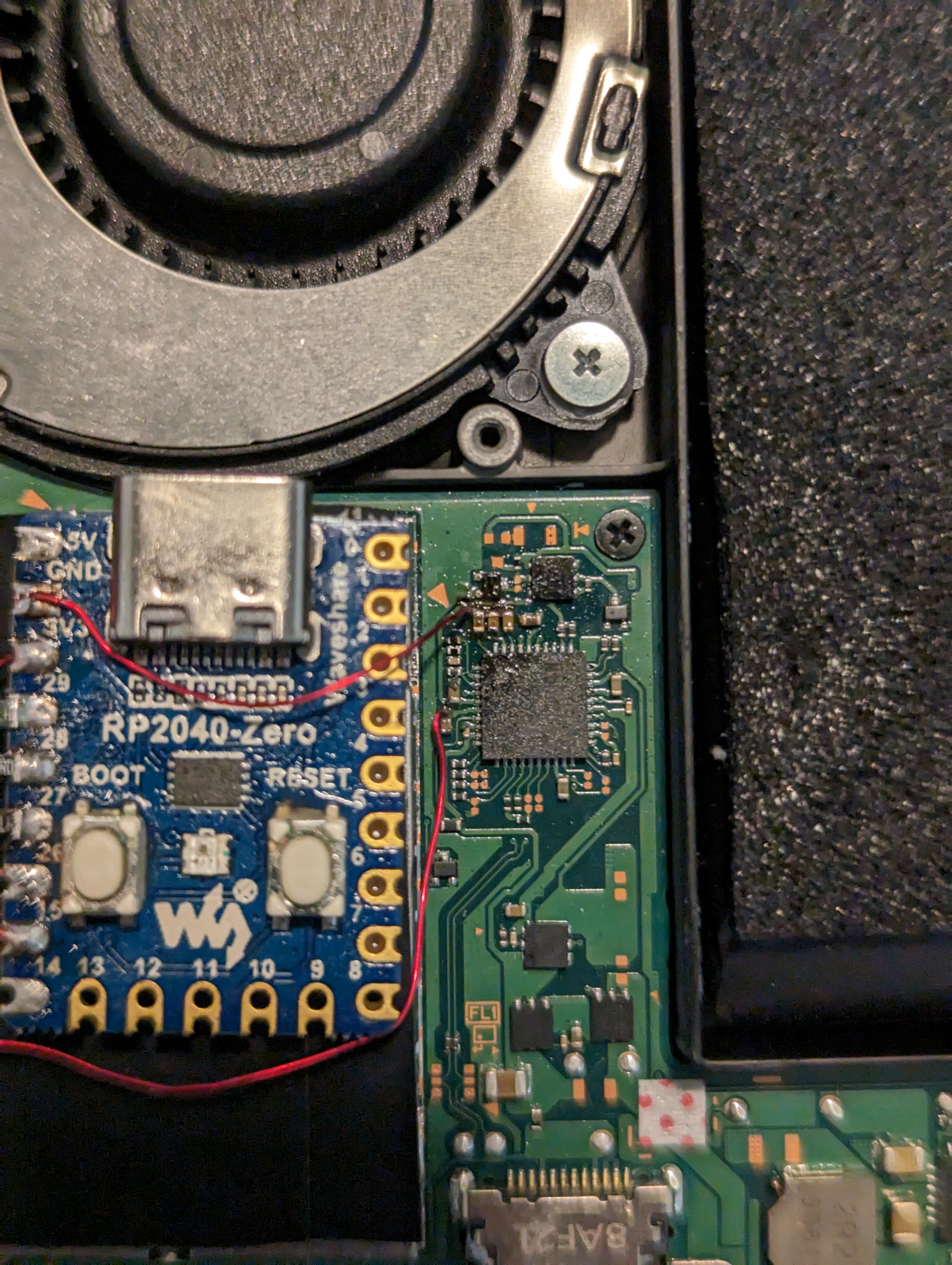

Having far too much trouble getting picofly to work on this patched erista switch. I have tried several cards (PNY, Samsung, SanDisk), of several capacities, 64-256 GB, with multiple sd card readers. I have tried both and actual rpi 2040 soldered, and an aliexpress picofly on a flex PCB. no matter which combination of the above I try, it glitches successfully, but I get 'unable to in it SDcard.' All I could find on this was 'Use a Samsung SD' That doesn't seem to work.
If you're drawing 3.3v power from the SD card slot, you are inhibiting the system from initializing the SD reader by drawing power away from the SD card and using it to power the rp2040. Where are you getting voltage from? Send pics

3.3 and ground are coming from caps near the charging controller, at least on the rp2040 install. The hwfly-like picofly board I was originally trying to get working pulls from the emmc connector. Same spots I'm pulling from on my trinket install in my unpatched switch... I only swapped in one of my regular 2040s while trying to troubleshoot the purpose-made board. Same symptom on both. And both the SDcard and reader work perfectly fine in my unpatched switch, as well as in OFW on the patched switch I'm trying to mod.
Take a few more high quality photos of the rest of your install please. Also, make sure to clean up any flux when you're testing, because certain fluxes can be mildly conductive and introduce more random issues to your install.
