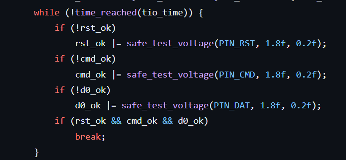

Hi @abal1000x ,
I've found an OLED which sometimes can glitch and sometimes cannot .. using an DAT0 adapter.. Continuity is good, but still throws dat0 error code.
Just want to know your opinion regarding bellow voltages and ranges test. Can we check it directly on the switch unit to know this specific unit values ? also how safe it will be if we modify these values in the firmware.

Hi @abal1000x ,
From datasheet:
Dat0 works on push-pull mode, means,
When theres no signal (high level) it should be between Voh to Vdd.
Theres two table i assume the emmc could use 2 mode of voltage.
Vccq = Vdd = 1.70 ~ 1.95
Table 30:
Vdat0 = 0.75Vdd ~ Vdd
= 1.275 ~ 1.95
Table 31:
Vdat0 = Vccq - 0.45 ~ Vdd
= 1.25 ~ 1.95
So based on the datasheet it should be around 1.25V to 1.95V.
Or using the code style it should be 1.6V +- 0,35V
You can, when its powered on. Its pulled up, so the low bit is high voltage.
Its safe if you know what you're doing.
Those fault detection is for safety.
For example if the dat0 is in the wrong voltage, then theres something wrong with the installation.
What if you switch the dat0 with the 3.3v for example.
Hi @abal1000x ,
Logically speaking, the glitch is not affected directly by the dat0.
I assume,
The dat0 line is needed to inject (write) the loader to the emmc (the whitelight in the first time powered on).
And checked (read) that the loader is indeed in the emmc, everytime picofly powered on.
So if the 'white light on first installation' workings then the dat0 line is working.
But indeed the glitch operation use the CMD line to compare data, to check whether the glitch works or not. Or to get the time reference of when the glitch will be executed. So the CMD line is very important on the glitch (Also the CLK line to sync the signal).
But remember that CMD/CLK/Dat0 is in one package of emmc. So it doesn't remove the possibility that wrongdoing in Dat0 might interfere the CMD line. For the its illogical, and have a lesser probability.
If glitch problematic, the number one suspect is mosfet and the gate line, second is the cmd/clk line.
