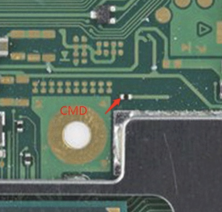

Hello, is it ok or any effect if I solder the CMD point to the left side of this resistor and the 3.3V point as shown on switch lite?
