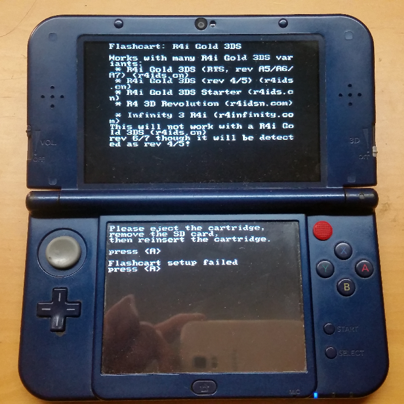

I'm using an R4i SDHC 3DS RTS to flash NTRboot onto my flashcart - not even install it into the New 2DS yet. I have used the same flashcart in the past to install it on a New 3DS using the same methods. The only things that are different between then and now are the software versions of the 3DS/2DS and the versions of the flasher.
It works fine, I can play all the games and head into the .nds file for the flasher. However, in attempting to pick what flashcart type I have, it says "flashcart setup failed". No matter which one I pick.

From the Flashing ntrboot (3DS Single System), are you using the official ntrboot_flasher_nds.nds v5.1.1 from (jason0597) ntrboot_flasher_nds?
That error message sounds like you're user the older ds_ntrboot_flash.nds v4.0 by (ntrteam) ntrboot_flasher_nds.

I've been using Jason's version. I'll try again to make sure, but I don't think that's the problem. I'll edit with results in like ten minutes.
EDIT: Still failed. I recognize the latter version though, that's the one I used before. Gimme a bit to try that one.
EDIT2: The latter one is working for some reason. It's mid-writing. Using the SDHC option gave an error as well, but on a hunch I tried the others; R4i Gold worked. I'll give results after.
EDIT3: I'm confused. It's saying the writing is done, but then it goes back to the flasher menu where it tells you that you can either inject, restore, or change cartridge. If I go home, the flashcart still shows up on the home menu, and inputting my microSD lets it work as normal. Any ideas?

Try the 3DS Multi System if you have a hacked 3DS that can launch the ntrboot_flasher.firm v0.5.0 from (ntrteam) ntrboot_flasher.
Don't forget to add to the 3DS system's SD card, sdmc:/ntrboot/boot9strap_ntr.firm v1.3 , from (SciresM) boot9strap.

Alright, it worked. Used the same bootstrap firm, so it's not that. (Also had to use r4i Gold, for some reason SDHC said it wasn't supported. I know it worked because it disappeared from the home menu.)
But now I'm wondering why single-system didn't work, AND why it's saying it's a Gold instead of an SDHC. Thanks though!
