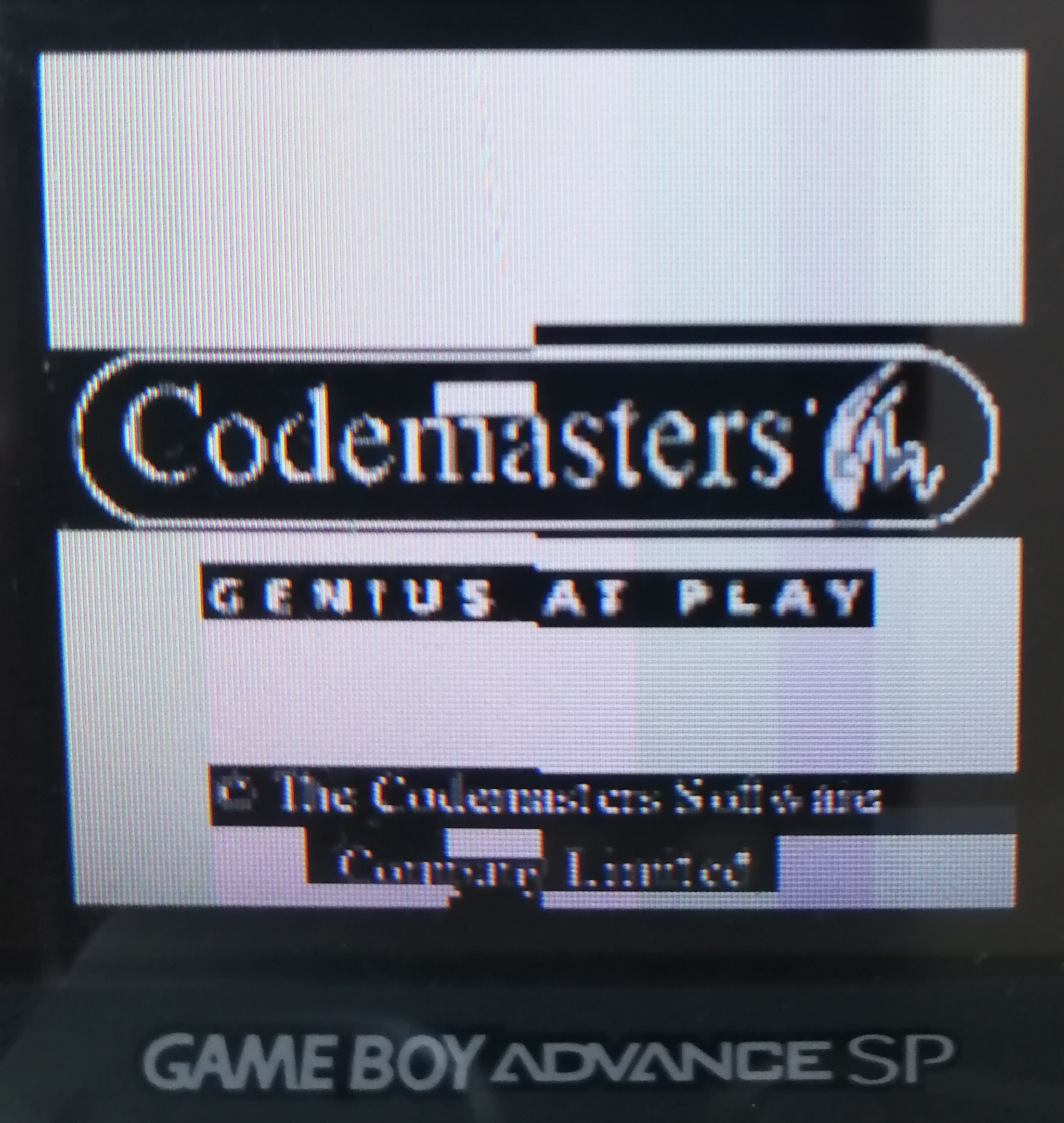

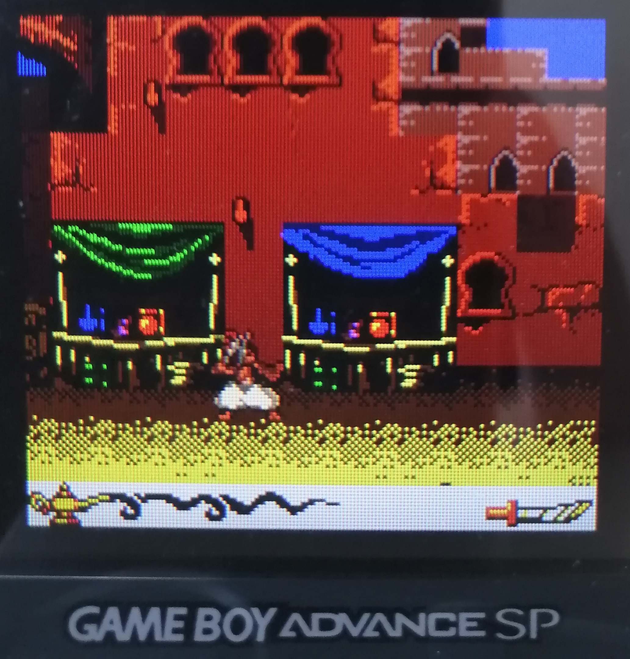

Hello, everyone. The Simple firmware is really very convenient, but I ran into one problem, namely, the compatibility of the EZ-Flash Omega flash card with the Game Boy Color games. I mean pseudo 3d games or games with non-standard graphics. I display them with these artifacts. Basically, this is how the menu is displayed, but artifacts can also be directly in the game.
I've been checking out different games, like Heroes of Might and Magic, Tomb Raider, Alone in the Dark: The New Nightmare and they had problems. At the same time, games like Zelda and Mario have no problems with the display. If you know the problem, please write.
It's not the flashcarts problem it's Goomba and there is nothing anyone can do about it
