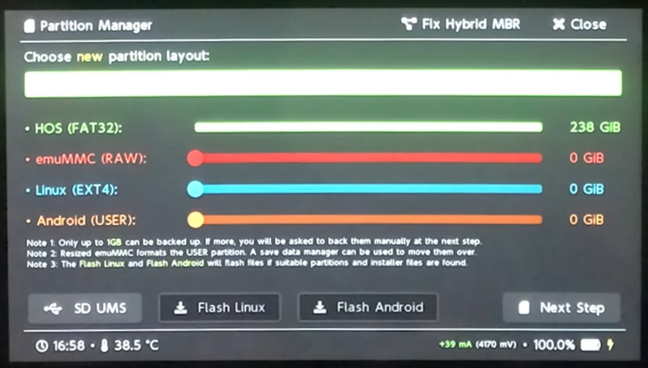

Hello folks, I'm modding my Switch OLED with PicoFly and Hakate, using a 1TB SD card. I've been researching a lot, but I can't find a comprehensive and detailed guide on the partitions to create for setting up the SD according to my needs, which include HOS, emuMMC, Linux, and Android.
So, to recap:
1. Is `HOS` the SD partition, right?
2. I need to install emuMMC, and I believe it should be the same size as my NAND in the Switch OLED, which is 64GB, not 32GB as seen in many tutorials. Correct?
3. For the Linux partition, since I'll be installing and trying out many programs, can I allocate around 160GB? Many recommend partitions that seem too small for practical use, in my opinion.
4. Regarding the Android partition, can I create it with 128GB? Many allocate 12 or 32GB, but since I'll be using Android as a TV BOX with my Switch, using KODI and experimenting with various programs and emulators, can I allocate around 128GB?
Each partition I create, before installing the respective OS files, means that each OS sees only that partition and not the extra free GB space in the SD, like for example the partitio `HOS` (the SD space left)?
Before I start, do you have any tips I should be aware of? For example, is it better to format the SD in exFAT, or could there be rare incompatibilities with some software, and would it be advisable to format the SD in FAT32?
Then, the partitions created by HAKATE with various OS, do they create primary partitions separated from each other with their respective file systems on the SD (FAT32, exFAT, or ext4, and so on), or are they containers where the OSs believe they are partitioned on a separate "HDD," and each OS doesn't see the partitions of the others?
I hope there's someone out there who can explain the functioning and concept of these partitions coexisting on the same SD card.

Since you're going with a setup that will include Android and Linux, I recommend you to follow Switchroot's parition docs and Android/Linux install guide which will explain you how to setup the partitions with Hekate. As for your specific questions:
1. HOS is not "the" SD partition, it's one of the multiple partitions on the SD card. This partition will be used by the Switch OS as a storage where you can install your games (works the same with CFW). It can also be accessed from Android as external storage and Linux (by mounting the partition). This means that you want this partition to be as big as possible, mine is around 320 Go on a 500 Go SD card.
2. It is indeed recommend to use the same size as your console MMC which is 64 Go for OLED consoles. Hekate will do that by default for you.
3. It really depends on what you do, the system doesn't take that much storage.
4. You can use any size you need, but same remark as for Linux, Kodi and the system doesn't take much storage. The big files like the media files should either be stored on another device like a NAS or on the HOS partition.

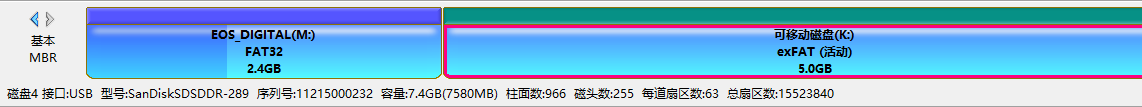

jkyoho
Sep 2, 2020
1,278
39
TORONTO
form.jotform.com
2,209
imaging SD card as hard drive, you could have NTFS, EXFAT, MACOS partition and as many types as you wish.
Reactions: CrisMod

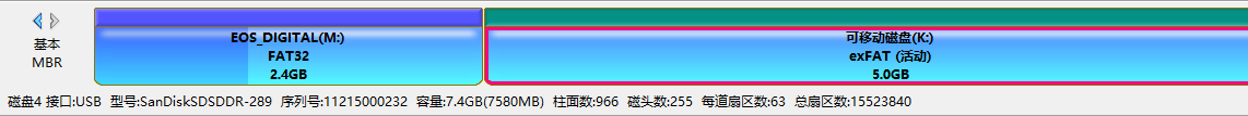

CrisMod
May 4, 2020
422
38
1,358
Italy
Thank you @jkyoho, during the below process:
So, does Hekate comprehend the distinct partitions to flash each OS if I pre-allocated by PC as your picture, or does Hekate manage it automatically?
As shown in my attached image above, I'm unsure whether, for Linux (as an example), I need to create a pre-partition in EXT4 on my PC, let's say 160GB, and the remaining space in FAT32 for HOS, emuMMC, and Android. Alternatively, does Hekate autonomously handle the partitioning with compatible partition types (such as EXT4)?
