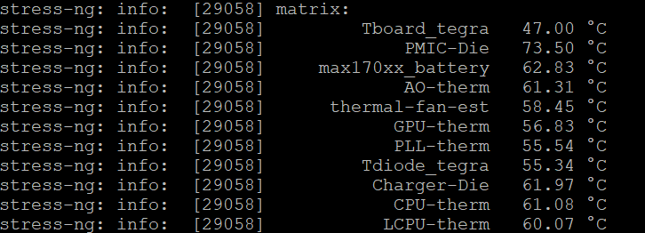

can somebody please make a stresstest on a switch with original thermal paste and no mods on it. i tested mine with new thermal paste and some thermal pads placed.
i installed stress-ng and run following command: stress-ng --matrix 0 --matrix-size 64 --tz -t 10m
it was docked but in a custom dock where it sucks fresh air and not the heated air from the original dock.
below are the temperatures i got. one with stock clocks and one overclocked to 2 ghz.
would be very nice if somebody took those 10 minutes :)
thx in advance =)
