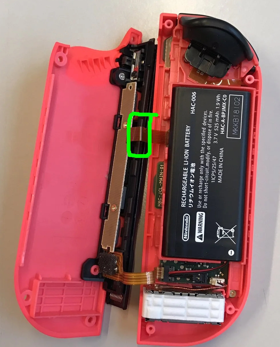

These are probably dead, that flex cable is it´s whole life bent the way it should not be bent so in some time it will crack if you accidentally drop it or disassembly it for a Stick replacement. The SL,SR and the LED lights are on the same flex.
2-3$ for a pair
