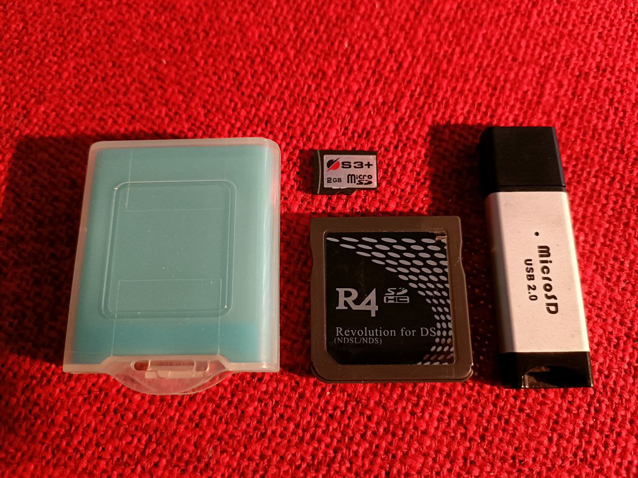

Hello everyone, I've recently picked up my old Nintendo DS Lite together with the R4 flashcard. Unfortunately someone, few years ago, took the files on the SD card and erased it. I've tried putting on a lot of different files and kernels but the result is always the same..."Loading..."! As I've read in other threads it seems to be a clone card (but I'm not sure). What do you advise me to do? I'll leave the pictures below in case it helps (That's the original setup SD - Flashcard - SD Reader). :yaynds:

I did it (still can't believe it..)! After a lot of attempts I've found the right kernel on LinfoxDomain, my card seems to be a R4-New, I tried the R4-New_v1.21_English.zip version and it worked, maybe also most recent versions would work, haven't tried yet. Thank for your support guys. ;)

Thx for the feedback, so its this one that worked from linfoxdomain.com :
R4-New r4-new.com
Latest: v1.50 Updated: 2009
The 'R4-New' (possibly also named R4 SDHC or 'R4 SDHC New' or similar) is yet another clone. It is apparently different to the other 'R4 New', each has a unique loader.</div>
R4-New_v1.50_New.zip 3.55 MB
R4-New_v1.50.zip 4.51 MB
R4-New_v1.21_English.zip 8.10 MB
