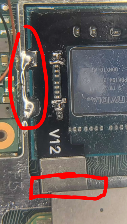

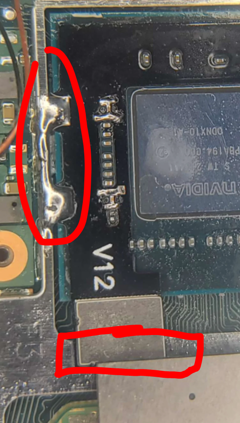

Just finished my first hardmod as well as my first ever micro soldering.
Everything is working well and I think it turned out alright. I suppose it could be better though.
Now I need to figure out what I need to do next in hekate on a fresh mod I assume it's backing up the nand and keys.
Anyway figured it was worth a share seeing I am basically new to all this and hyped I did it.

Watch out, the metal plate at the end of the flex cable should be below the frame of the APU and memory shield, not on top. And the solder blobs on the edge should be flat enough to put back the shield cover.
