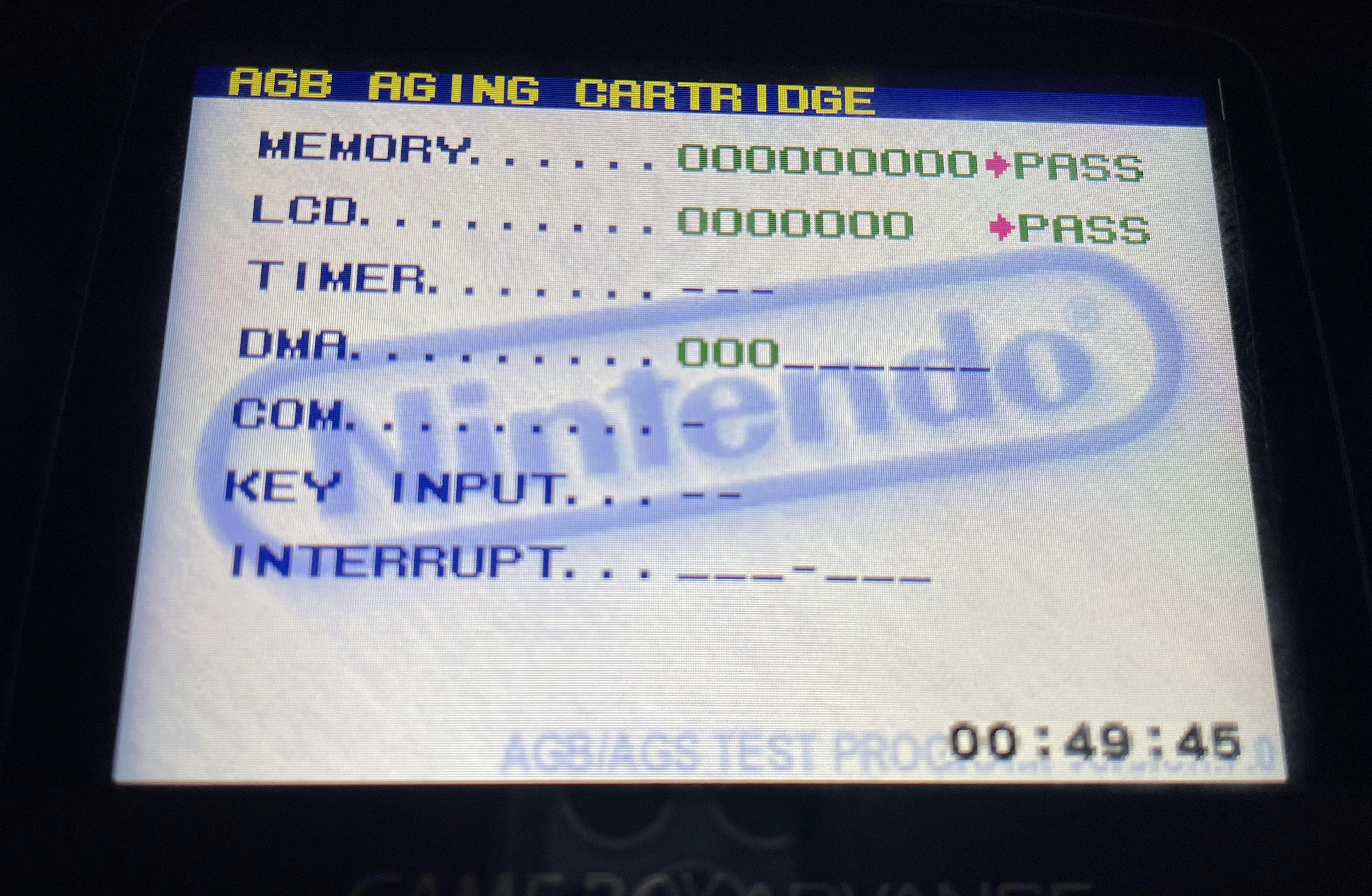

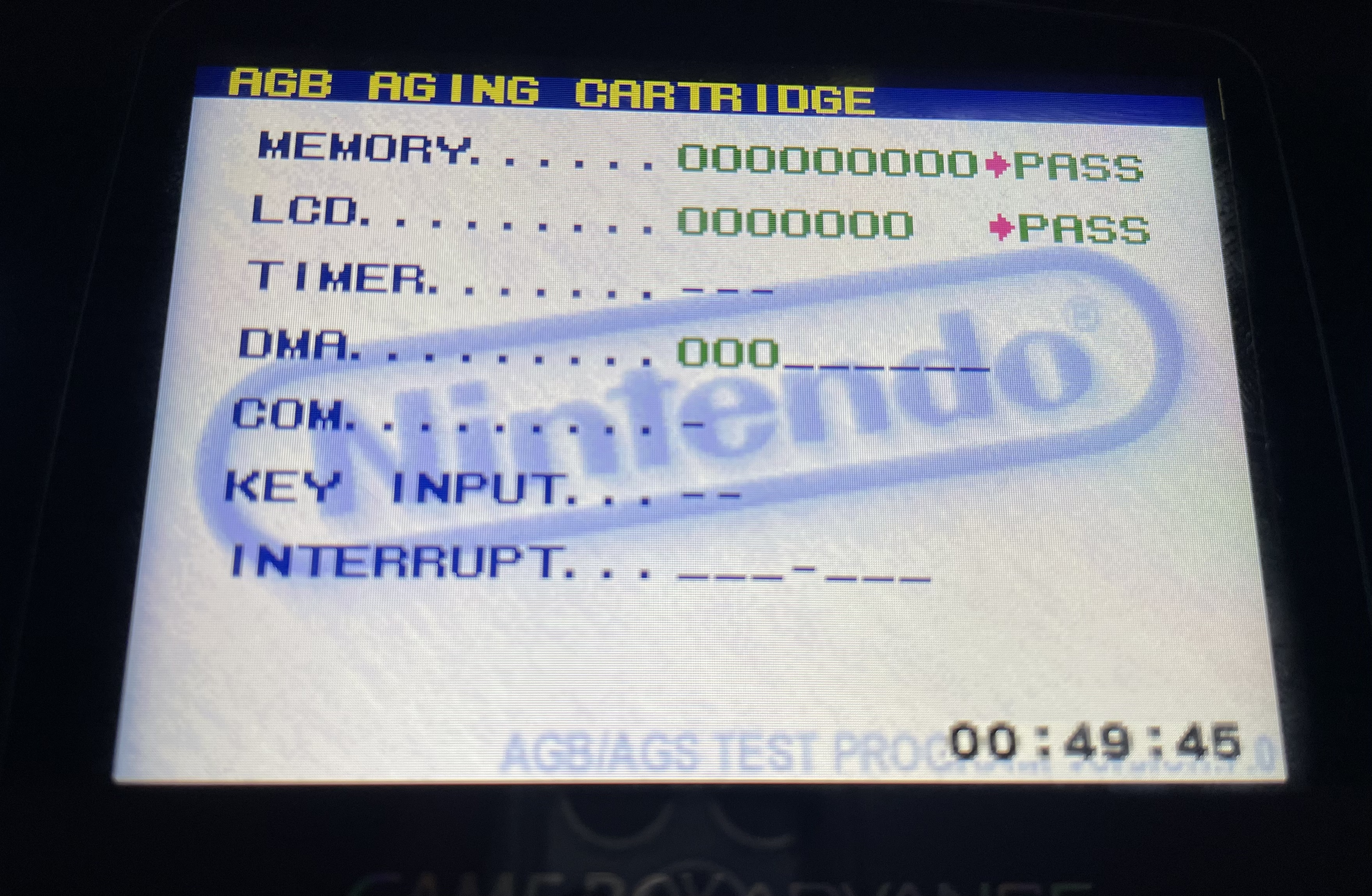

I'm also suffering from random freezes. I've tried it in a variety of games, but it freezes after a few minutes. I tried it on another body, but the result is the same. We hope that it will be improved in future support and updates.
kazu8989
Nov 16, 2021
7
41
36
Japan
It froze in 49 minutes and 45 seconds.
EZ-Flash2
Official EZ-FLASH Stuff
Jul 16, 2003
1,109
3,486
China
It froze in 3 hours and 15 minutes on another console.
What is the model of this console? Is it modded? What kind of battery does it use? Is there an external power supply?
I think it is too inefficient to ask repeated questions over and over again.
