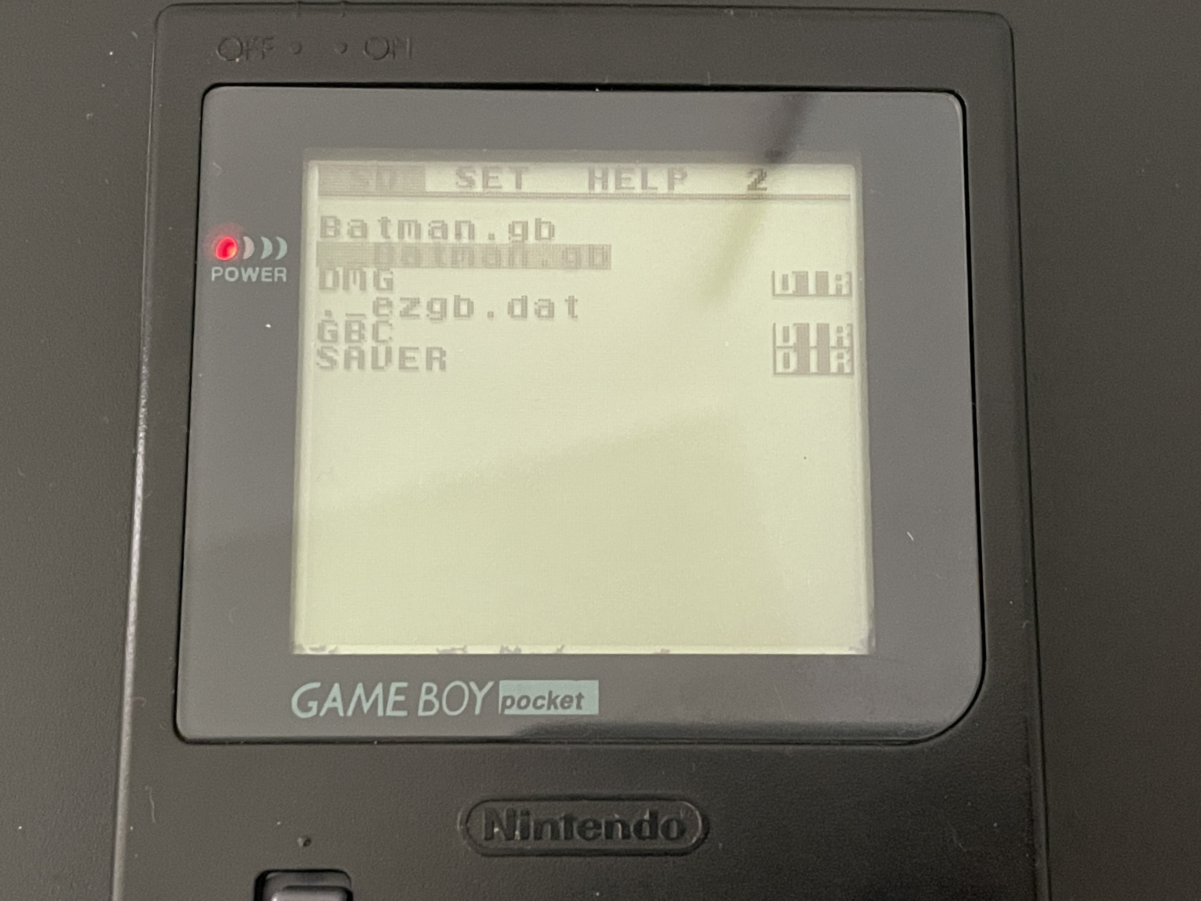

Hi,
Mi ezflash junior shows weird filenames. SD card is Sandisk 16 gb ultra, FAT 32 (formatted with official SD formatter). Firmware 1.05 RC 5 (tried this one, cause I had the SD card init error on analogue pocket).
Any idea on how to fix ?
thanks

Did you use a Mac to copy files by chance? OSX will create these .filename.extension files if i recall correctly. Don't have a Mac myself.
