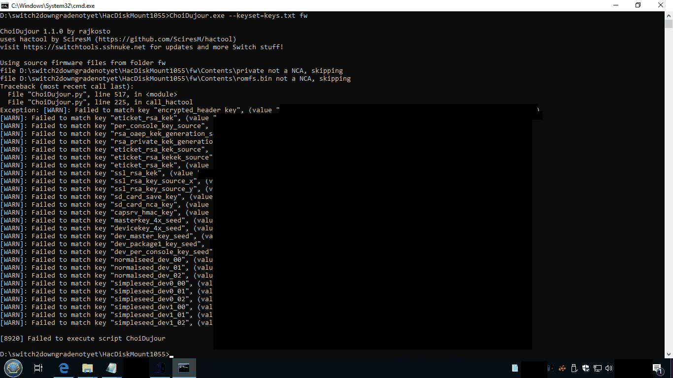

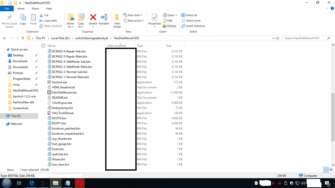

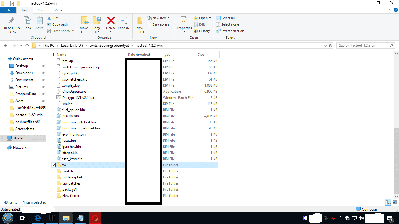

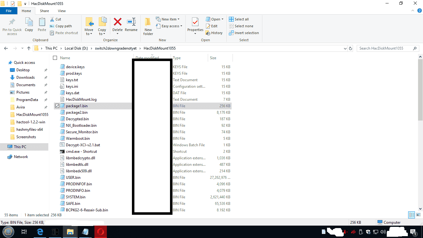

Your first folder is correct and apperas to be running correctly can you post a pic of your folder structure,, ? you do have hactools files in the same folder of choidujour dont you ? if so then your keys.txt files is not good enough and you should find another
you**:Your first folder is correct and apperas to be running correctly can you post a pic of your folder structure:
yes, i can just sec..
2nd-you**: you do have hactools files in the same folder of choidujour dont you ? :
yes, i have all files into one including all my switch console files together..-(can i do that while doing /trying this process?, or no?).. if no, then what file(s) go where to which folder(s).. and such...
3rd-you**: if so then your keys.txt files is not good enough and you should find another :
what exactly do you mean my keys.txt file isn't good enough?? and find another what??
do you mean like put my keys.txt file into another folder somewhere?,
or do you mean like actually find completely different keys.txt file(s)?? :O
and if* you mean to for me actually find completely different keys.txt file(s) then surely something else i/we must be missing here or simply over looking because i have all the proper keys straight from my console/ and fully populated hactool keys file**.. if my keys.txt file(s) not good enough then everything i been understanding about this whole process is completely wrong then about everything, because that's what they said to do?......
oh btw side note: i almost forgot i did recently change my folder structure name(s) like this for example:
D:/desktop/hactool 1.2.2/example like alot <------------- see all them spaces??..
then i did this later reading somewhere u need to try to remove or reduce the spaces
so i did this:
D:/desktop/hactool1.2.2/examplelikealot <--------------removed all them spaces still same thing when trying
the same commands but still kept my folder intact and files....
pic coming in a sec....
so i did this:
Download and place these files https://github.com/SciresM/hactool/releases/tag/1.2.0
in your directory except the .exe as u have the latest exe.. Make sure you have a good keys file and you should not get any errors keep the spaces in folder names to a minimum or none..
Reactions: Zaybokk
trying now...

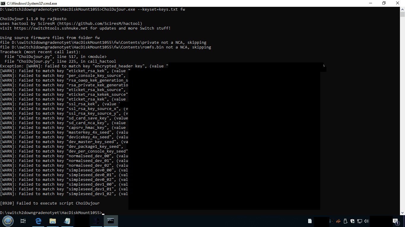

just tried same errors failed to match keys, again don't know which keys are needed inside keys.txt file and ones i don't need??...

trying now...
post error,, or try to remove the invalid key first...
Invalid key i sometimes get and i remove... there is a command to use no keys but i forget the how to..
just posted /edited above pic... :D
Try a different key list copy paste below into google its top link
MaxConsole Underground Skull & Crossbones Nintendo Switch v6 Firmware & System Key List
and or remove all the invalid keys ... make a backup first
Reactions: Zaybokk

so basically. remove all key(s) except above mentioned listed key(s)..
then i good?.. then no errors?..
backup old keys txt first try delete the errors keys listed .. and or try the other keys files you found on that website...
