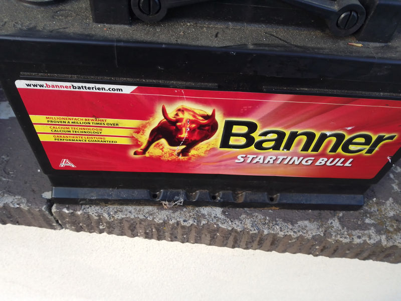

This Monday I was forced to go to the grocery store. I hate it with passion, but even a LittleSinchen has to eat and since the shops don’t sell a big amount in one shot anymore I’m forced to go more often or visit more shops at the same day.
One of the rare occasions that I use a car. Carrying a bunch of food and water crates without the car is a bit hard. So I sat down at the driver’s seat and turned the key. Preignite and start. The starter motor made a sad and slow: “Murph, murph, murph.” Preignite again… “Murph, murph, murph. Murph. Muuuurph. Mu. And nothing more. I had seen it coming. Despite being fully charged the old "Starting Bull" battery had more and more problems starting the old TDI Diesel engine in cold state during the last few weeks. The once energetic bull has been become an old, weak ox.
Sinchen: “:shit:!! As if shopping for food wasn’t bad enough. Now this.”
I went to the attic and took a spare starter battery as well as the jumper cable from the trunk.
Starter Motor: “MURRRFMURRRFMURRRF!!!”
Engine: “WROOOM! Bang, bang, bang…”
(Those old TDI can sound like throwing a bunch of stones on a big steel sheet on cold start)​
So I could do my shopping.

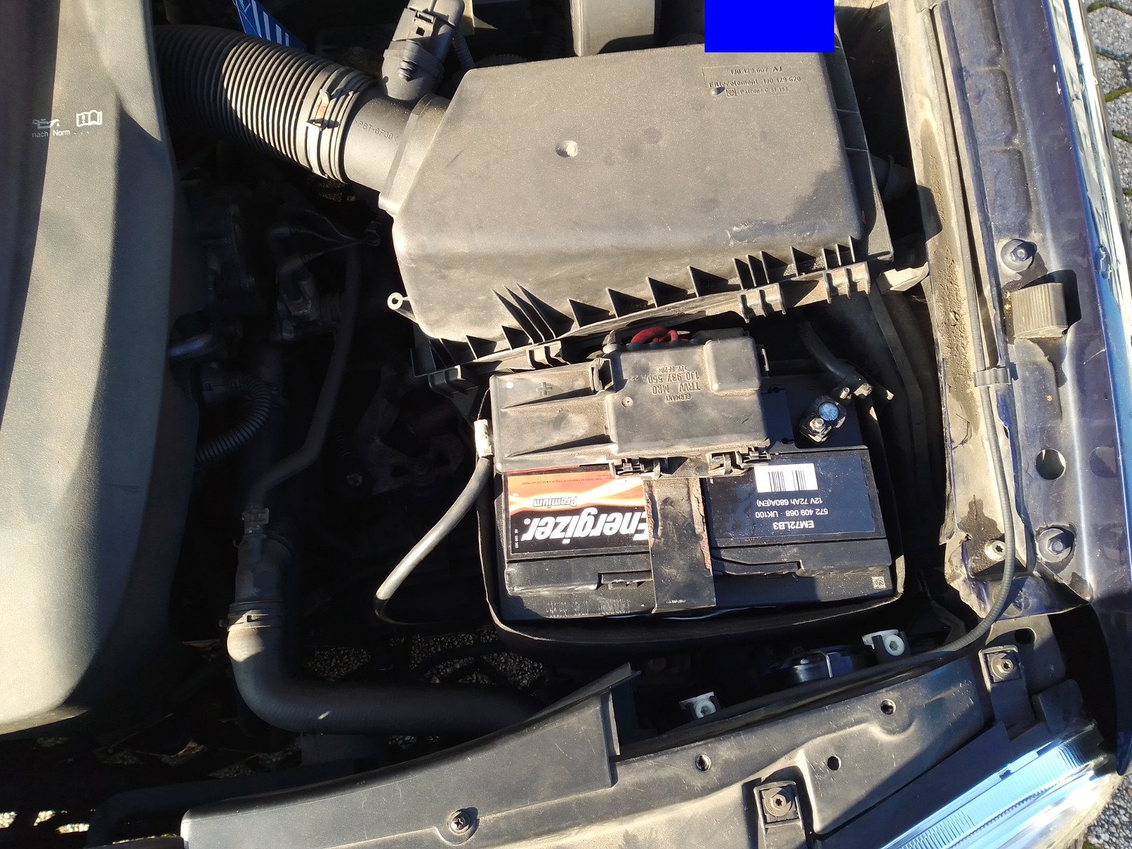

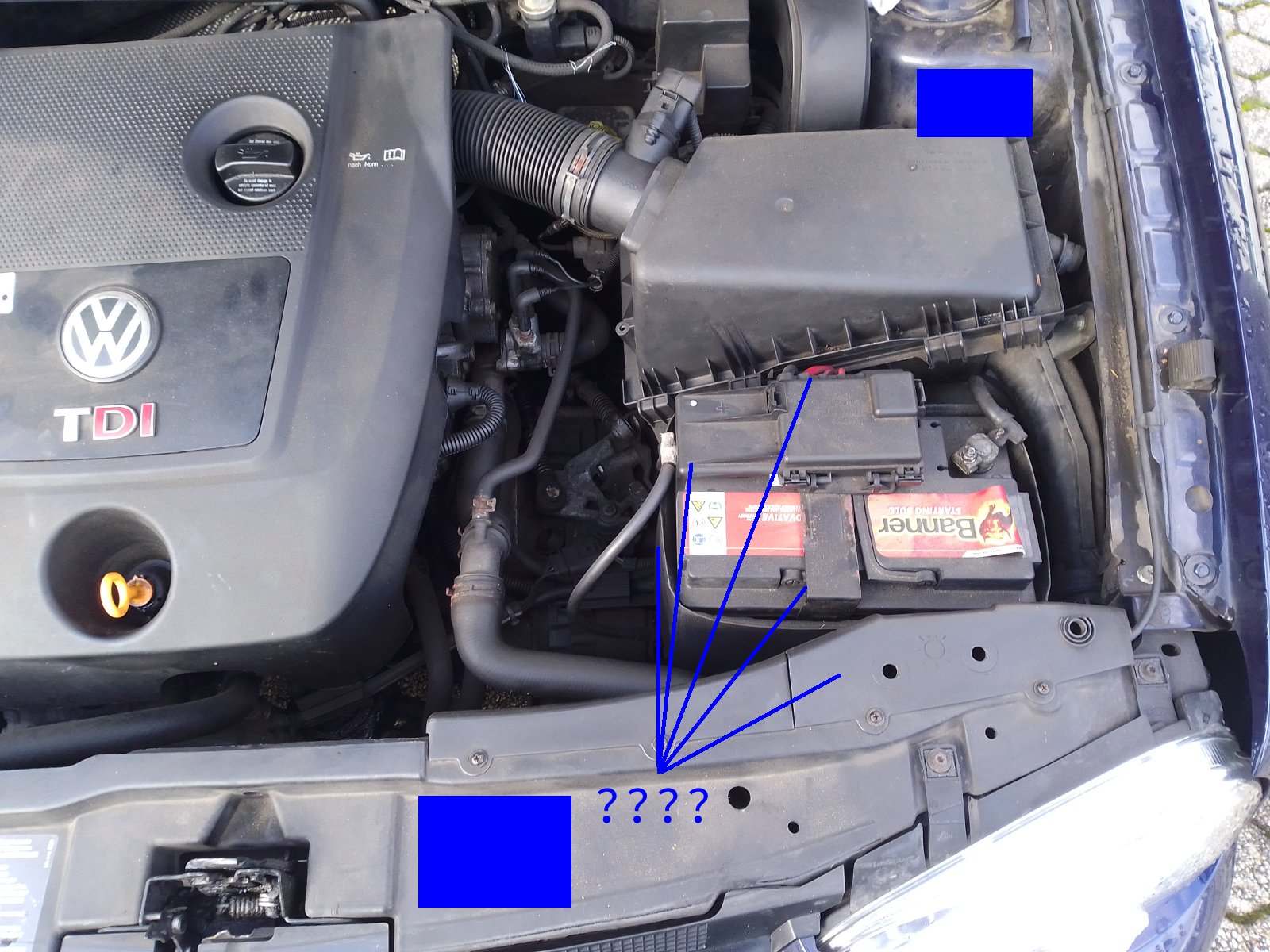

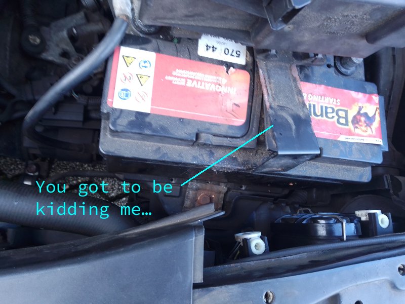

A bit rainy and snowy in the last days – today no rainfall, so I decided to replace the failed thing. I’ve done it before on cars from the 1980s and early 1990s. Takes roughly five minutes to replace a battery. WRONG! Volkswagen, what did you do? What is all that crap? A bracket above the battery? A plastic cover for the head lamps must be removed to get to the large mounting screw a the bottom? Some insulation wrapped around and closed on the weirdest possible location? Wiring harness above the battery?
It took me about 45 minutes to replace a stupid starter battery. I thought a Golf IV from 1999 would not cause any trouble with that. At least the thing is now in and the engine starts again.
Cars are weird. I love my bicycle.

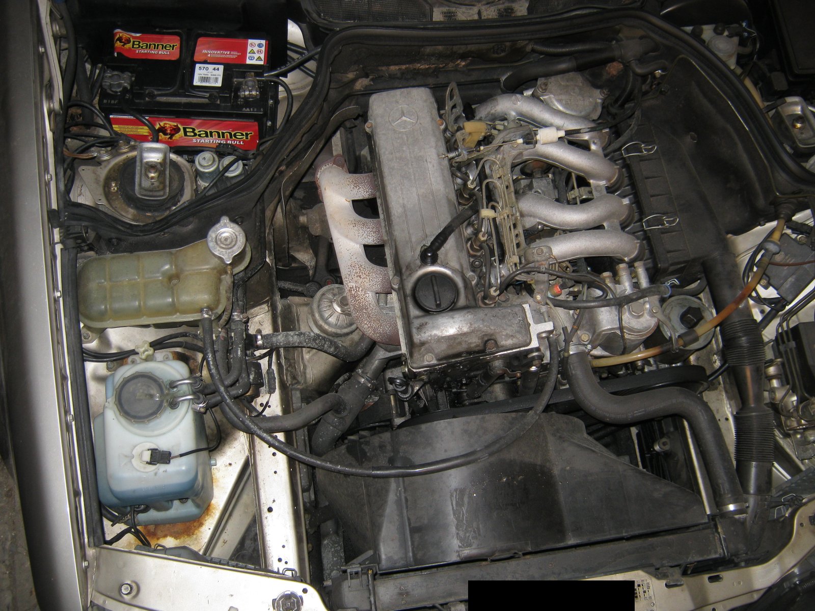

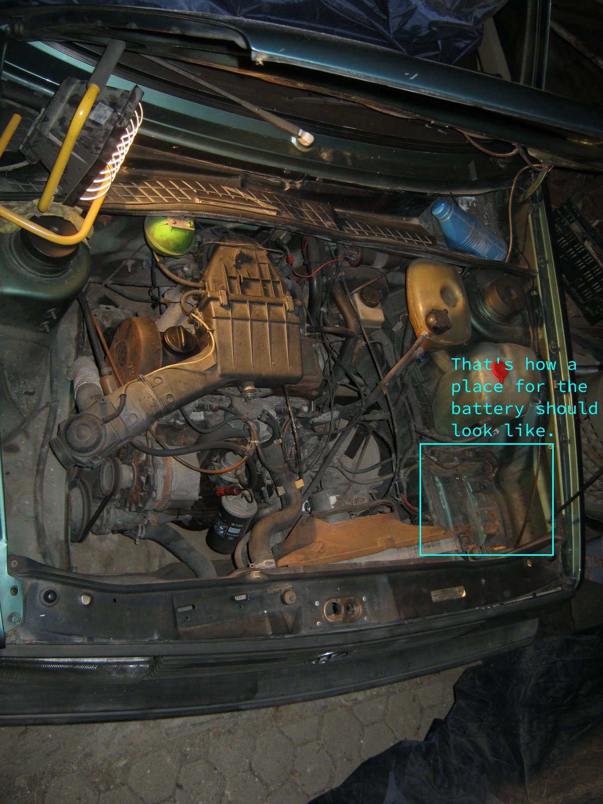

Two new pictures – how it should look like.
Mercedes-Benz W124 (1989)
Volkswagen Jetta II (1984)

Starting up a small gasoline engine is significantly easier than a heavy Diesel.
Below freezing the starter needs ridiculous amperage to start up (and capacity to try multiple times). A smaller battery would perform alright at the beginning but fail prematurely. If there was enough room I'd install a 100AH whopper with some more lead plates than the 72AH.
Hopefully I don't have to do it again. The car will die rather sooner than later. But it may be possible that reaching the light bulbs actually requires doing the whole nonsense again. So narrow. Please don't burn through, lightbulbs.

That branding, "Starting Bull" just makes it look kinda cheapo. Maybe that's why it broke. Winter is pretty rough on batteries though and if the car isn't used for so long that the battery deep discharges, that is something lead acid batteries really don't like, and it can kill them after just one or two deep discharges.

Lol, good thing this wasn't a newer VW. Those are a hassle because of the involved reprogramming the settings that are lost when the battery is removed, like the ECU, window regulators (wtf?), car-to-key FOB sync, and alternator. Avoiding that mean taking another battery with jumper cables and connecting those to the terminals while swapping out the dead battery.
When you get the chance, clean the battery terminals and add some dielectric grease. That'll go a long way's keeping the new battery alive.
Was the alternator changed before, how long ago, and how many kilometers? Does Germany has something like our "AutoZone, O' Reilly, Advance Auto" car parts store where they can test your alternator for free? ... If you later suspect a charging issue prematurely killed the bull battery.

Grease is a good idea… if you are able to tell me where the **** I put it. I just could not find it.
Reprogramming electronics… I don't want a computer on wheels.
I don't drive very often – but it has a lot of kilometers (almost 300000) because the previous owner used it very much.
The Bull battery was pretty old – four years in the Golf and my father had used it before for ? years. It did not die of deep discharge – charged regularly if car not in use.

@KleinesSinchen, wear gloves when removing corrosion with a mini metal wire brush or rolled up piece of sand paper. Clean until the metal surfaces are shiny. Disconnect both terminals when brushing or sanding. For extra safety, mask/duck tape both battery connectors.
Dielectric grease comes in a small tube or in 1 time use package size like condiment sauce. You can also use general purpose lubricant (like the ones for bike chains), penetrating spray oil like WD-40, or silicone/PTFE (teflon) lube. Take a q-tip when coating a thin layer on both cable terminals and battery connectors on all of the metal surfaces. Don't overcoat (No on extra thicc!).
Dirty terminals will lower battery life due to increased electrical resistance.
