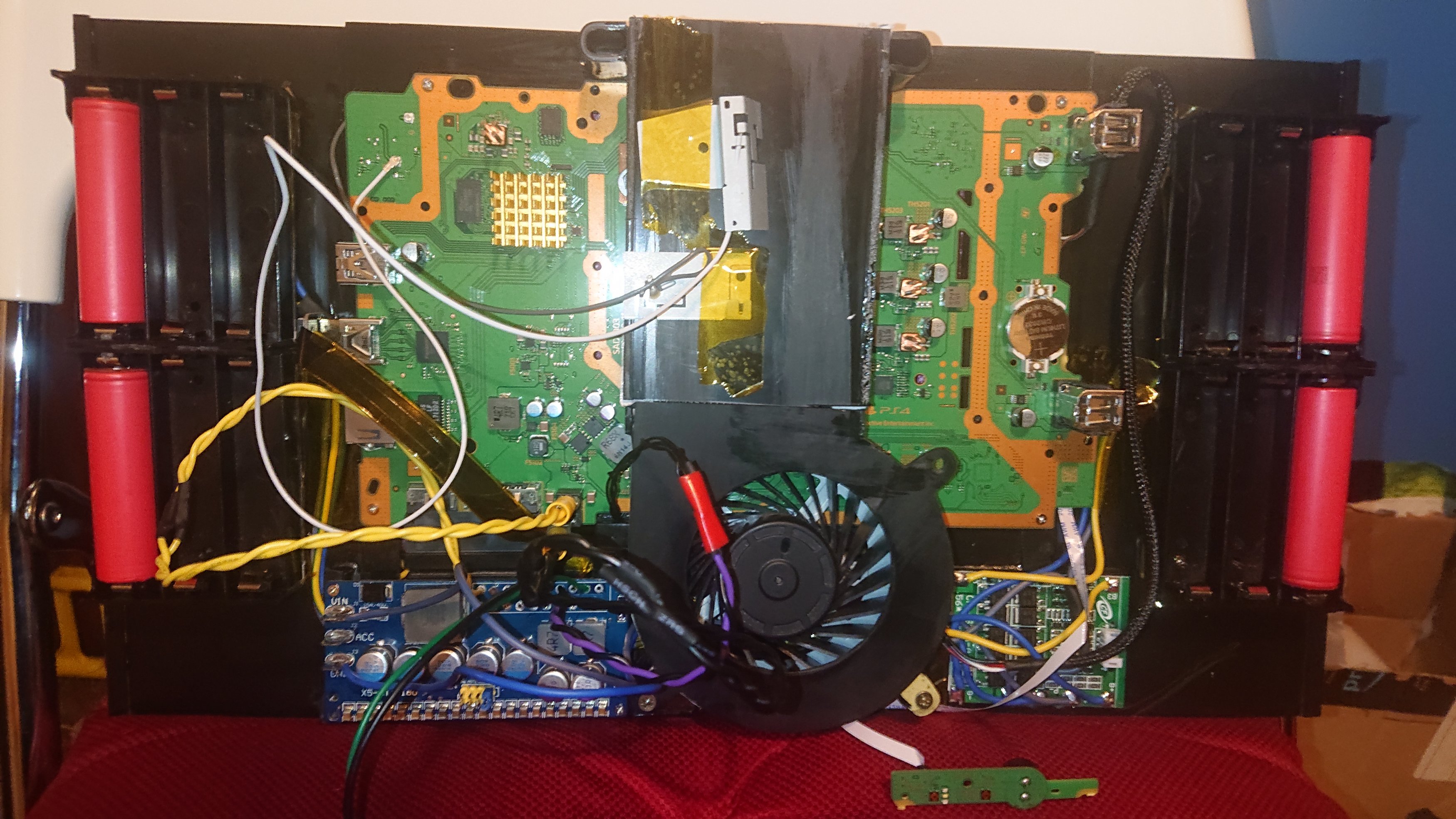

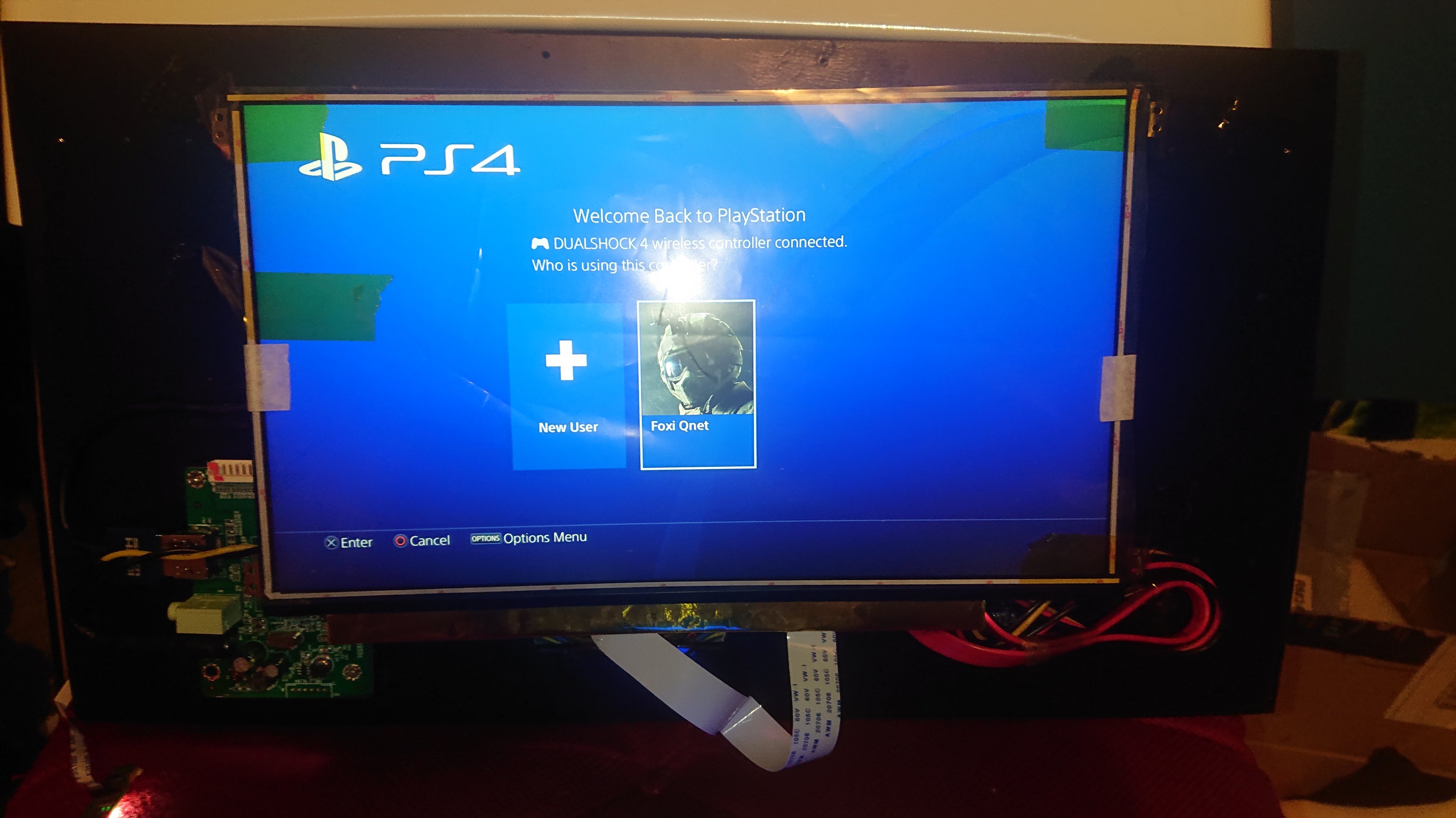

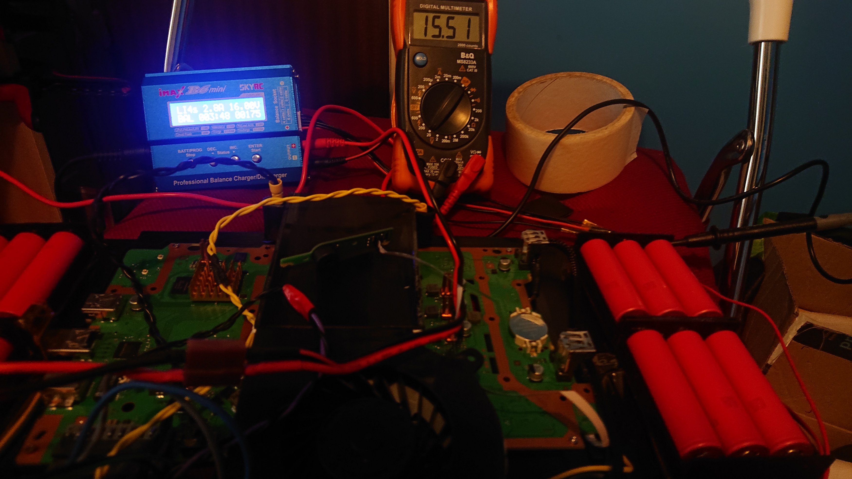

I like to tinker with electronics, but I have a nasty habit of starting and never quite finishing my work. I figured I may as well dump those projects here - perhaps one day I'll motivate myself to finish them. Yeah, my workbench is messy - sue me. :P
View attachment 254034 View attachment 254035
View attachment 254036 View attachment 254037
View attachment 254038 View attachment 254039

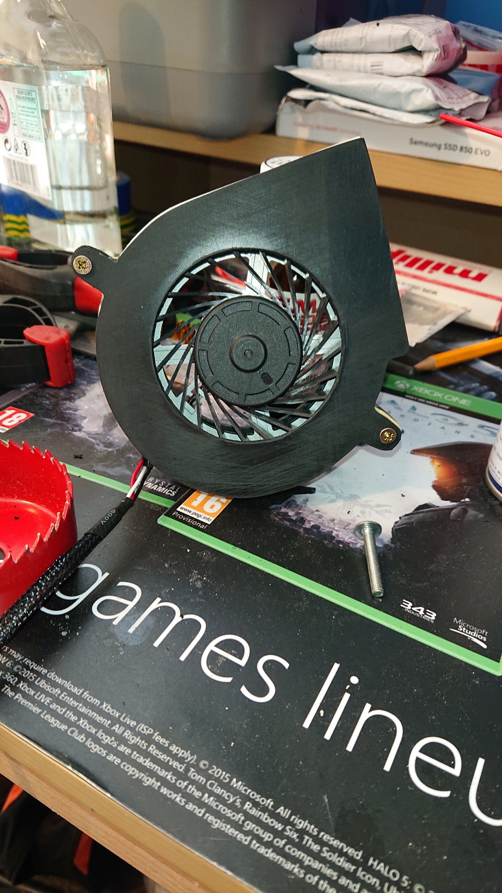

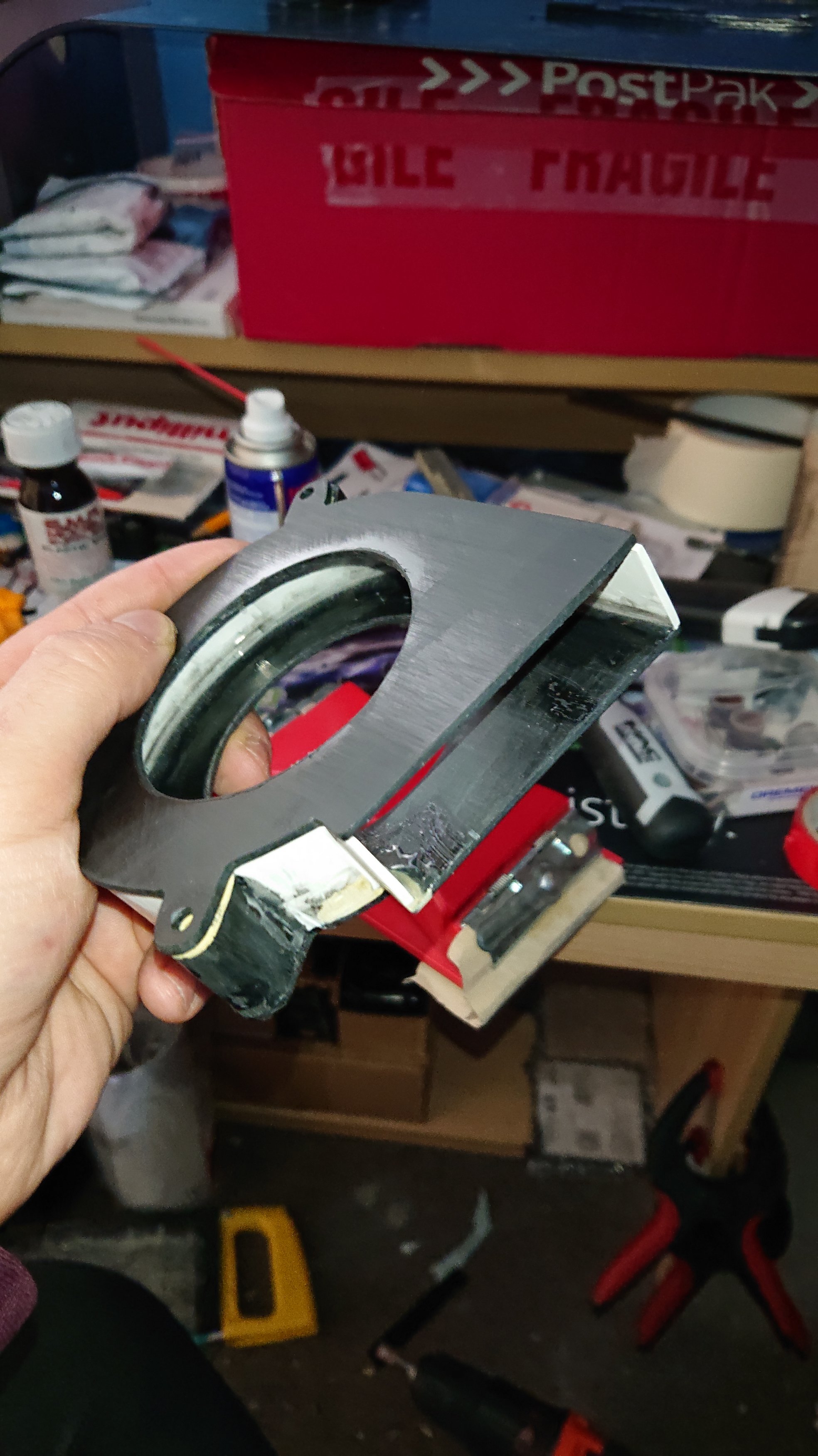

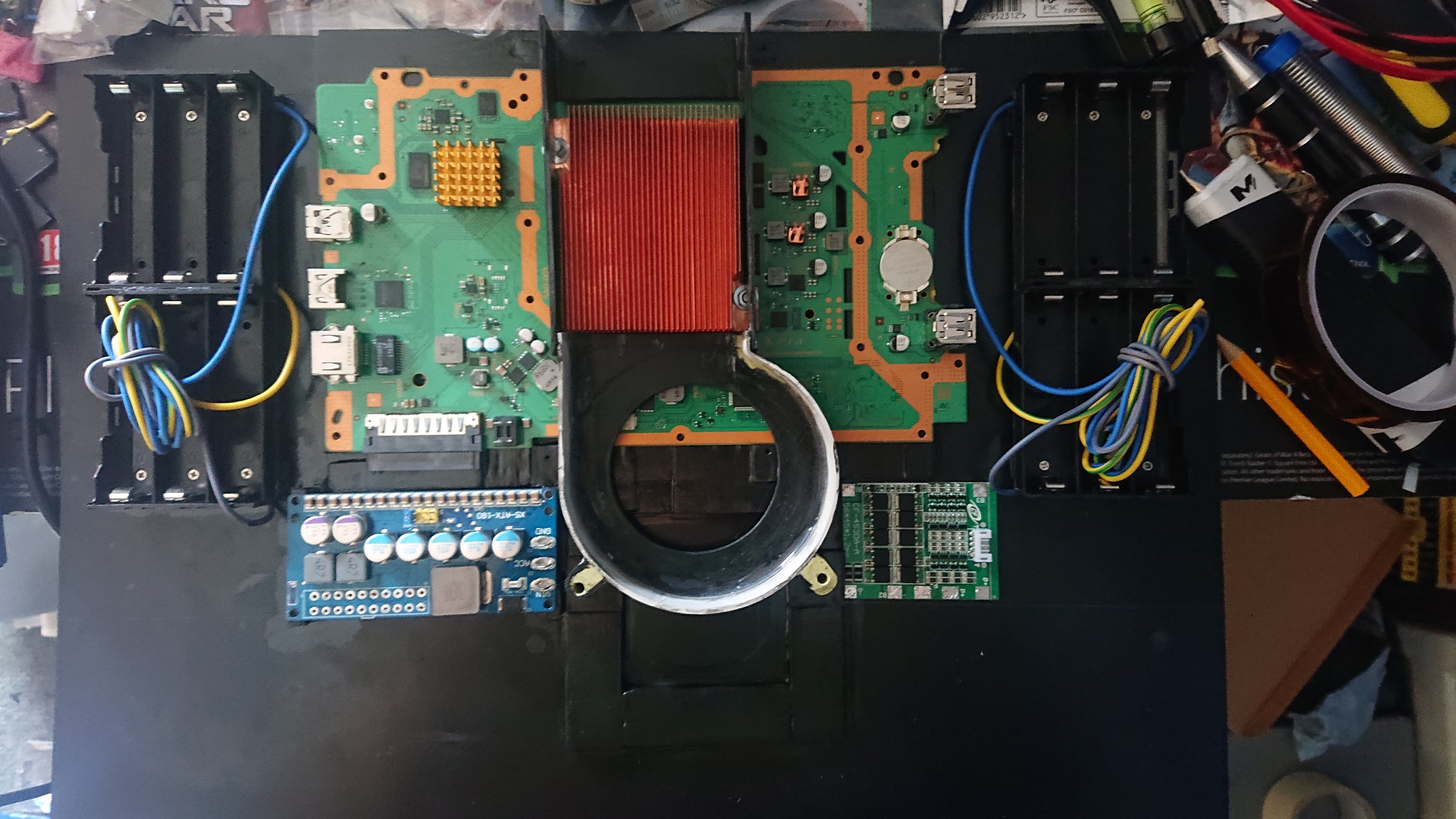

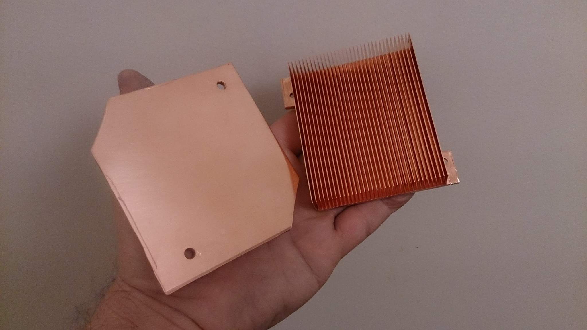

Edit: A bit of a closer look at the cooling solution. Has some heft to it.
The heat sink was trimmed down from 80x80x20mm down to a +/- 60x60x20mm with "wings" for a hard mount, the plate was cut out of a 3mm thick copper sheet.

I had zero issues since I designed everything on paper before I even bought the Slim (I only purchased it for this specific surgery). Lots of math went into appropriate cooling and power delivery, and everything worked as expected - the system runs just fine, and with that massive custom heat sink it actually runs quieter/cooler than stock (it's two-sided too - large fin stack on APU, huge copper heat spreader on the memory). The snag? My own laziness, and the lack of a 3D printer to make a chassis that doesn't suck. I'm sure I'll finish this one day, or so I tell myself, at least. :P
