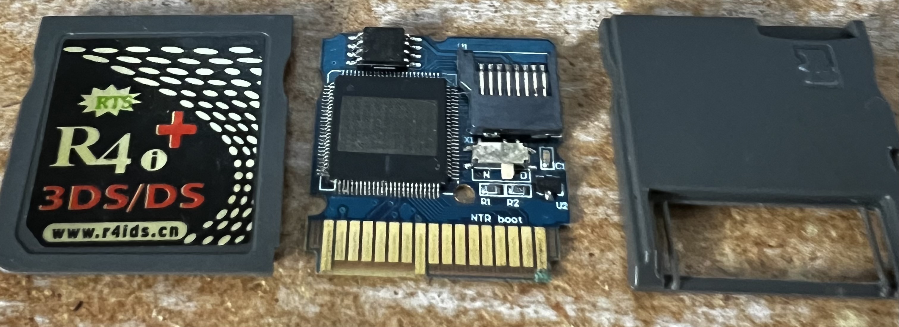

Is your microSD formatted Fat32?
That cart also has a switch on it to toggle between ntrboot and ds mode. Make sure it is in DS Mode.
The switch is under the shell, so you will have to open the shell to access it.
