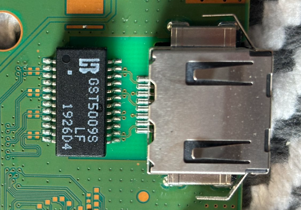

Is it a hardware mismatch incompatibility issue?
Maybe you need both sides (PS4 and Laptop/RP4) to have the ethernet transformer chip. Some devices uses inbuilt transformer inside the port itself, which has less isolation than the chip form.
Raspberry Pi 4 is an example where it uses an inbuilt transformer inside the port (no chip).
