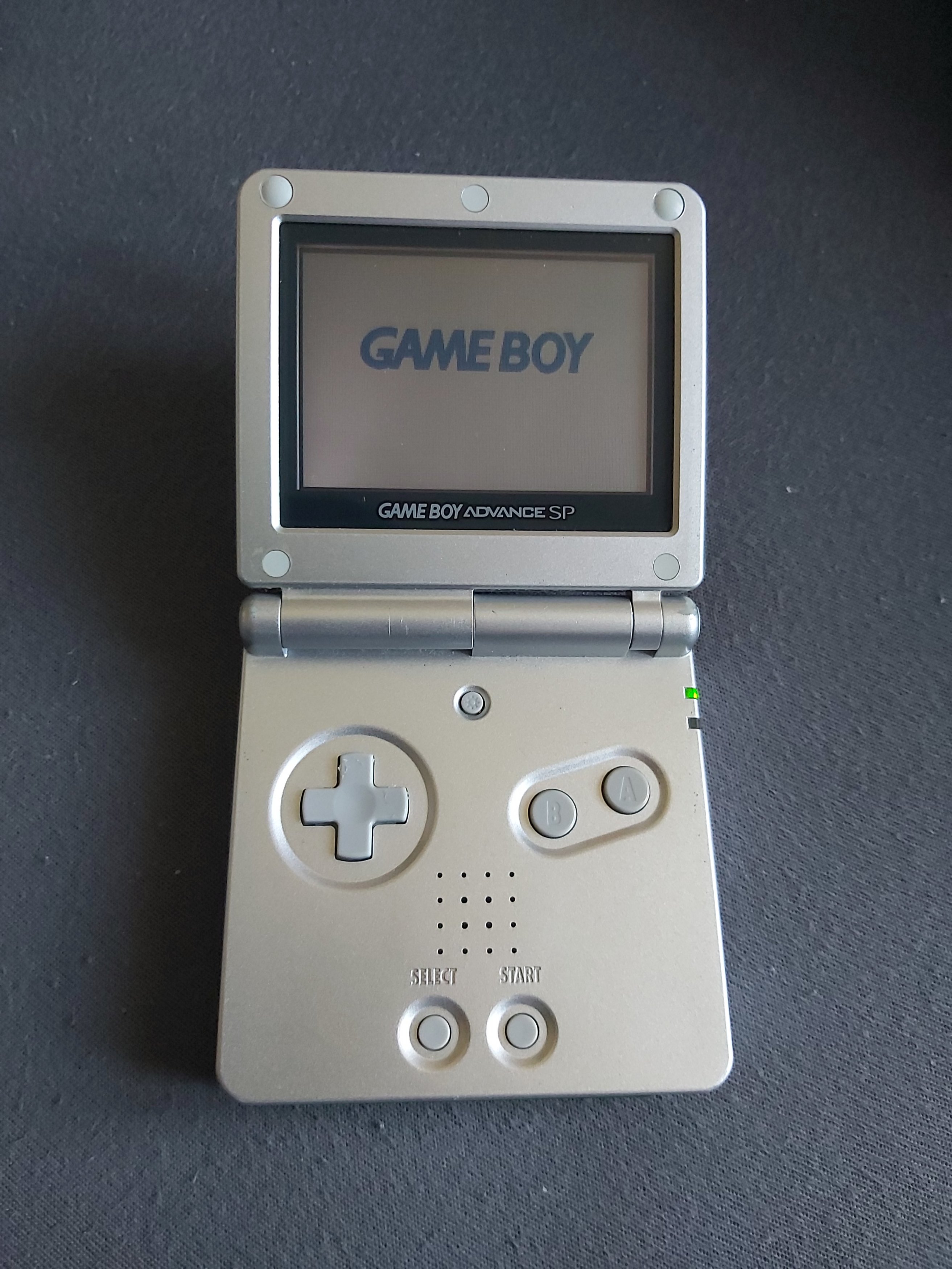

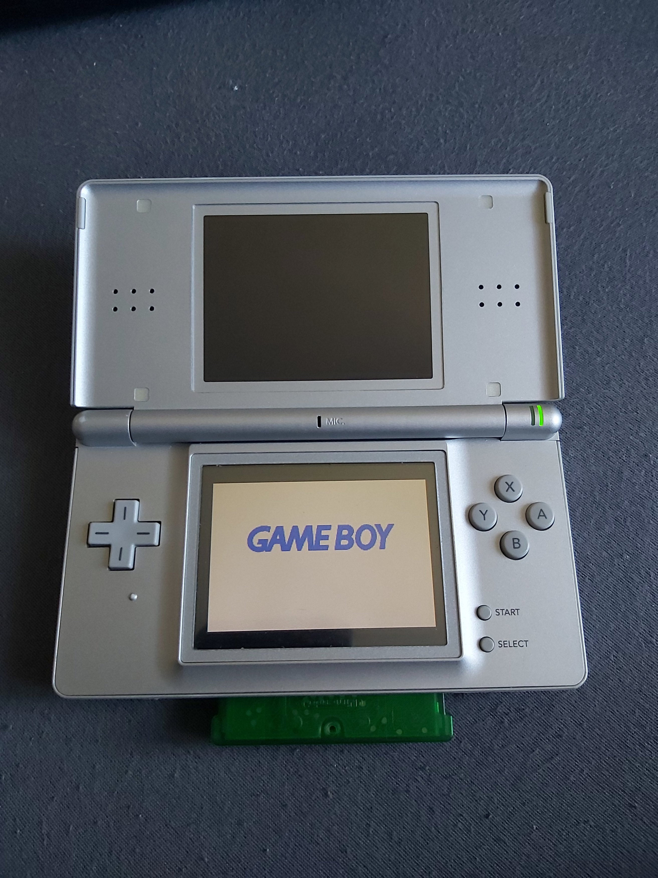

It's not fine, both my DS Lite and GBA SP won't boot the game

I just tried this out with a brand new bootleg I got from Aliexpress. The chip says it is a "hy62uf8100."
Your app does the following:
1. Detects it as a "Spansion." I did some quick research, and it says it is a Hyundai chip, but I could be wrong. Literally did 5 minutes of research.
2. Erases the bootleg
3. Writes the rom. It takes a while to write, which I imagine it is normal behavior.
4. After the write, it reboots into GBA mode, launching the game. However, after the GBA splash screen, all I get is a white screen.
Here's an image of the board if you need it. I'd be more than willing to help test this out.
[Edit] I was able to get this cart to boot Fire Emblem: The Binding Blade, but it wouldn't save. Of course, because of the way bootlegs save games, and me not knowing how to set that up properly. Still weirdly, I'm unable to get the original game back onto this cart (Wolfenstein 3D).
[Edit 2] I was also able to get Mega Man & Bass to run. Wouldn't save, of course. After patching Wolfenstein 3D to use SRAM, the cart was able to boot the game.. without being able to save. I know bootlegs save by essentially overwriting their flash memory, but I don't know how to set that up just yet.

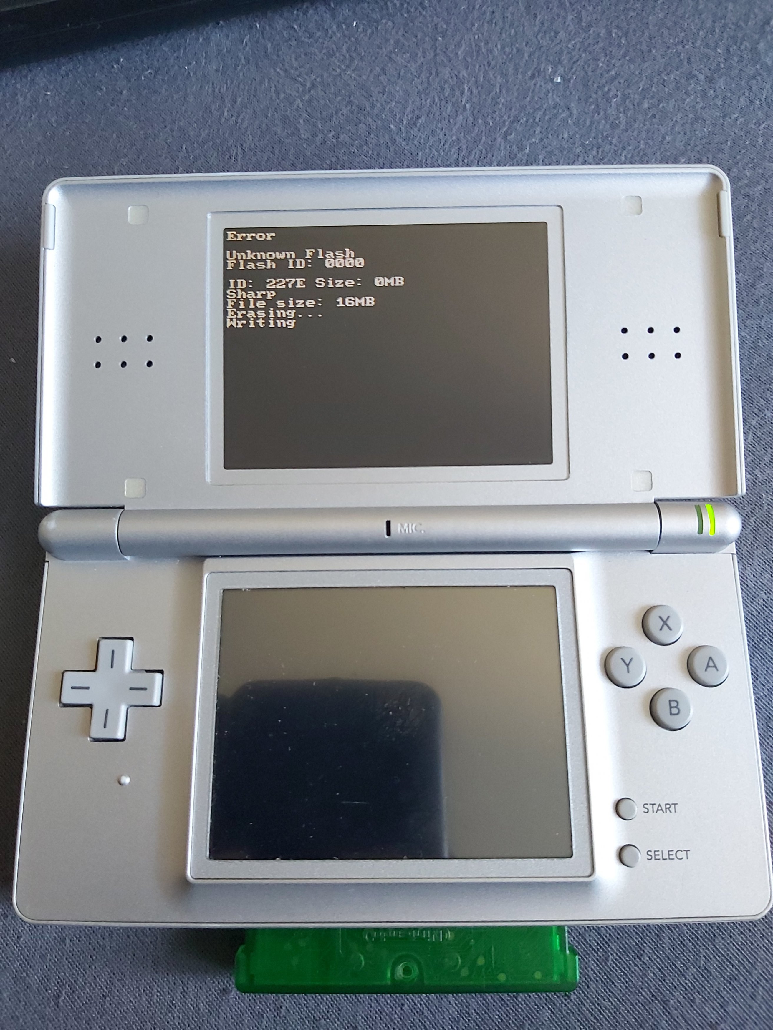

I tried with a 22FC with a "Sharp" chip, some games worked to write but others didn't, getting stuck at 50.
Also I tried a 227E with a "Fujitsu" chip but it gets stuck at "Writing 0", it happens with all games, even when trying to rewrite the original one it instead gets stuck at "ERACE 25", any ideas why?
Had two other bootlegs, but they seem to be a FLASH ones that the program doesn't seem to support.
Also is it possible to patch an SRAM game to EEPROM?
What about "Erace 25" I will fix it on feature. Take photo of 227E board. I think it's problem with sector erasing...
