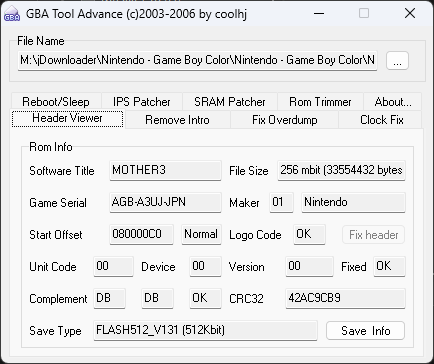

can i in theory reflash mother3 cart from aliexpress (m5m29-39vf512) with mother 3, translated to my native language?
(Or 36lor8-39vf512)
Or maybe someone know a 32mb cart, that i can buy from ali, i can put mother 3 to?
(Or 36lor8-39vf512)
https://www.aliexpress.com/item/1005005586506154.html (Golden Sun 2 The Lost Age, Gold Sun 1 are Batteryless patched)
this is a 32MB cart with Flash save as Mother 3 uses Flash save also, you will not need to SRAM Patch/Batterless Patch
