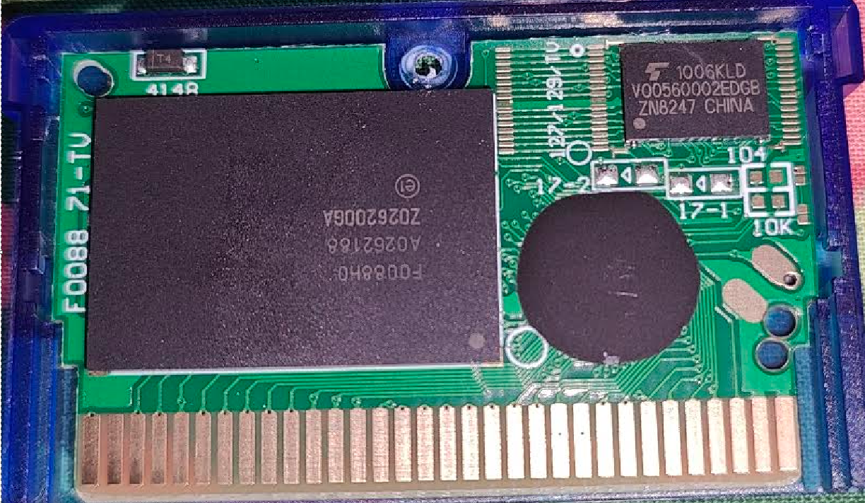

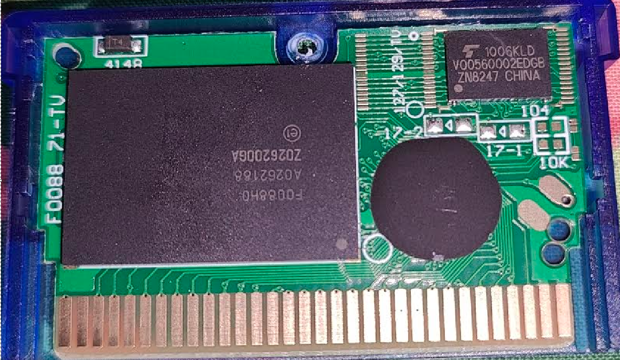

I bought a bootleg Yu-Gi-Oh gx duel academy bootleg, it works but i want to change the rom inside but the burn2flash says it's Unknown Flash.
Toshiba
TC55257DFL-70L
Might have to use a GBxCart RW, or a Joey.

Yeah, maybe it can't detect because it has 256mbit flashsize i think
256Mbit is just 32MBytes right? That's the regular threshold for GBA carts, bootleg or not. Should read/write to/from it fine. But looking at the picture closer, on the left side it looks like maybe some lifted pads and a possible diode lifted. It's kinda hard to tell, but that entire board is a mess. Flux residue is EVERYWHERE on that thing, along with splatters of unknown substance on the chips, and some random red bodge wire? This thing might or might not be salvageable, or even worth salvaging to be honest.
