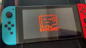

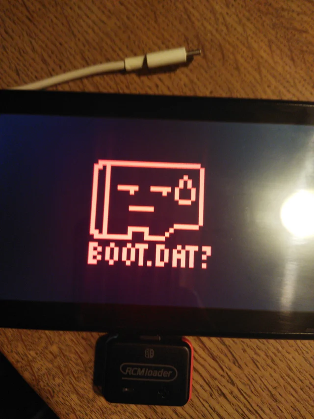

Like this?
That's the error screen of original sx core/lite. Are you sure the seller sent you a v6 instead of the original sx chips? If you have an original sx chip try to update it to latest hwfly firmware and use debug terminal to figure out what's wrong.
