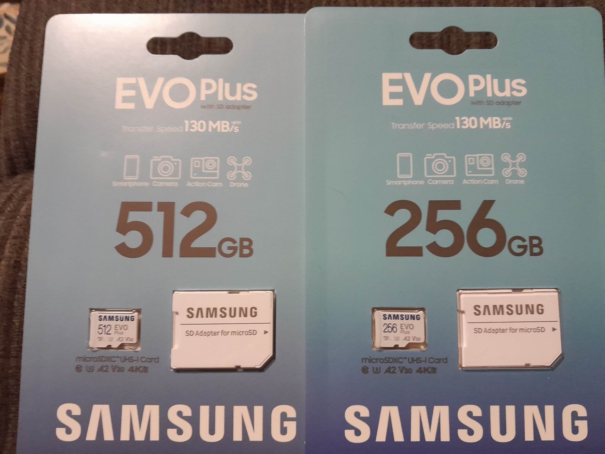

These are the Micro sdxc to usb2 adapters (pic below). I couldn't dig up the original ebay purchase stats. I did search high & low to find these. No luck :(
I can't find these adapters anymore, but these were certified to 128gb sdxc.
I got them working with 256gb & 512gb sdxc, & without any problems.
Sadly, the current adapters seem to only cover sdhc limits (32gb).
Maybe I was lucky with the ones I got, & they were a bargain at Au$6.50 (for a 3 pack - ebay).
I can't advise on the new style adapters, but if anybody else has tried them, then please drop a line of what was experienced :)
Also, just bought another Samsung 256gb & 512gb evo+ sdxc cards for Au$90 (total).
These are for the latest Modmii & my other 2 wii's waiting to be legends ;)
The older mod is going strong & 99.9% faultless :)

All going great with using SDXC cards with my USB adapters. Hasn't missed a beat :)
Same, repeated minor issues with discrete 256gb USB drives. Not a huge disappointment, but when there's a choice between SDXC & discrete USB drives, I choose the SDXC over discrete USB drives :)

I have been using a 512gb Samsung evo+ micro SDXC in a USB2 adapter. WBFS partition worked better than well the first time & still no corrupt or damaged files/games .... bla bla bla.
