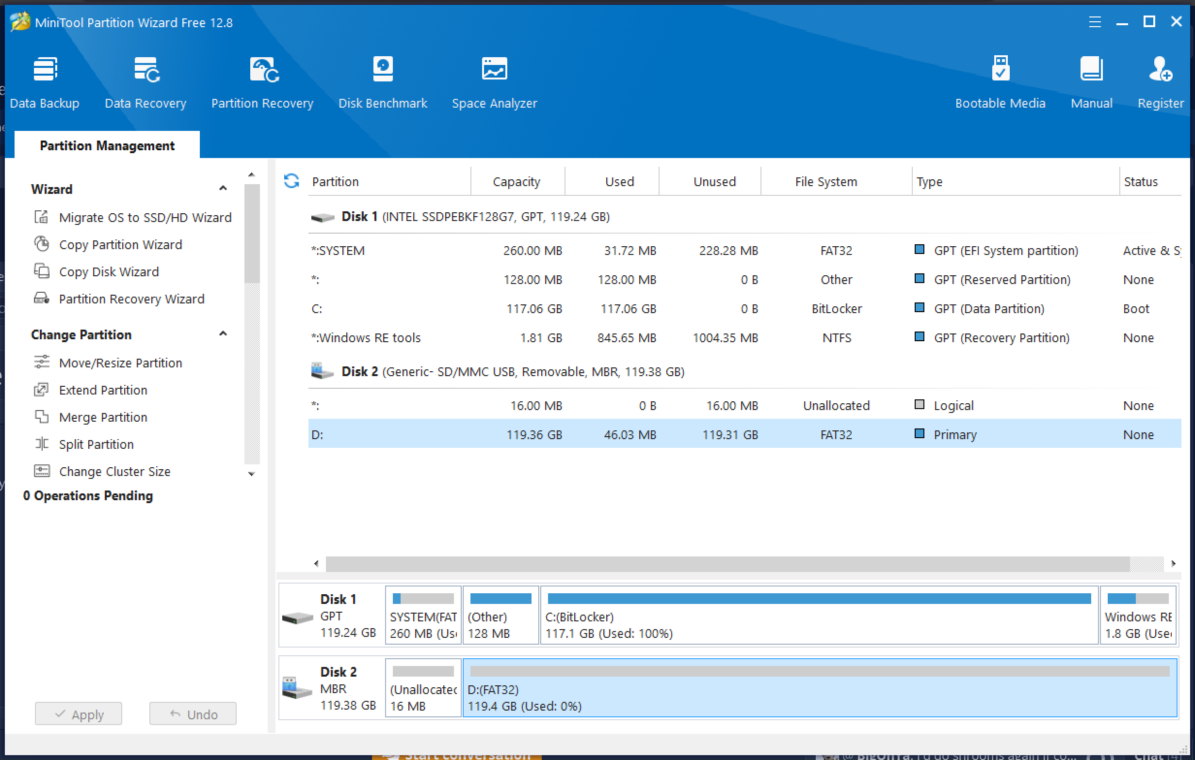

Partitioning the SD card​
On Windows you need to use a third party tool like Minitool Partition Wizard or Easeus, on Linux you can use gparted.
You need to have two primary partitions on the card:
  1. FAT32 - (in gparted set lba flag). This is what the PC will see and all your homebrew goes (you should already have this)
  2. NTFS - This partition will be the "USB", you use to store the Wii U games on (don't assign a drive letter)
Shrink the existing FAT32 partition to make room and then create the primary NTFS partition after it. It's recommended to align the Partitions on 64MiB boundaries and use a multiple of 64MiB for the size. NTFS won't be the file system the Wii U will be using, it is just there to tell SDUSB which partition to use (it will pick the first NTFS one). The Wii U will later format it with it's own file system.

I've been trying to use Minitool Partition Wizard when following this tutorial, but whenever I try to apply those changes (resizing the FAT32 partition, creating the NTFS partition from the unallocated space), I keep getting "Error Code 12," which is a filesystem error according to their website. I tried using the "Check File System" option in the application to see if there were any problems, but no errors were detected, so I don't know where to go from here.
I am using a Kingston 64GB Canvas Select Plus microSDXC Card. I know this is not an endurance-based SD card, but I really want to try this out.
Stan4d
Aug 21, 2023
75
1,141
Maybe you can do it on the command line tool with diskutil.
Or you might be able to find a third party tool which can do that.
Else it would probably the easiest to use another computer or to boot a Linux with gparted.
I don't have a Mac, so I can't test it
I will just use a third party software instead
