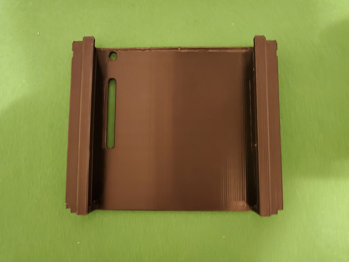

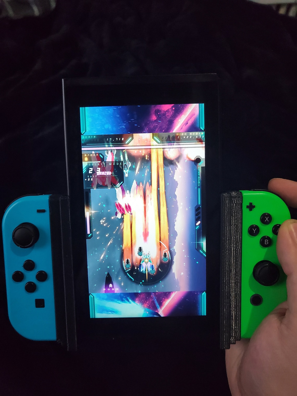

Next we have the Vertical Portrait Switch grip:
I'm sure this is far from the first of this kind of device you may have seen before, but this is my personal take on such a device, and my own unique 3D print of it.
This is the print, the inside has 2 little lips, that catch the Switch when you slide it down, so it wont ever fall out while you play. The joy-cons slide up in the sides of the device. Since 3D printing the locking joy-con mechanism doesn't work too great, the best solution is to have the joy-con slide up into the device and run into a lip, so that the device can never slide off of the joy-con while in use. This should fit the OLED model as well.
Works great for 3rd party joy-con too. It's interesting how many great Arcade, Shmup, and Pinball games on the Switch that can be played vertically. If you have any yourself, this is definitely something to look into.

Not to be "that guy" but you've got some serious over-extrusion going on, along with moisture in your PLA. I suggest drying it out, and calibrating your e-steps to fix these issues, and you'll have much smoother prints. (I just went through these issues myself, infact.)

You do you man, my customers have overall been very happy, so I'm not gonna start messing with things that aren't actually upsetting my patrons.
(Though yes, the initial boombox print does have issues, to that I'll agree, but no one orders that one though, so I haven't really had to worry about fixing that print yet).
