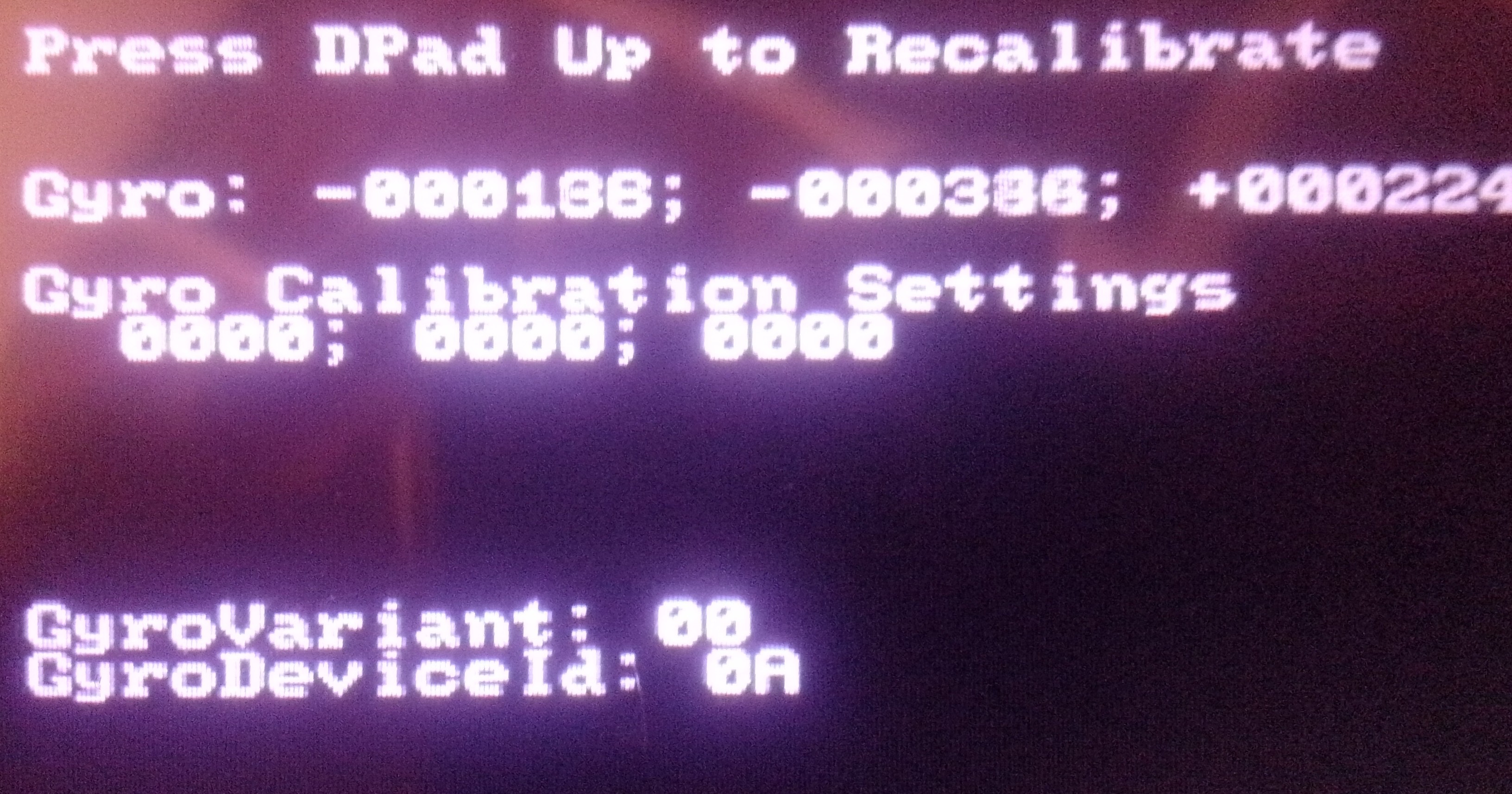

As for the gyroscope business, @emcintosh and @Ninja-Eule can you test this program? It's just a regular NDS application. I doubt this will work, but just as a last attempt of mine.
Start it, wait for ~10 seconds, and tell me what you see at the bottom screen (specifically, there should be something like "gyro variant" and "gyro device id"). Ideally, if the gyroscope would work, on the top screen there are 3 rectangles (reg, blue, green), and if you rapidly rotate the console around one of the three cardinal axis (X, Y, Z), they will expand up and down. You may also press DPad Up for "calibration", but it probably doesn't matter
No response on numbers on the bottom screen or the bars on the top. The first time I ran it, one of the numbers was 97 or 79, but on all subsequent executions, both numbers are 00. There is no save file, so I don't know how to return the NDS file to an unplayed state. Calibration doesn't change any of the 0s.
Thanks. Then it's truly impossible for me. I can hypothesize that even if that linked code above from "rehid" is correct, there is still the problem that your version of TwlBg may not have the gyroscope listed inside the I2C device table (or it's just in a different position). Similar thing is with the CStick, so I have to re-add it in my mods. Except in this case I don't know what and where to do it.
I guess you could try the rehid module just to see if that code works at all. I haven't used it myself, but I suppose after activating it you just need to start any 3DS games that uses a gyroscope and see if it works at all

Hey shoco, I tried this gyro application in my regular Old 3DS and the bars change when I move and rotate the console. Could this mean that gyro may be supported in Metroid Prime Hunters for this version of the console?
I suppose so. According to my data that gyro type should be in O3DSs. You can test it (this is a version of the mod from here)
I just tested it and it works with the latest Luma/TWiLightMenu. Thank you for making these mods possible, they combined with some widescreen cheats feels like playing remastered versions of NDS games!
