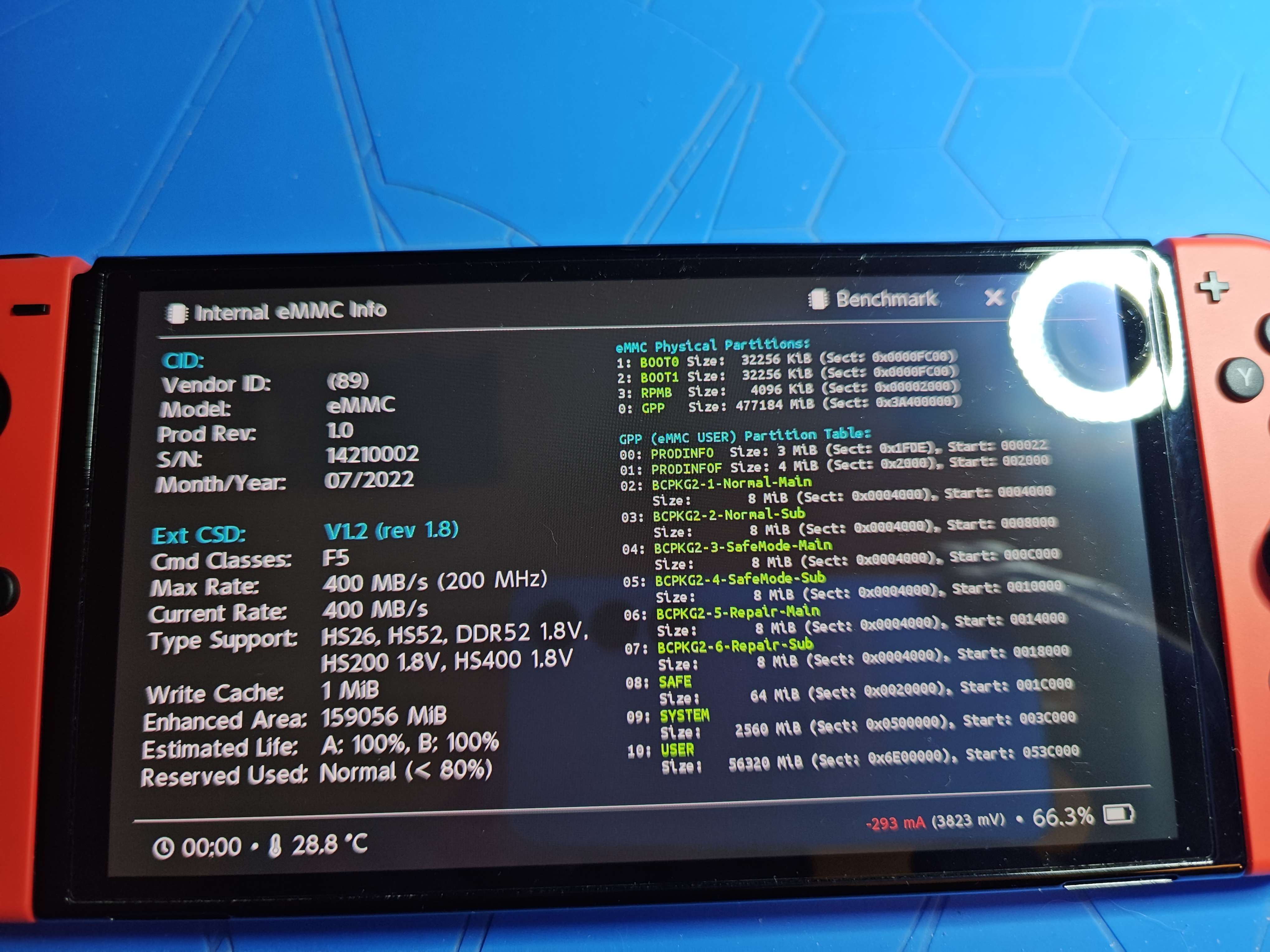

I can confirm SM662PXF-BFST 512Gb is working

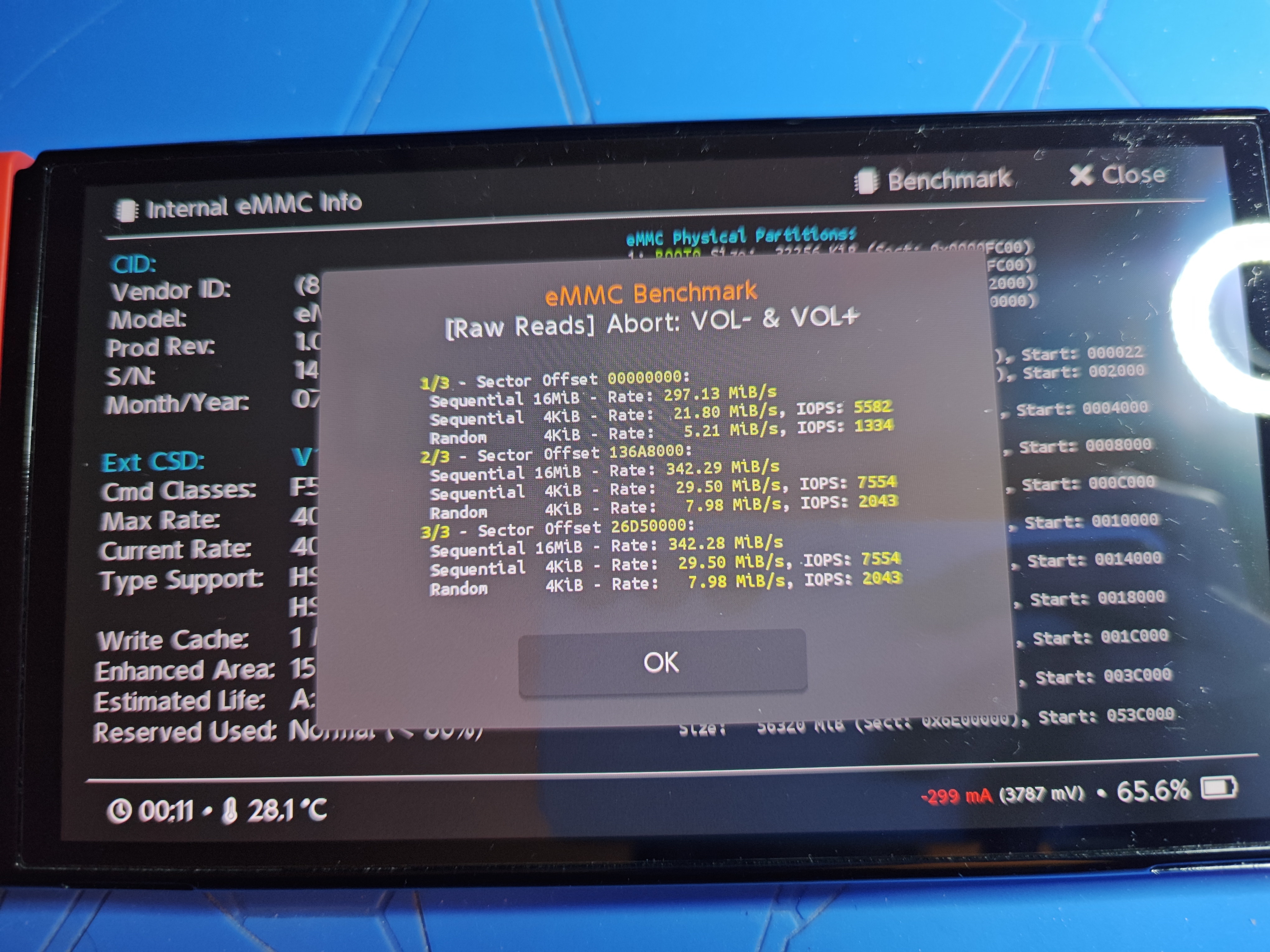

400mbps wtf?
I thought the switch was limited to something like 40 or maximum 50mbps, or that's because the old eMMC, and installing a new one get new speeds ?
This is average speed for switch emmc, samsung may even be faster
