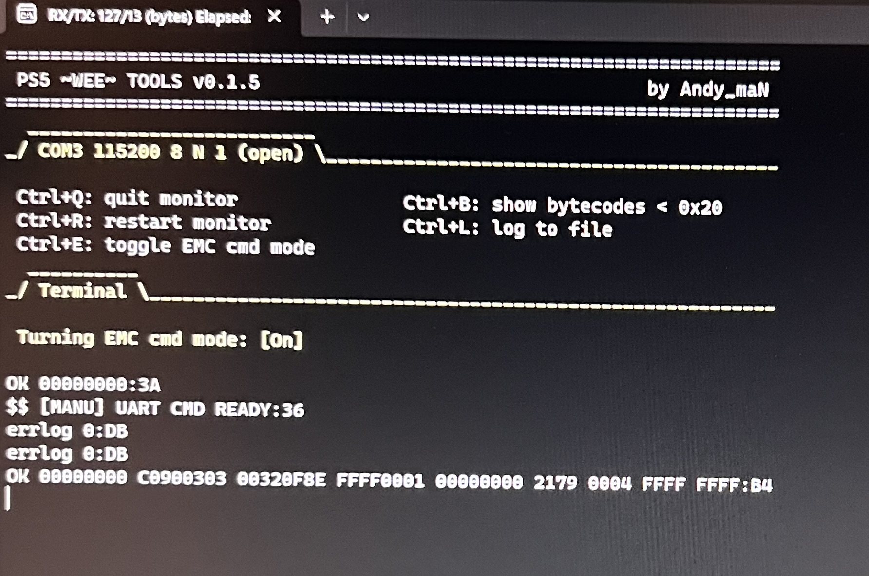

Does anyone know what this error C0900303 means?
