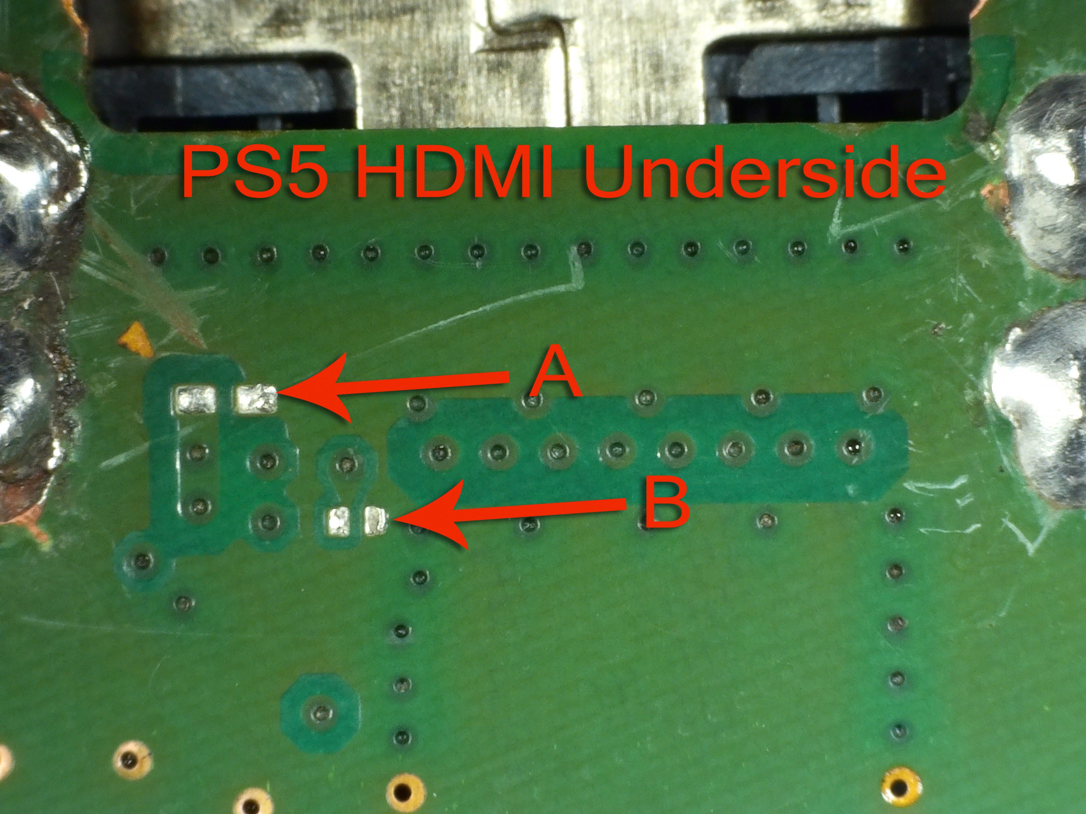

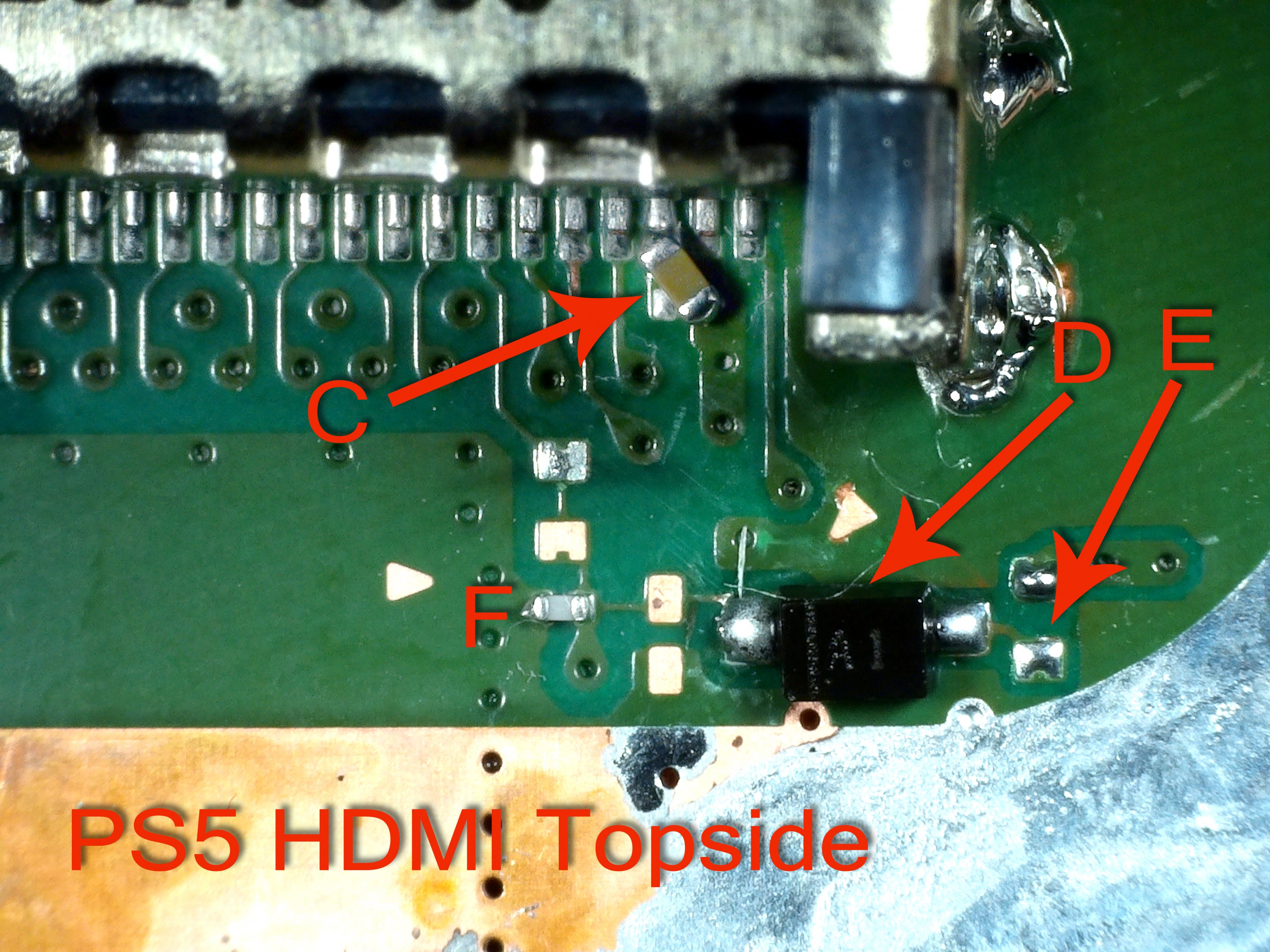

Hi people,
I have a PS5 here, that went through a hell of a repair-attempt from someone watching too much Youtube and never held a soldering iron.
So to make it short, there are components missing....
I not have another board to compare with.
I changed the diode with one from a PS4 board. And I also took a random capacitor and put close to the HDMI-port, after someone in here just said that a PS4 was crowded with 0.1 uF capacitors.
But if we could identify all these, I will make two new photos with the values, so that the community have it for future reference.
F is not missing, but it would be nice to have the value there anyway.
Thanks for all help.
EDIT: Heres a picture of the underside:
The component in white is a mystery. No readings on my multimeter. No continuity. No Ohms. No readings in capacitor-mode (I can not go lower than a few nF) . The component was tested out of circuit. What can it be?

If last PICTURE IS referring A and B . I believe A diode is CDZ 5.6B Rohm zener diode. Then B should be 100nf capacitor
Yes, you are correct about the picture. Probably about the values too :-) Thank you so much. Highly appriciated!

Please fix that picture with the part numbers.
The original pin 13 diode wasn't a DZ2705600L. That was the "DJ" diode. The pin 13 diode was a DA2J101, but Sony is using a combination of "Nexperia BAS 316, 115" (A6 code) and some other general purpose fast-switching diode marked "C1" these days.
It would be great if someone had a part number for the 27kohm resistor too.

27Kohm resistor size is 0402, parts number varies from brands you pick

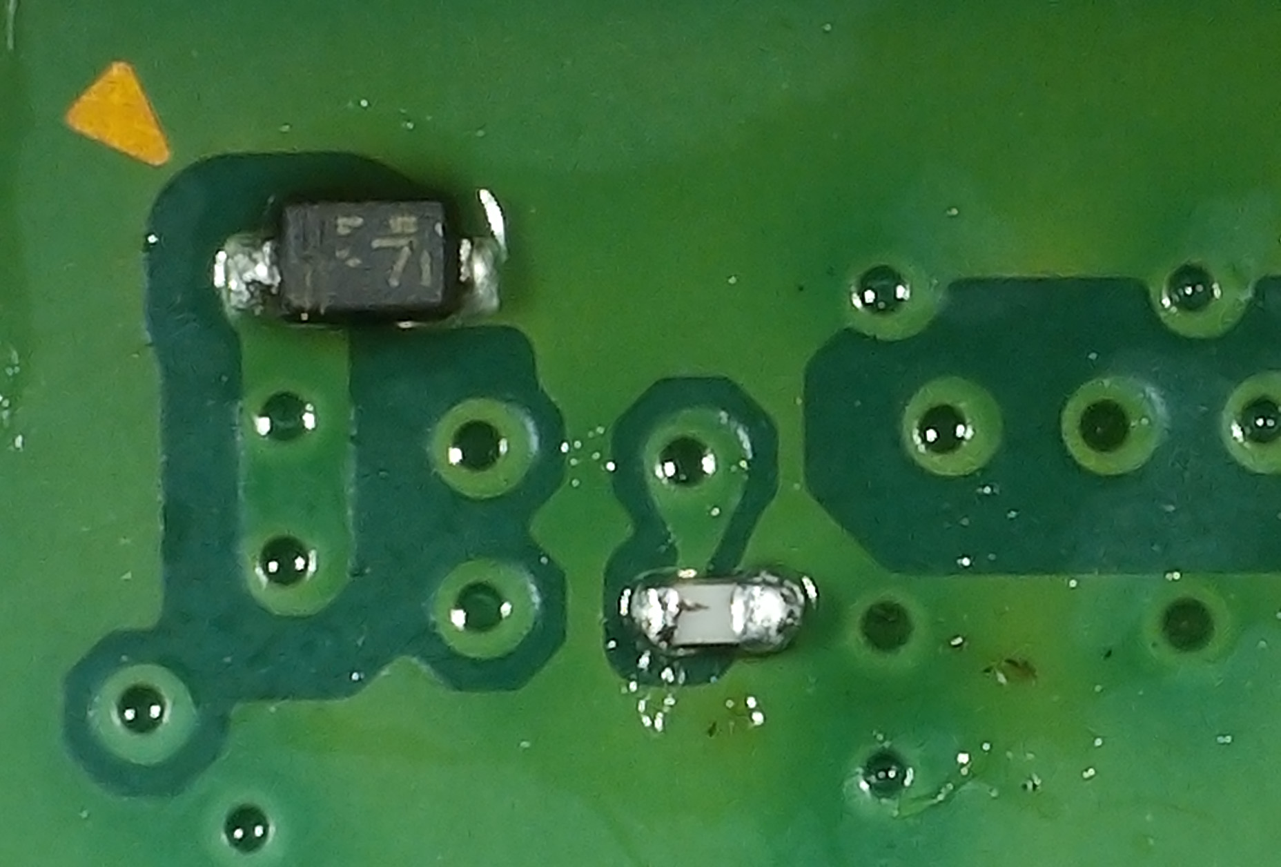

Work with ordinary zener diode.
