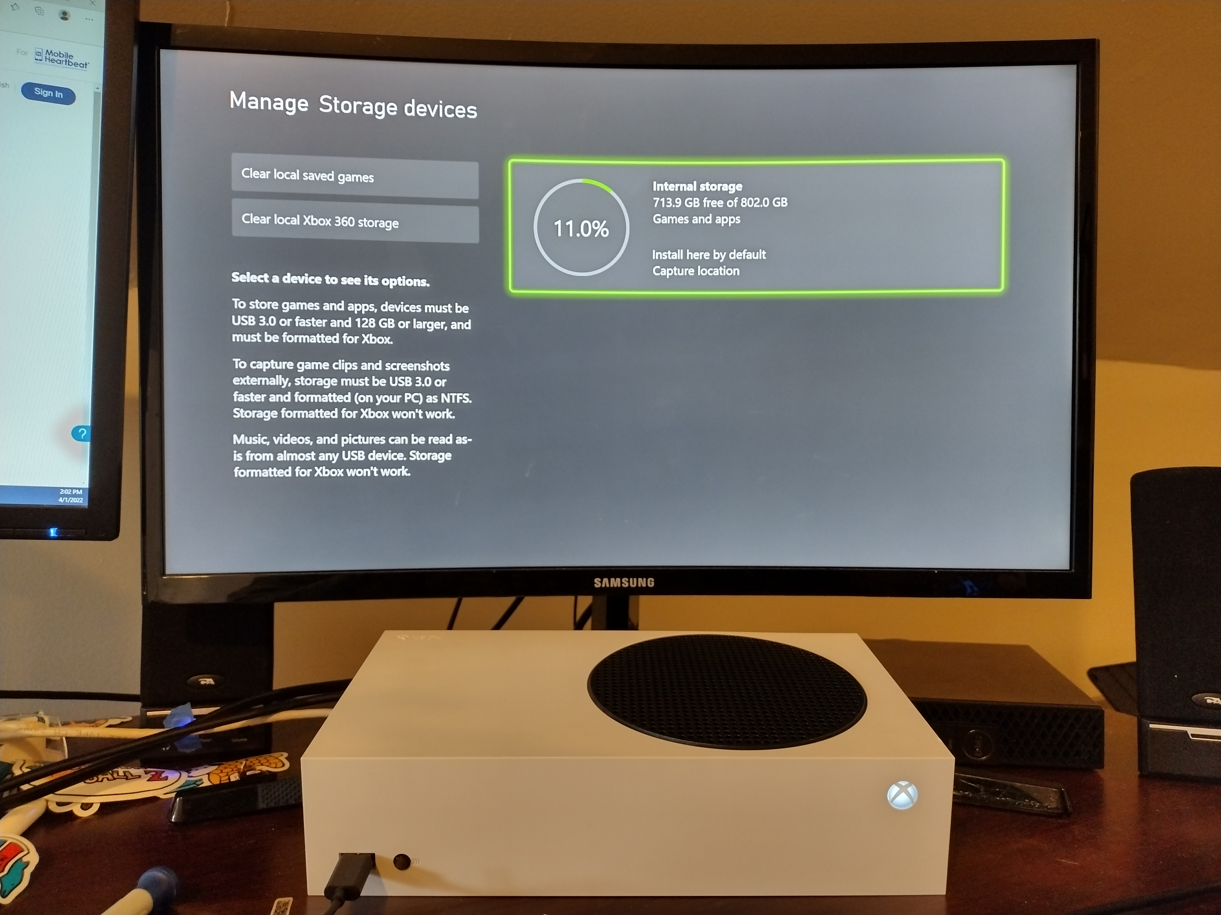

I'm not sure if anyone else has done this yet, but I upgraded the internal SSD for my series S with one from a broken series X I purchased on ebay.
If you want to do this swap, you'll need to clone all of the partitions from the original 512gb ssd to the 1tb ssd with the exception of the user content partition. If you put the ssd in straight from the series x, it won't power on.
Also if you want to use your old 512gb ssd as an expansion card just buy one of the cfexpress to m.2 adapters, delete the partitions from the drive, and you should be good to go.

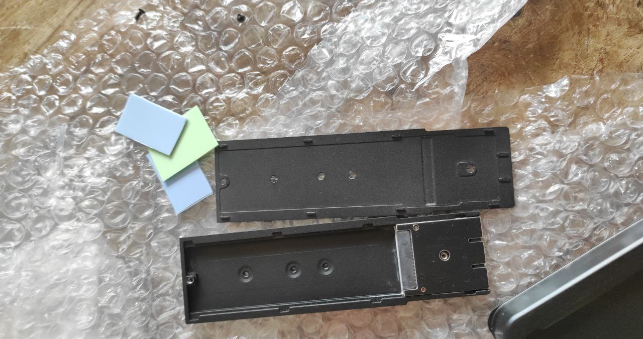

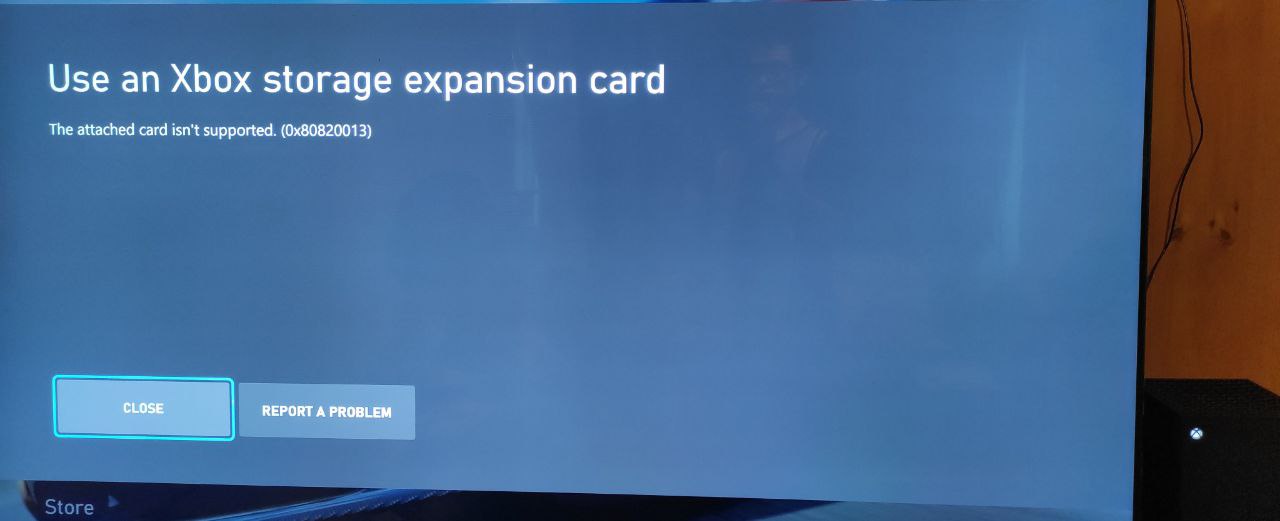

Will solve my issue if I clone my storage expansion card to a standard 2TB SSD to use as a 2TB expansion card with my custom made enclosure?
By the looks of things this error code signifies that the drive inside the enclosure is not supported.
EDIT: Most people recommend the WD Blue CH SN530, as found in the original expansion. The WD Blue PC SN530 will *not* work. If your drive matches that model number, it may need to be formatted to GPT, then connected to the Xbox via USB, formatted as an external, added to the enclosure and formatted again. There seems to be some voodoo involved in the initial installation.
EDIT: By the looks of things most people recommend the WD Blue CH SN530, as found in the original expansion. The WD Blue PC SN530 will *not* work. If your drive matches that model number, it may need to be formatted to GPT, then connected to the Xbox via USB, formatted as an external, added to the enclosure and formatted again. There seems to be some voodoo involved in the initial installation.
It doesn't
work, it seems microsoft software locked the console so to recognize only the internal ssd model, SN530 and the expansion card from Seagate.
I've tried to clone the expansion card to my brand new 2280 SSD from PNY but the console still blocks the use.
Formatting MBR or GBT also didn't work.

This has been the case from Day 1, only select drives are supported, it’s dependent on the on-board controller.

Just wanted to pop in and say the XA1-31512 I’ve been able to find cheaper than the WD drive and also works as an expansion.

Does this still work? Can you provide a step by step on how to accomplish this?
G33ksquad
Nov 18, 2012
224
31
1,246
Still works, you need a drive with the correct chip, Phison E19 and it’s not a chip available on consumer drives so that’s why it easiest from a dead console,
1.) mount it on a windows machine
2.) use disk part to change to GPT
3.) format as NTFS sector size 4096
4.) stick back in your Xbox, should now be asked to format as a new expansion you’ll need an adapter for this I bought the cablecc one from Amazon they work great, bad reviews primarily from an incorrect drive being used
Let me know if you run into issues I can try to help troubleshoot.
