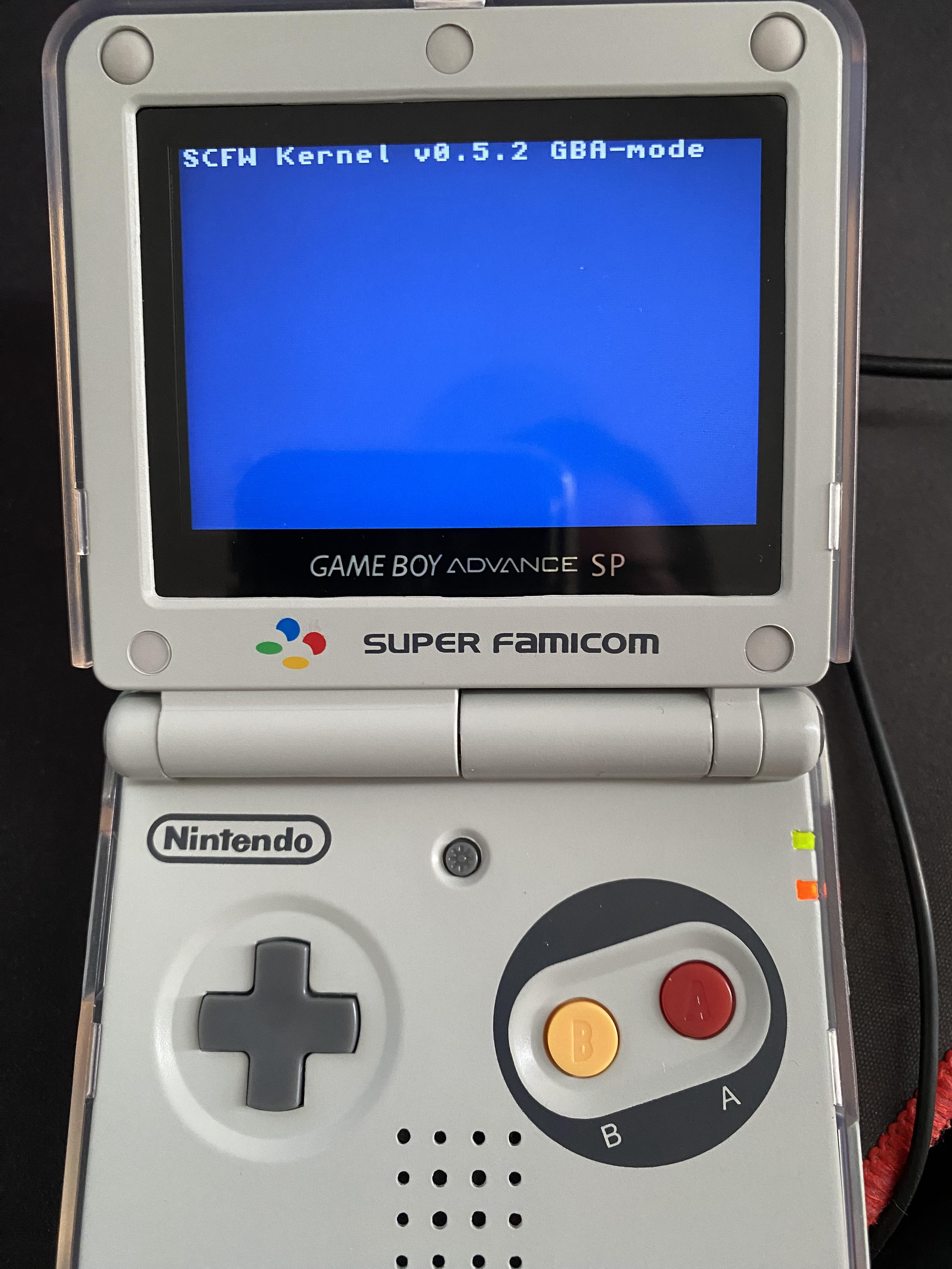

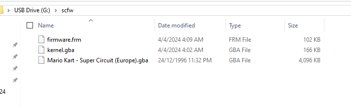

Hello,
I downloaded the latest version of the scfw and copied it at the root of my sd card (screen_1). When I launch, it's stuck on this blue screen (screen_2) and nothing happens.
Anything I am doing wrong?
Thanks
