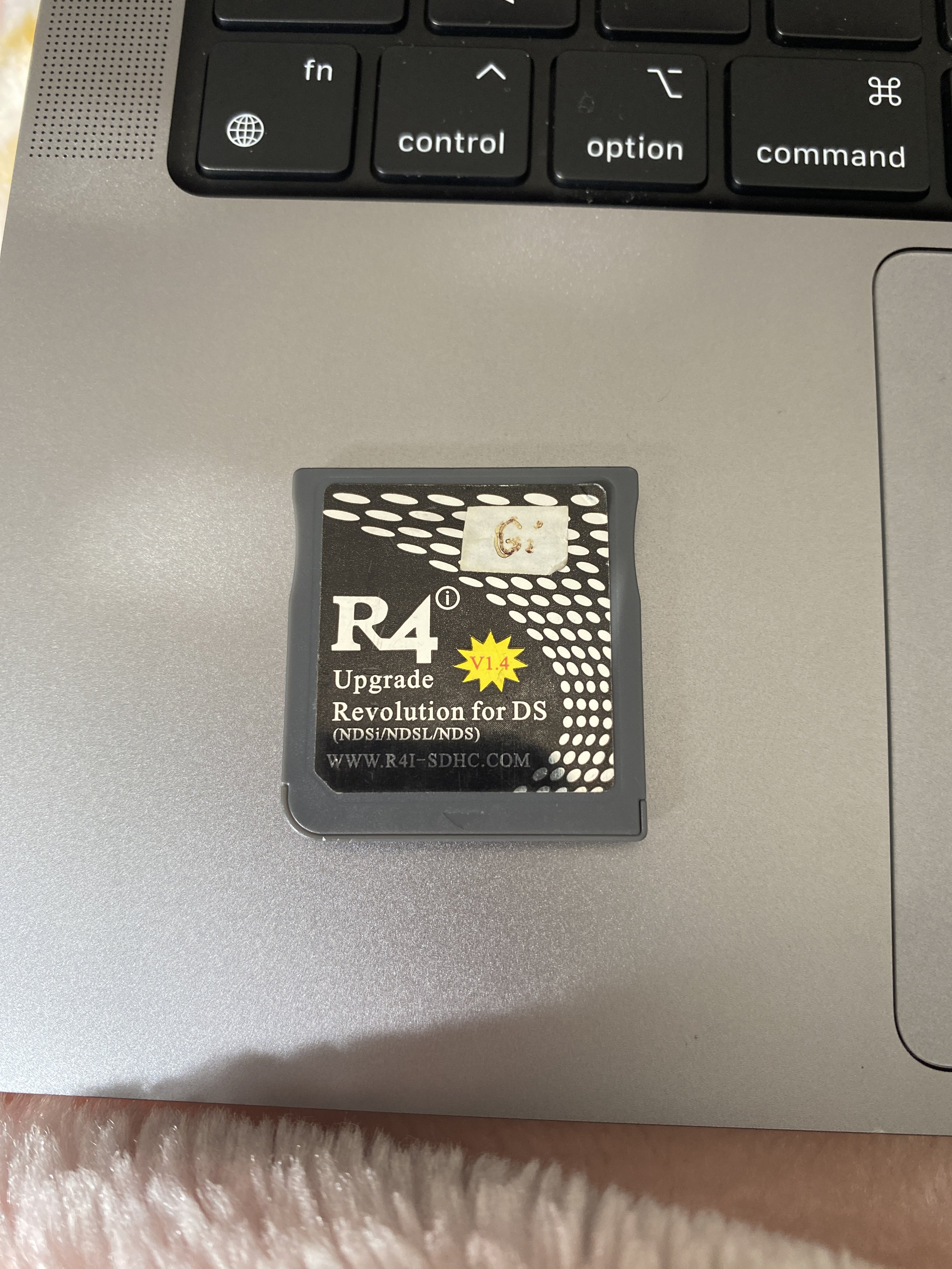

Hello im looking for a firmware for this R4 with behind writted "R4i-SDHC 5" (red pcb btw)
I've tried the v.1.85b French version and it didnt worked
I have also formatted the sd card with a mac on FAT.

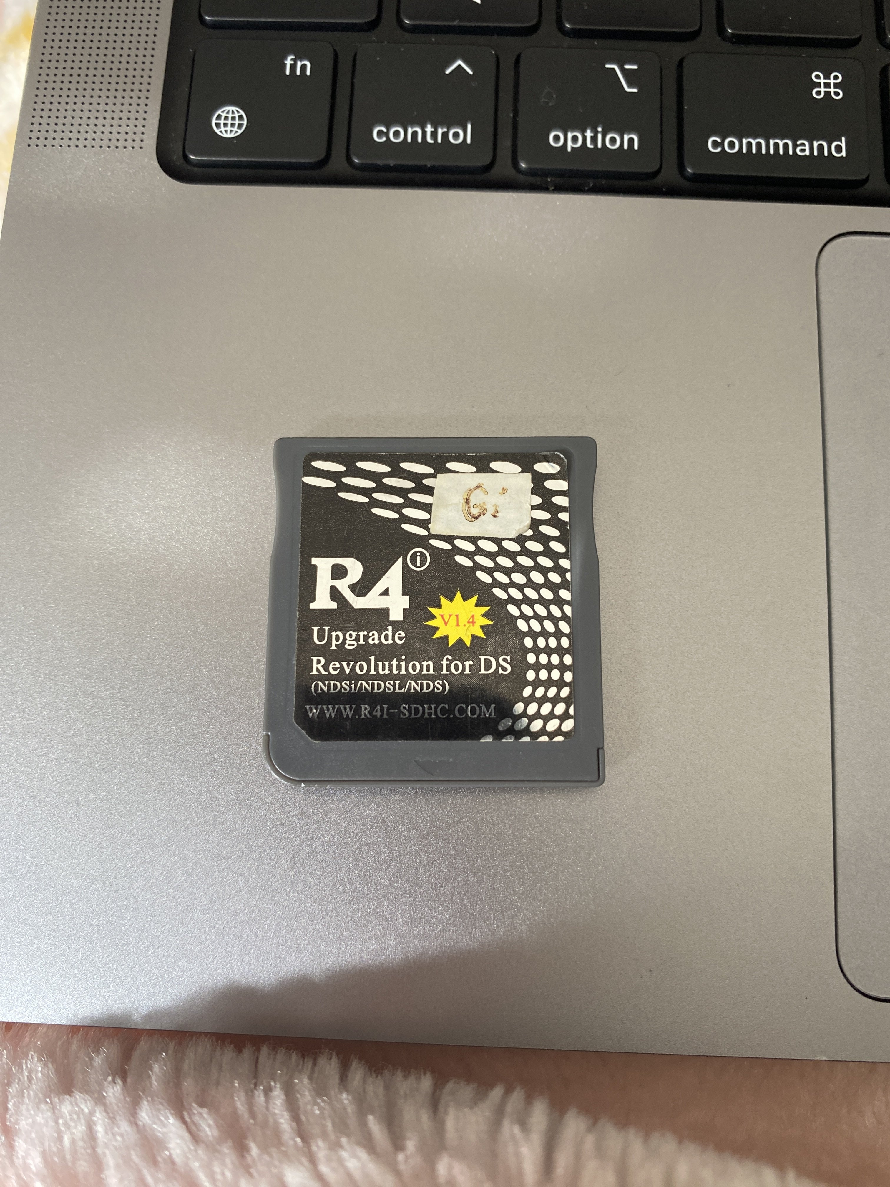

Hello, got this card, and tried the official kernel but screen is stuck on loading. Any suggestion? on what kernel should be used?
