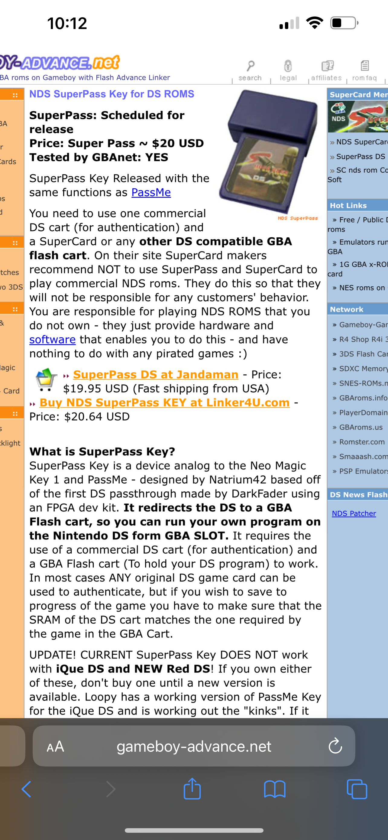

Flashme was originally when gba flashcarts were being used to play ds games. You needed what was called a passme device like nopassme or superpass which went into the ds cart slot and would make the ds read from the gba slot in ds mode. I think on The original superpass u had to also put a ds game into that and have it match the save size of the game u we’re trying to play off slot 2 flash cart to have its save file save to. It’s been a long time since so I dont remember too clearly, but flashme cfw was made to eliminate the need for the passme devices when gba flashcarts were all that were out to play ds games off of. After slot 1 ds flashcarts were made flashme kind of came obsolete, but it was kind of exciting flashing flashme onto your ds because you had to run the flashme rom and short out your ds to get it to install and had to hold the screw driver shorting it til progress reached 100%. You also had to make sure not to touch the sides in the tiny hole u stuck screw driver in or you could brick ur ds. You would take off the battery cover and there was an hole there to stick tiny screwdriver down to short out which made it tough to see the screen and hold it still so a mirror came in handy to see completion percentage. Often would use a tiny screwdriver and tape around the sides of it and just have a tiny part of the tip exposed. Most of the firmware you are seeing is like others have said and is for the actual flashcart and not the ds itself unless it is the 3ds being spoken of. Below is a pic of original superpass I just googled a took pic since don’t have mine around me to show
