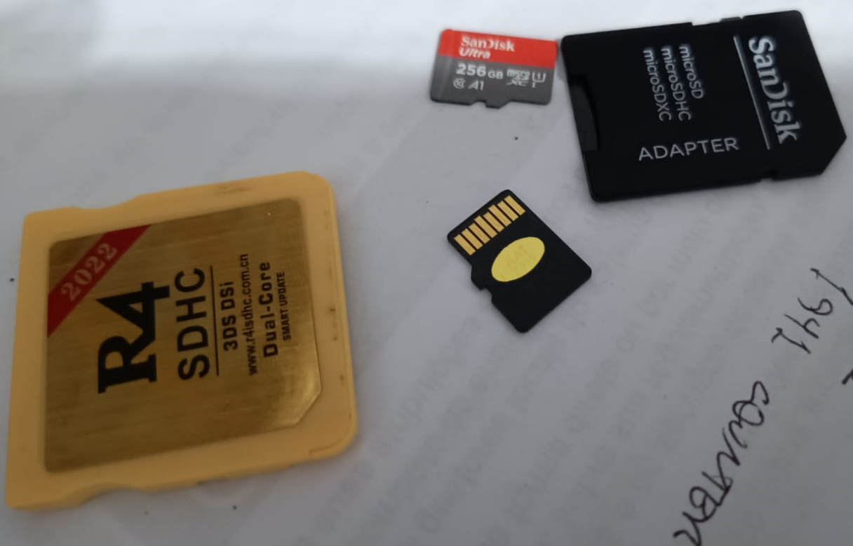

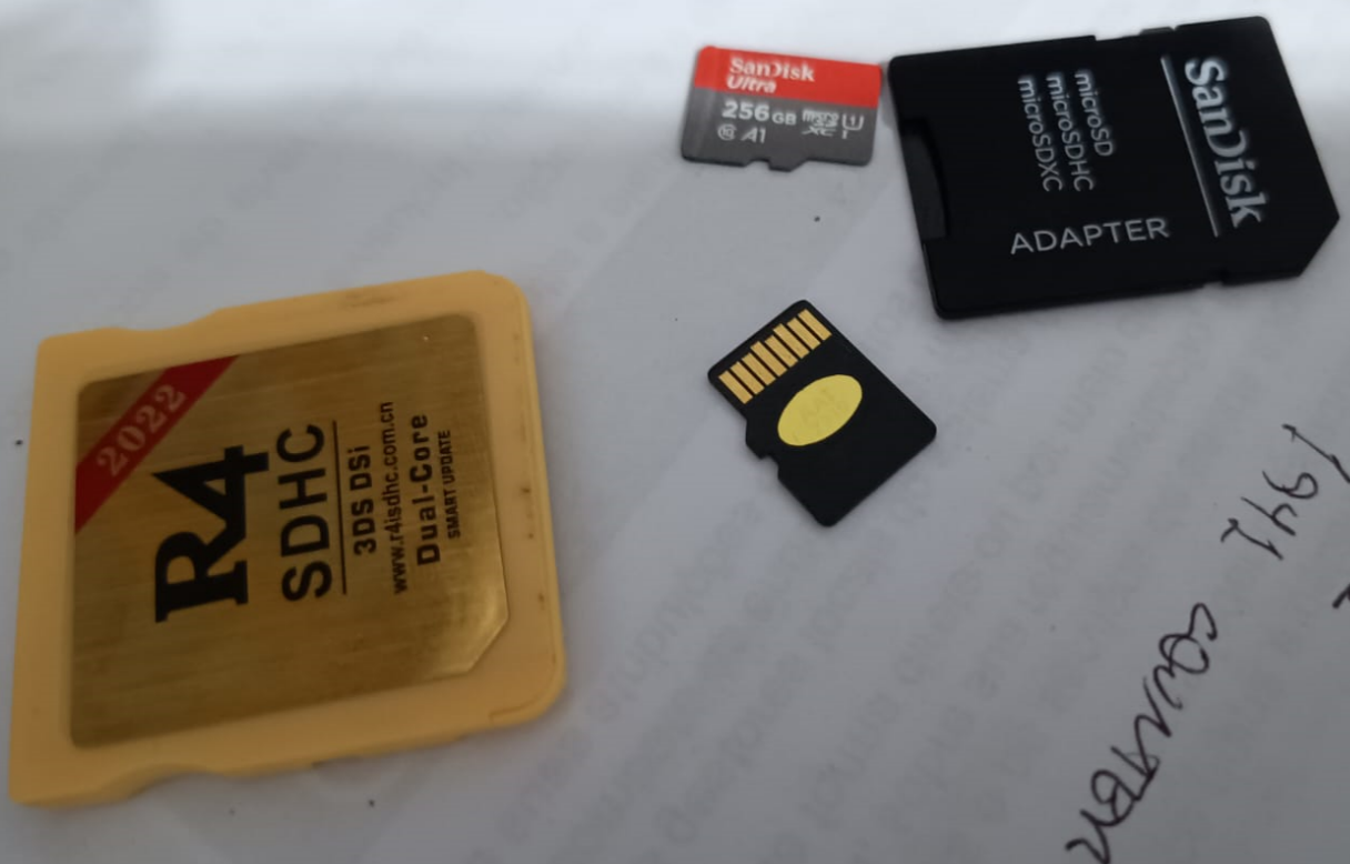

So, I was playing my DSi until yesterday, all good with Castlevania DoS. Suddenly, the game's sound just went off. And to add to the fun, the touchscreen stopped working too. But weirdly enough, the game itself was running fine. I figured it might be a hardware failure, but when I switched back to the original dsi menu (without r4 inserted) and tried to mess around, everything worked like a charm - sound and touchscreen both.
I brainstormed a bit more and came up with a few possible culprits:
  1. Kernel
  2. ROM
  3. SD card
  4. R4 hardware
I tried all sorts of fixes but one:
- swapped SD cards, ROMs, and kernels, but couldn't test another R4 cartridge 'cause I don't have one lying around. I even tried other games. Here's the kicker: when I play the game through the R4, the sound kicks in at first, but the moment I tap the touchscreen, the sound goes silent and the touchscreen stops working. Strange, right? The game runs smoothly on the Twilight Menu, with both sound and touchscreen working fine. And back on the original menu, it's all good too.
I'm stumped, to be honest. I prefer using the R4 over the Twilight Menu (with the proper respect for nds bootstrap), and I'm worried if I buy another R4, I'll run into the same issue. I've been using this same sd/r4 for about 2 years without any problems. Any suggestions?
