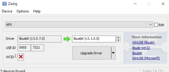

I am now in a tutorial where I have to use memloaderv3, I dropped the files to my Switch, started the payload and selected “ums_boot0.ini” but BalenaEtcher doesn’t show my Switch.
Should I have to install any drivers?
switchModBrick
May 23, 2021
93
22
217
Germany
That's the one I posted.
I switched the system into RCM-Mode and installed the driver with Zadig like this.
I started MemLoader and selected BOOT0.
Now BaleaEtcher doesn’t show me the Switch but if I connect and disconnect the Console, Windows brings now the typical USB-connect/disconnect sound. It seems like Windows notice a device but not BalenaEtcher.
What die I wrong, the picture shows which driver I installed?
Is it may the wrong diver?
