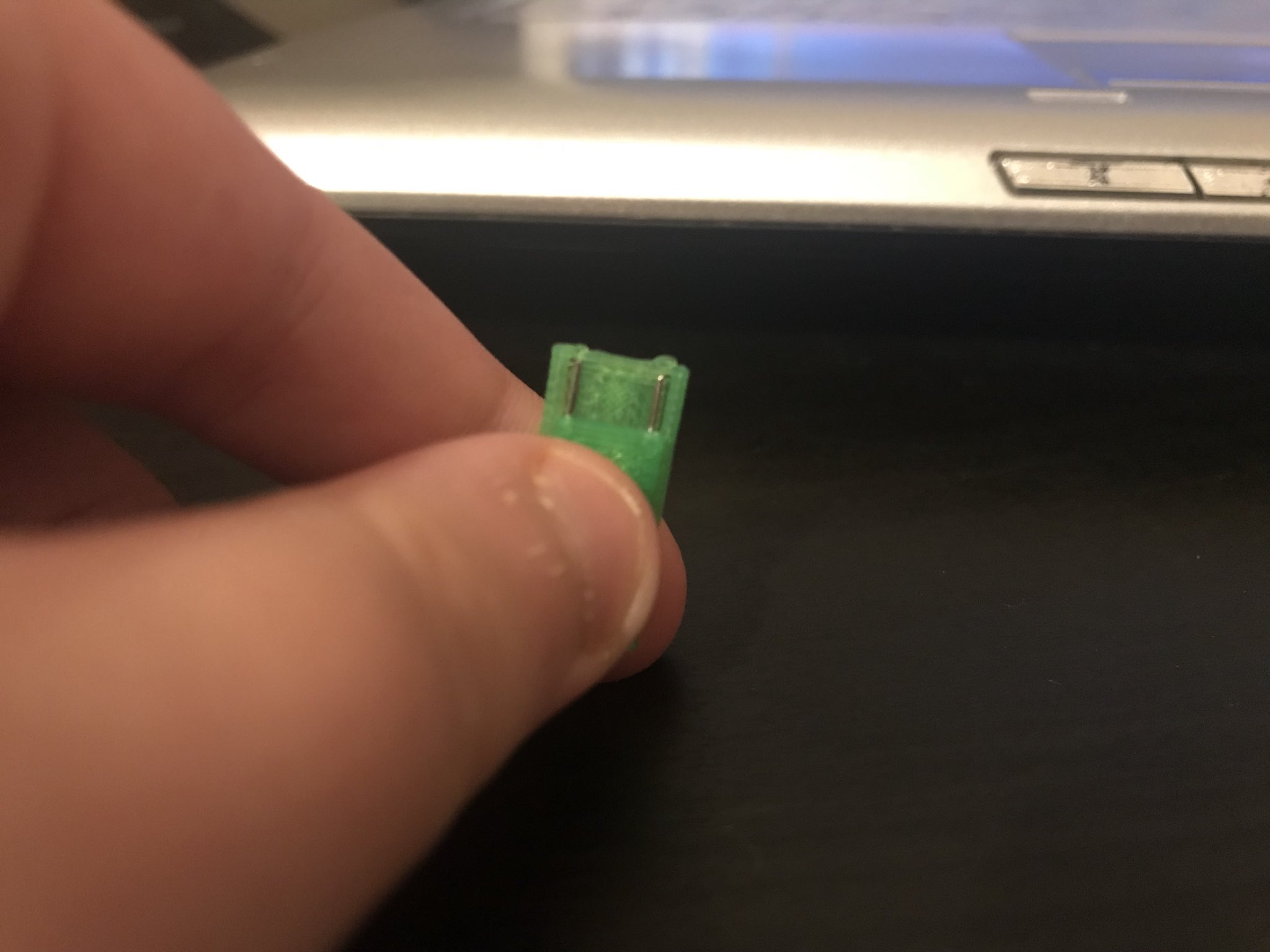

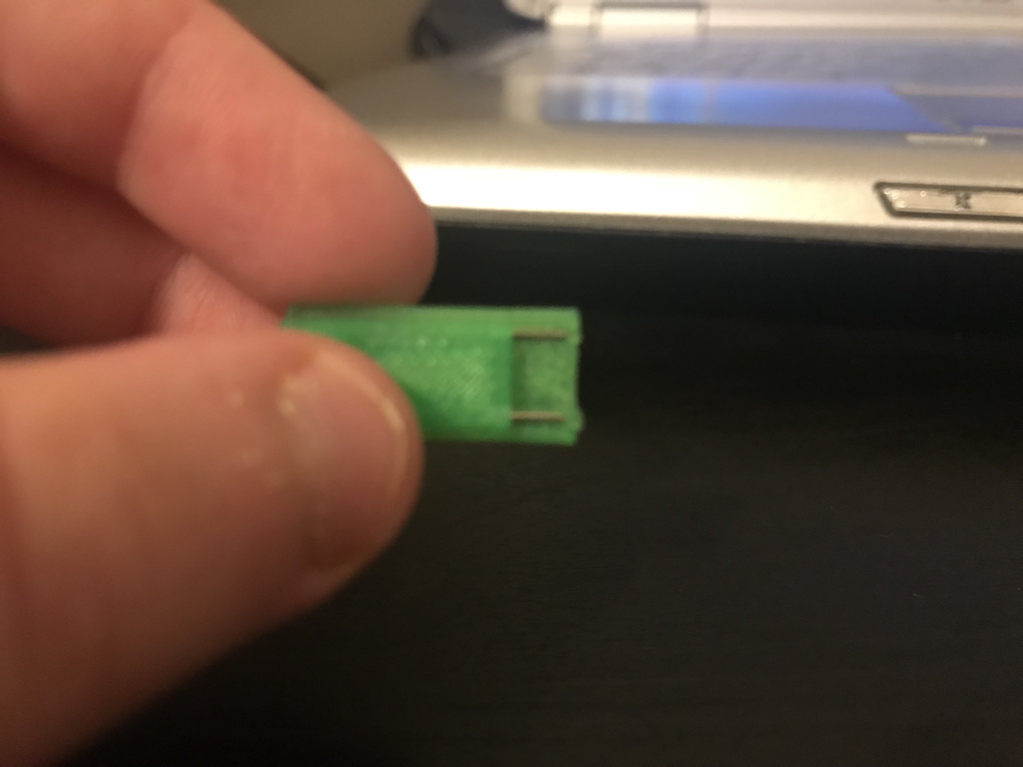

Stop confusing the issue. The problem is most likely that the OP's jig is not grounding pin 10. The OP is doing the button combo fine. It's not difficult to hold vol + when powering on.

A slight arc upward might be required like mine.

Also, it looks like the paperclip ends of the jig need to be bent slightly outwards. It looks like it might be touch pins 9 and 2.

That's a shit jig. It just uses a paper clip. The clip is totally flat. It should slightly arc up like mine. You could try adjusting or use a wire to ground pin 10 to the middle screw of the joy con rail.
It arcing up or not isn't really important both the sx pro jig and another premade jig, and one I made myself aren't arched up but still work ..
That on the other hand is valid concern. Wasn't sure if its just the resolution that made it seem slightly off place
