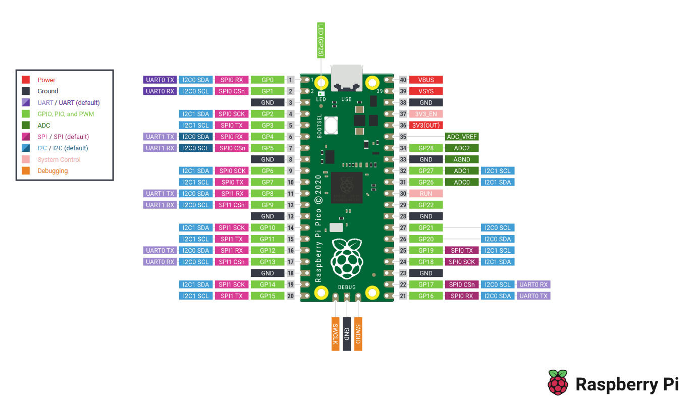

Pico
- Download the latest
udpih.uf2
from the releases page. - Hold down the
BOOTSEL
button on the board and connect the Pico to your PC.
Your PC will detect the Pi as a storage device. - Copy the
.uf2
file to the Pico. It will disconnect after a few seconds.

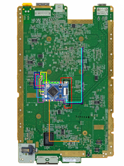

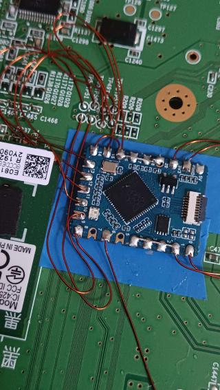

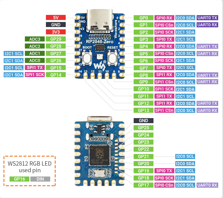

Raspberry Pi Zero (Linux)
- Install the required dependencies:
Bash:sudo apt install build-essential raspberrypi-kernel-headers
- Clone the repo:
Bash:
git clone https://github.com/GaryOderNichts/udpih.git cd udpih
- Download the latest arm_kernel.bin.h from the releases page and copy it to the arm_kernel directory.
- Now build the kernel module:
Bash:
cd linux make
- You can now run
sudo insmod udpih.ko
to insert the kernel module into the kernel.
Note that you'll need to insert the module again after rebooting the Zero. You will need 2 USB cables, one for powering the Zero and one which can be connected to the Wii U.
Continue with "Booting the recovery_menu" below.
