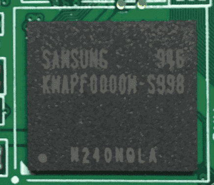

Console ID: 08201....1XX
NAND chip is
SAMSUNG 946 KMAPF0000M-S998
bc00000000034d303046504100001500
PM me if you want the nand dump
Reactions: Antonio2311
