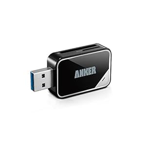

There are only certain SD card readers confirmed working with this mod for 3DS XL:
Anker® USB 3.0 (68UNMCRD-B2U) : Realtek RTS5306
TekRepublic TUC-300 : Realtek RTS5307
SanDisk SDDR-121-A11M : GL827
Transcend P8 TS-RDP8K : ALCOR AU6476 (Thank you Gamerquest1 and zchtoy)
Anker® USB 3.0 4-Slot Card Reader (A7612) : RT5301 (Ava)
(The "Anker" readers have been highly tested by me and others who have performed a hardmod. They are confirmed to work with the Old 3DS. Therefore, the "Anker" readers are best recommended to work with this hardmod)

I have an O3DS harmoded, a valid dump file and Anker sc card reader.
http://ecx.images-amazon.com/images/I/31FMUMJMfnL._SY300_.jpg
I plug my sd adapter into the sd reader and I boot the 3ds : the blue screen appear.
When i plug the sd reader to my PC, win32diskimager doesn't recognize it. So writting nand can't be made.
I try on diferent PC, but it the same thing.
