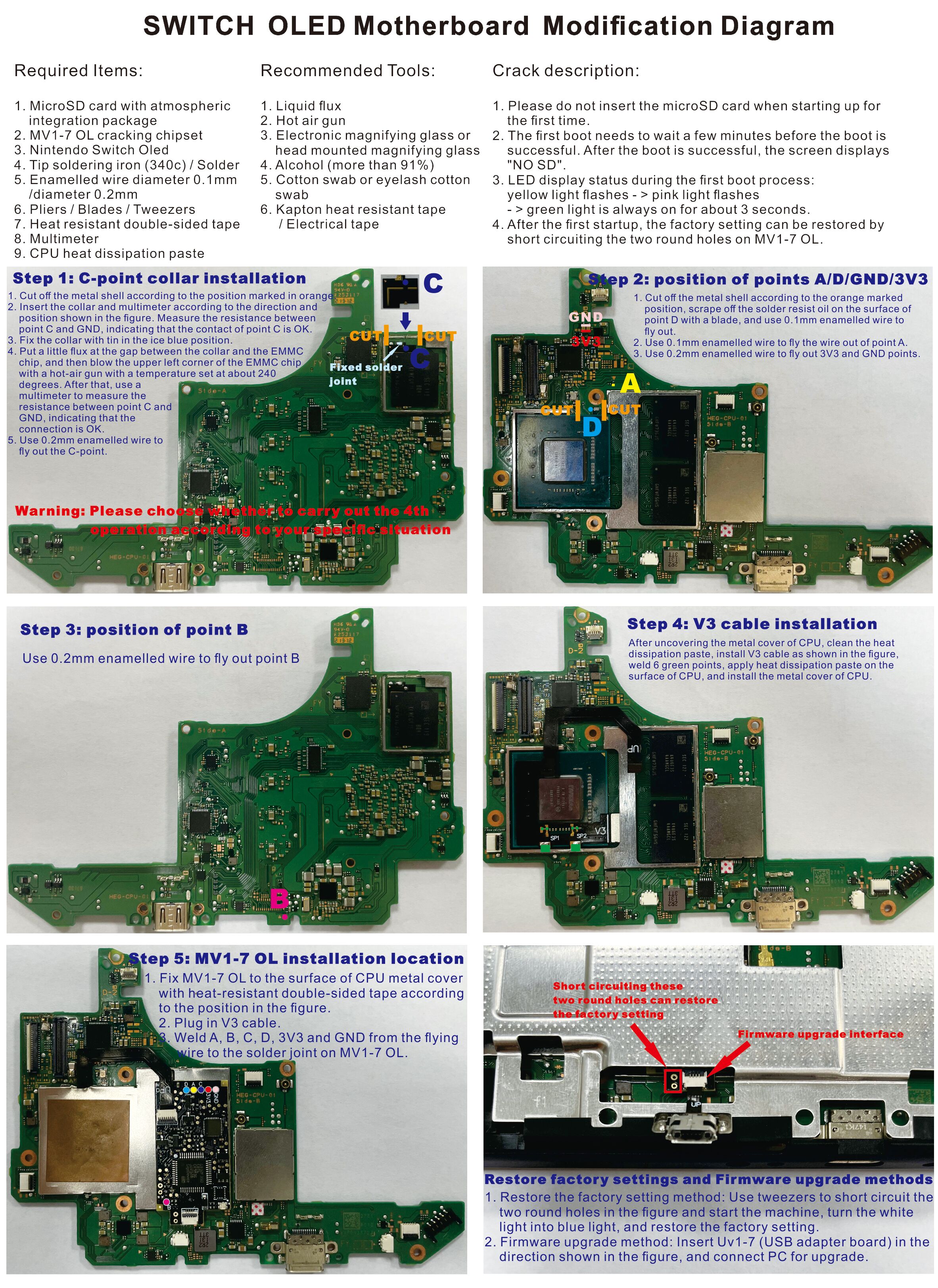

https://www.aliexpress.com/item/1005003698689759.html?spm=a2g0o.9042311.0.0.27424c4d1b7RBt
Price has gone up another $10 since I ordered it. I paid $110 and it's now showing $120. I asked a bunch of questions, and the seller said they would have to "talk to the factory", then replied later that it has v0.2.0 flashed to it already. After a few more questions, they sent me an instruction page that someone else already posted here in a different thread. But I guess it won't hurt to post here (the part on the bottom right corner is what gets me excited... although with some of the resent replies to this thread, I'm now worried if the v.0.2.0 that's on it is modified or not, and if flashing a later version direct from the github page will work or not... or brick it...)...

What is factory settings?

Not sure what you're asking. My guess is that it wipes out both the firmware, and the bootloader, which kicks it into DFU mode (so that you can flash an update). But that's just a hopeful guess... I don't have the chip yet.
I though about something completely different by "factory reset".
Maybe the trained data or glitch timings, assuming this chip has this feature.
Anyway, I'm buying one now, for science, of course!
The "glitch settings" are stored in the MCU, there is no training though sadly as they have crippled the MCU memory area so it is read only so can't store the timings. Flashing the GD32 MCU won't affect that side of things but installing an unlocked MCU will, but apparently once flashed glitching can stop working, can't experiment though sadly with that until my replacement GD32 chips arrive and I can replace this locked out chip with one that is not crippled.

Yes that is how the chip works, already had to do it. Chip works very well now
You got yours already from the same seller (or at least with that same installation instruction)? Which software is used to flash it (link please)? The page doesn't really specify, only that you turn it on with the 2 points shorted...
