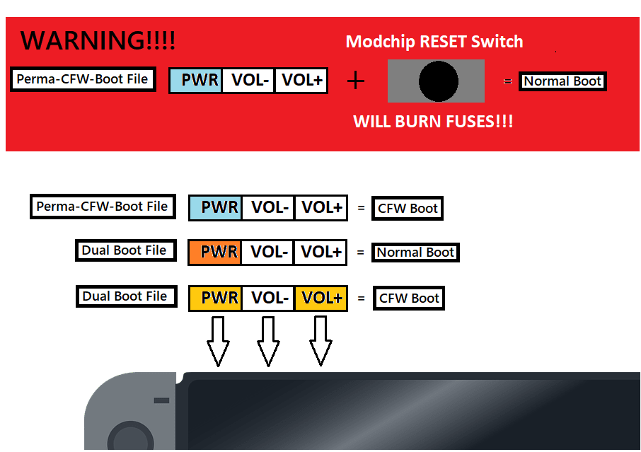

    Can anybody explain the difference between "Dual-boot" and "Perma autoRCM" ?
    I'm trying to understand the boot process (with the trinket m0) and how I can easily switch between stock (sysnand?) and cfw (emunand?)
  13. Hologram
    Hologram GBAtemp Fan
    Joined:
    Nov 27, 2020
    Messages:
    333
    Country:
    Dual boot lets you pick what you want to load first - Original or CFW and you can switch between sides. Mainly used to go online on Original and or not get your CFW switch banned. Perm loads CFW SYS aka Single boot.
    You can also use the dual boot files and setup single boot CFW SYSnand then have it auto load CFW on boot. AutoRCM is best off and not needed anymore if you have the 6 wires soldered.

    If you use a permanent boot file then you just press power and it boots into the payload on the chip, if you have autoboot setup it boot into that payload. With dual boot you have to press power and volume up to boot into the payload on the chip and CFW boot if you have an autoboot setup, when you press power without vol+ it normal boot.

    Thanks so much! Let me see if I understand: (assuming all wires are soldered which mine are)
    Dual-boot mode:
    1) Power button = Sysnand/Stock os.
    2) Power button and Vol+ = Boot payload.bin
    (This can be changed by flashing different UF2 files to boot CFW by default and Vol+ would boot stock?)
    Perma autoRCM = Always boot payload.bin.
    (This is not preferred if Vol+ strap is wired? ...because dual-boot provides more functionality by holding buttons)
    Do I understand that correctly?

    If you want it to reverse it you have to recompile the UF2, by default when mattytrog was around he had it set up as that. Alternative if your sysnand is clean you could just load up hekate and boot into stock (sysnand).

    You can reverse if using fusee uf2
    Power switch on to hekate or fusee or home menu. Hold vol+ solid red light then flashing red light (on trinket) then release vol+. Hope this is what you were talking about.

    That switches from dual-boot to perma autoRCM, right?
    If you're using permanent autoRCM then you can't hold Vol+ (or anything) to boot into stock then I don't think?
    Also, how do you boot into stock (sysnand) from Hekate?

    since the function of the 1) Power button = Sysnand/Stock os. and 2) Power button and Vol+ = Boot uf2, I thought you have to recompile the uf2 to reverse what pressing the power button and pressing the power button and vol+ does. He is asking to reverse the role of the button presses.
