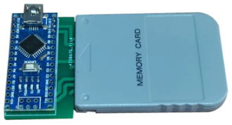

The purpose of this tutorial is to convert saves from a physical PS1 Memory Card to virtual PSP Saved Data, using a Windows PC, without PS3 Memory Card Adapter, DexDrive, PicoMemcard, MemCARDuino, or CWCheat.
