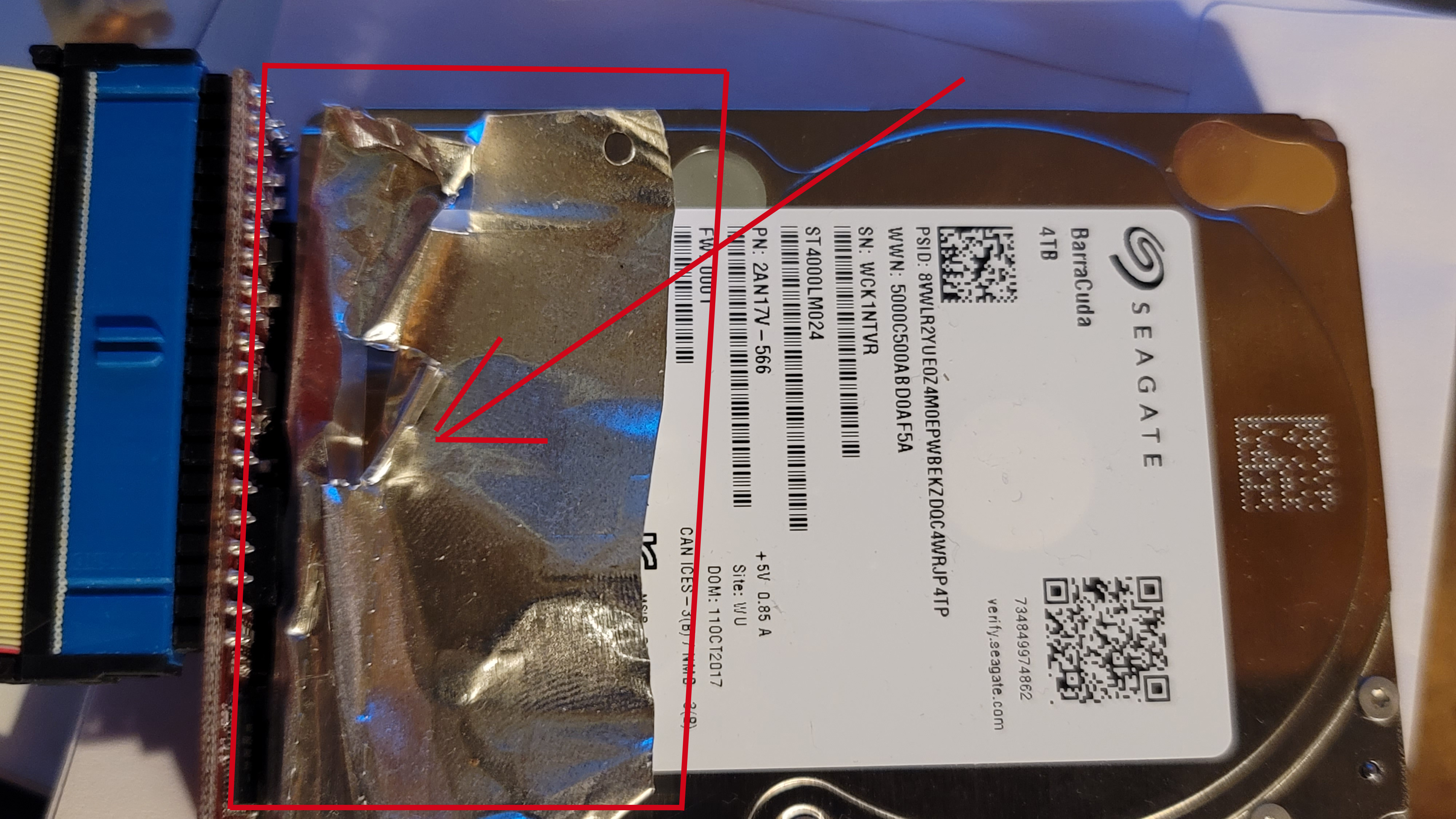

Clock capacitor removed
Tsop
128MB ram upgrade
Xecuter 2.3B Pro with header installed for testing Titan & Cerbios
GPU/CPU cleaned and new thermal
4TB Seagate pulled from a one touch usb caddy
Thinking about:
Logitech wireless controller with internal mod
Make MHz Hdmi/XboxHD+
1.4 CPU Upgrade
Brook Wingman XB to use controllers from other systems
  • Love
Reactions: Alexander1970
Tsop
128MB ram upgrade
Thinking about:
1.4 CPU Upgrade
Brook Wingman XB to use controllerss from other systems
Awesome,great Work,my Friend !!! 💖👌
May I ask please,what for this "Cover" is please ?
Thank you.😊
Reactions: Donnie-Burger
